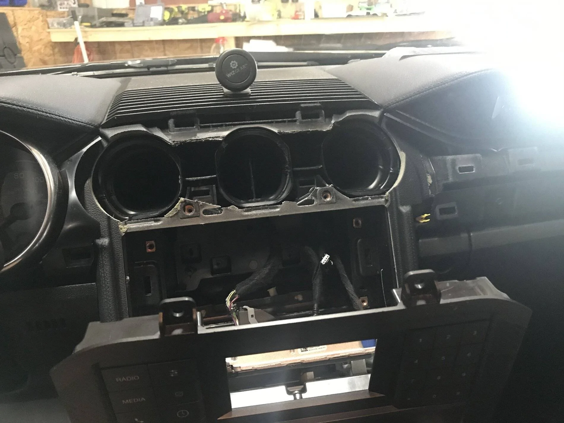

On A 2016 Gt premium non performance pack the wiring for the gauges is already in place. Its behind the radio look for a small square hole and you should see one or two pins through the hole. Simply push this pin backwards untill its comes loose and then fish it up into place. This is a factory connector for the gauges and by default if its a not Pp car its placed there.
I found this in a youtube video. By keith stilson
Under the comments section
I can confirm this works on a GT premium non performance pack
After plugging in the gauges and getting your tune updated it will show proper oil pressure.
In my case i use Lund.
There is no other wiring involved or splicing. Just plug the connector in and trim your vents to fit.
The oil pressure switch is already present on the 2016 cars and does not need any additinal wiring just the updated tune and mycolor works properly as well.

Just installed the PP gauges in my 2018 base gt. I had the plug behind the Sync module from the factory. Just plugged it in and both gauges seem to be working but not sure how to tell if my Oil pressure is reading accurate.

Just for the people wondering, it is plug and play with no tune required on the 2018 401 GTs. Just got mine hooked up today, and oil pressure and vacuum work correctly. To verify, I put the oil pressure and vac on my gauge cluster and went for a drive, and they seemed to be in the same positions at the same time as the physical gauges

I have a 2019 gt and I had to cut out a chunk
But that was what I had to do
