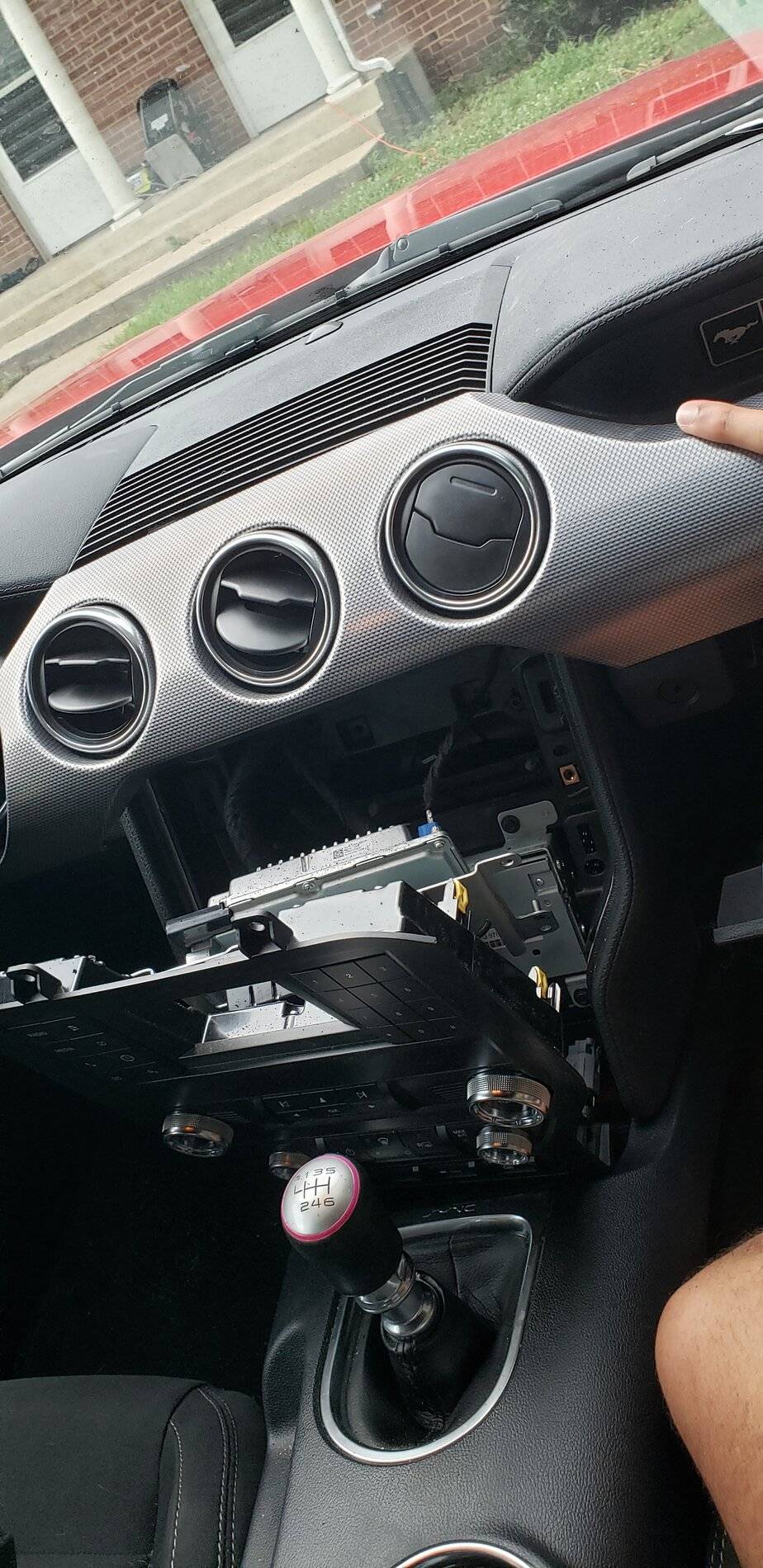

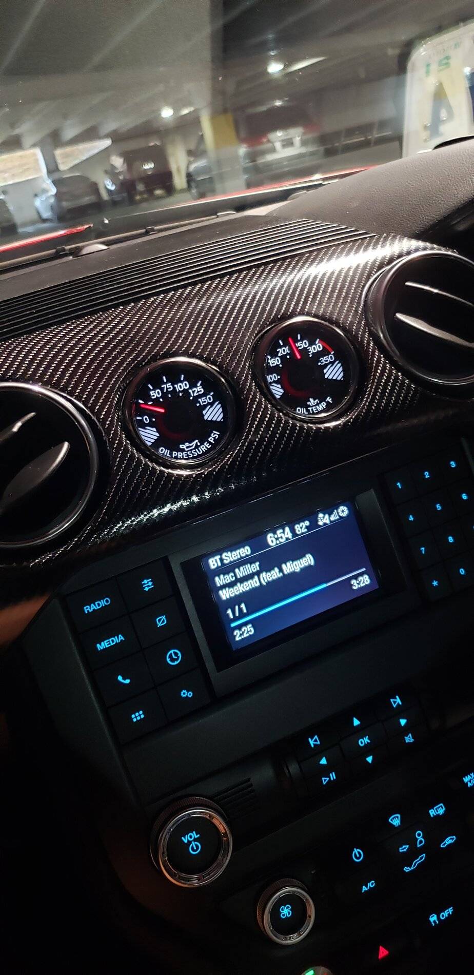

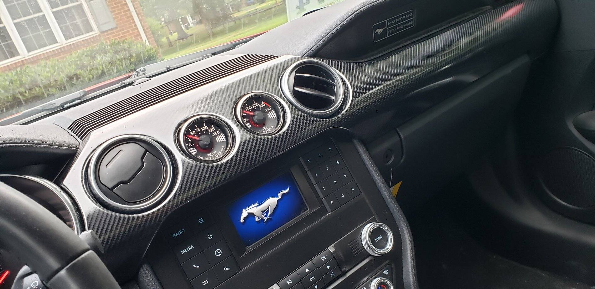

Got my guages all in. Plug and play, although slightly annoying getting the harness from behind radio. Base 2020 GT
congrats - looks amazing

Can you share your source for the panel and the gauges themselves? Did you bother with the matching piece near your left knee?

I actually bought them off another member on this forum who lived nearby. They had a patterned aluminum finish, but I wrapped it in the most realistic looking carbon fiber wrap I could find. Its temporary until I can get some recaros reskinned with white leather, then im gonna wrap the dash in a matte white with some custom red mustang lettering like the new ford bronco white interior.
