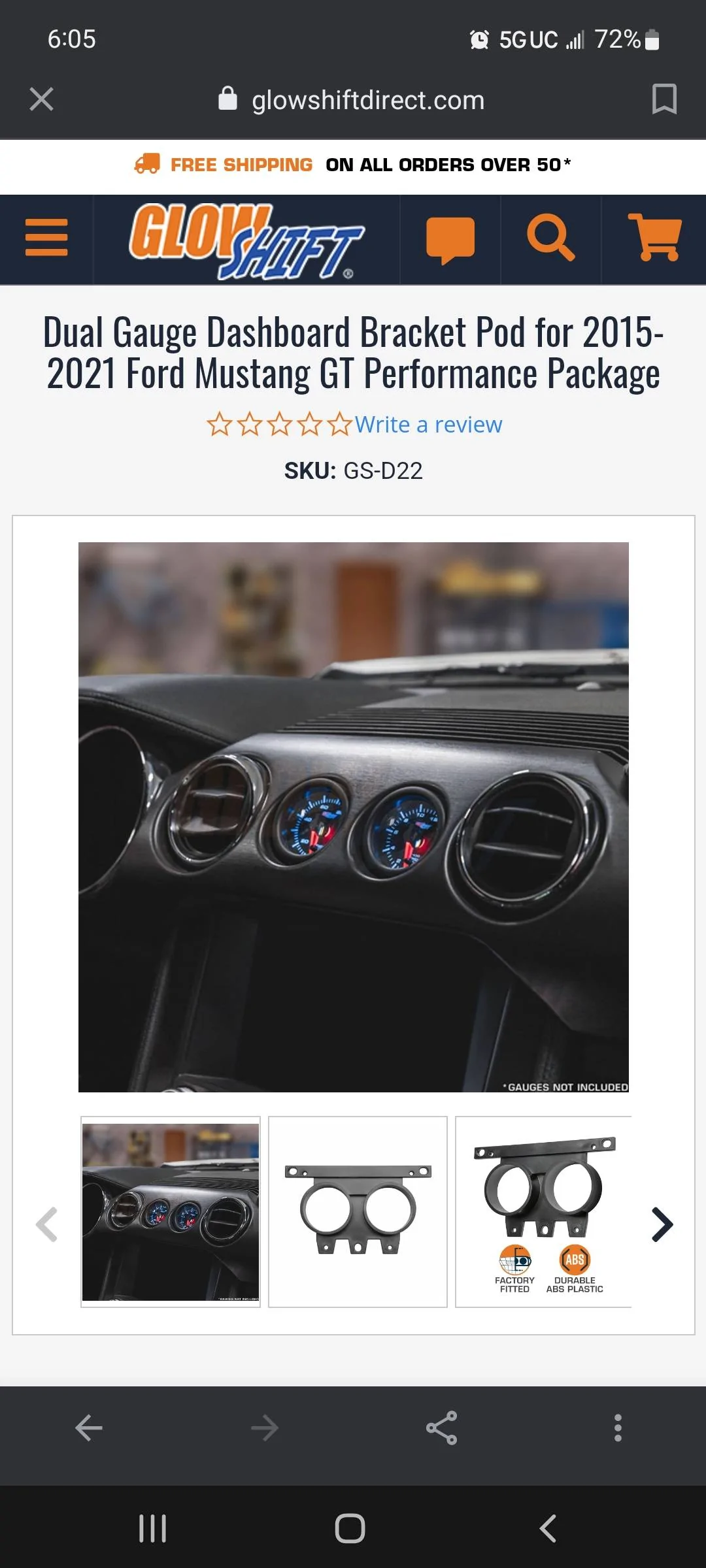

This is an option for 2 1/16 gauges in the pp dash, one that I'll be installing in my car at some point
Im doing the same thing with my Mach, waiting on one fitting to arrive. The vacuum gauge is a waste, IMO.
