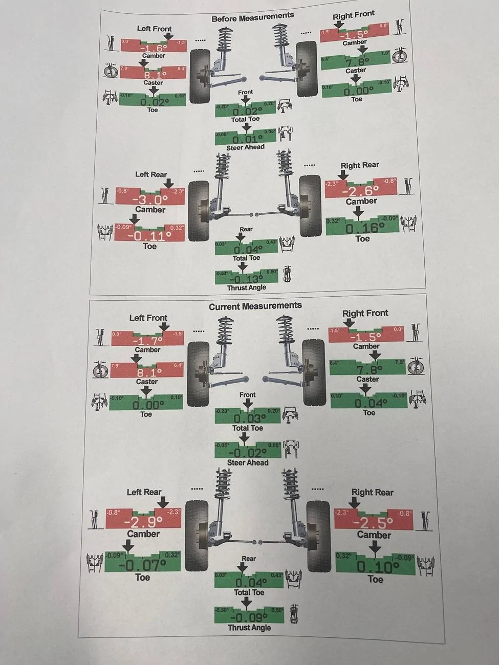

Both of my rear tires are wearing on the inside just had an alignment they say everything’s in spec, does this look right ?
running 285/30/20

Your rear toe is jacked. The camber is is quite a bit out. I don't like more than -1.75 for street use in the rear. If the shop says it is not adjustable tell them it is and to read the directions on win align.
You want +.1 toe on each side rear
You currently have +.1 on one side and -.07 (might as well call it -.1) on the other. I'll bet if you follow the car it is crabbing.
FInd a better alignment shop or make them correct it.

Thanks for the input I told them I think the camber was the problem an that’s exactly what they said “it’s not adjustable” I’ll let them know

I cannot give guidance on what specific settings you should try, but yes, the "after" results show little to no change and are still out of standard tolerances, front and rear.
I wouldn't return to the original shop either.

This is 100% true. That is worse then my "before" alignment. Find a shop that specializes and cares about what they're doing.

It's the toe more than camber.
You have a circle track alignment. It wants to turn left.

Find a new shop
Camber isn't the issue, I run 2.1 in the rear, 3.2 in the front, and I've never had excessive wear issues unless the toe is way out of wack.
Fix your toe, fix your issue. As everyone else says the shop you went to should not be patronized again.

I think it’s the toe that really kills that inner shoulder. I just had a big thread on it (and I haven’t done an alignment yet).
Camber will wear the entire inner half of your tire more aggressively but shouldn’t decimate anything like toe does.
