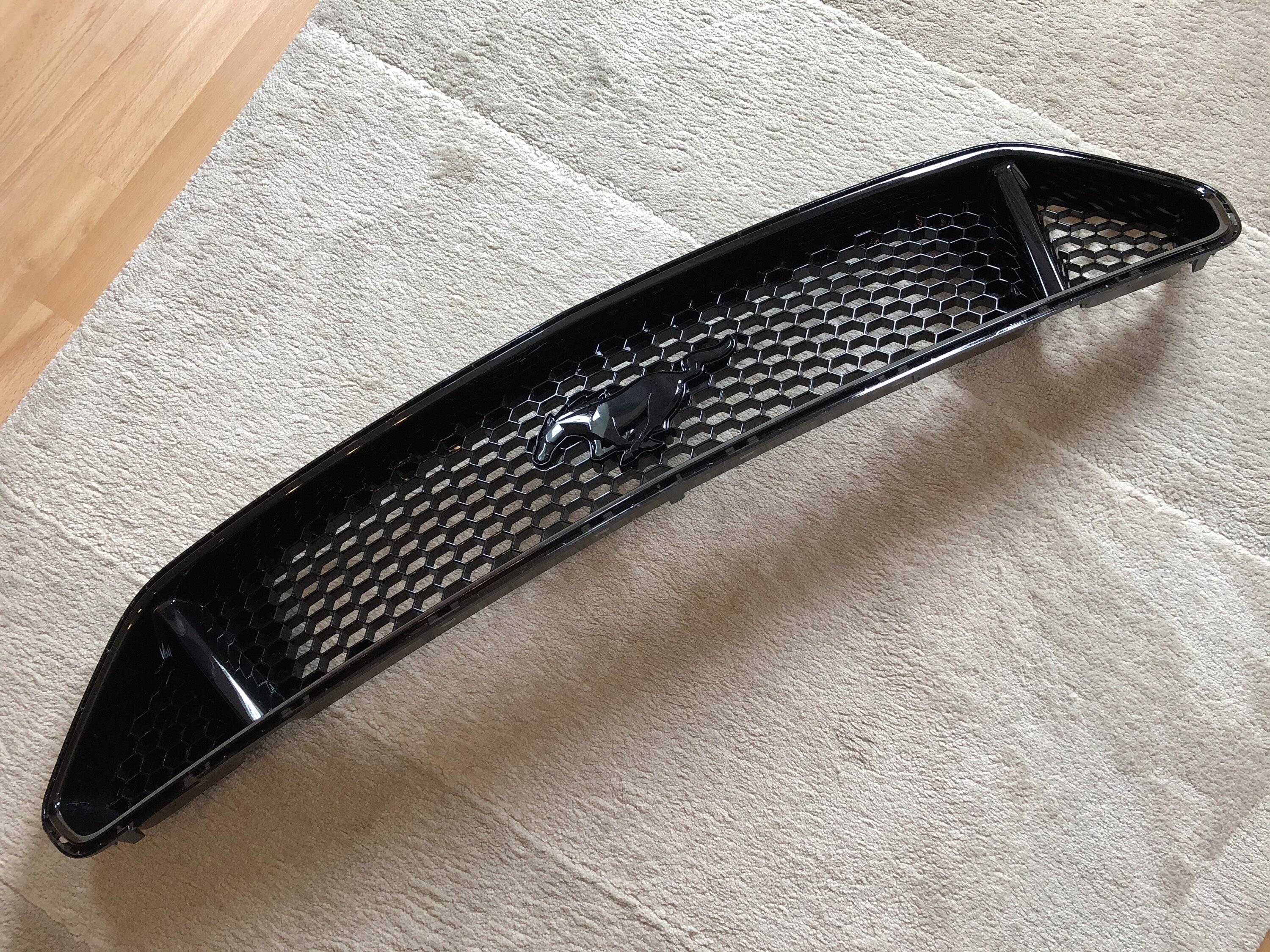

I recently acquired a 2019 PP2. I noticed that the small area of the grill that the engine air in take ( drivers side) sits behind has a few hexagon shape opening open but also has some of the hexagon shaped closed from the factory, filled with plastic.
any ideas why all those would not be open?
The passenger side seems to have all of these shapes closed/filled. Seems for a track car it may be worth while to open them up with a dremel to allow for more air flow.

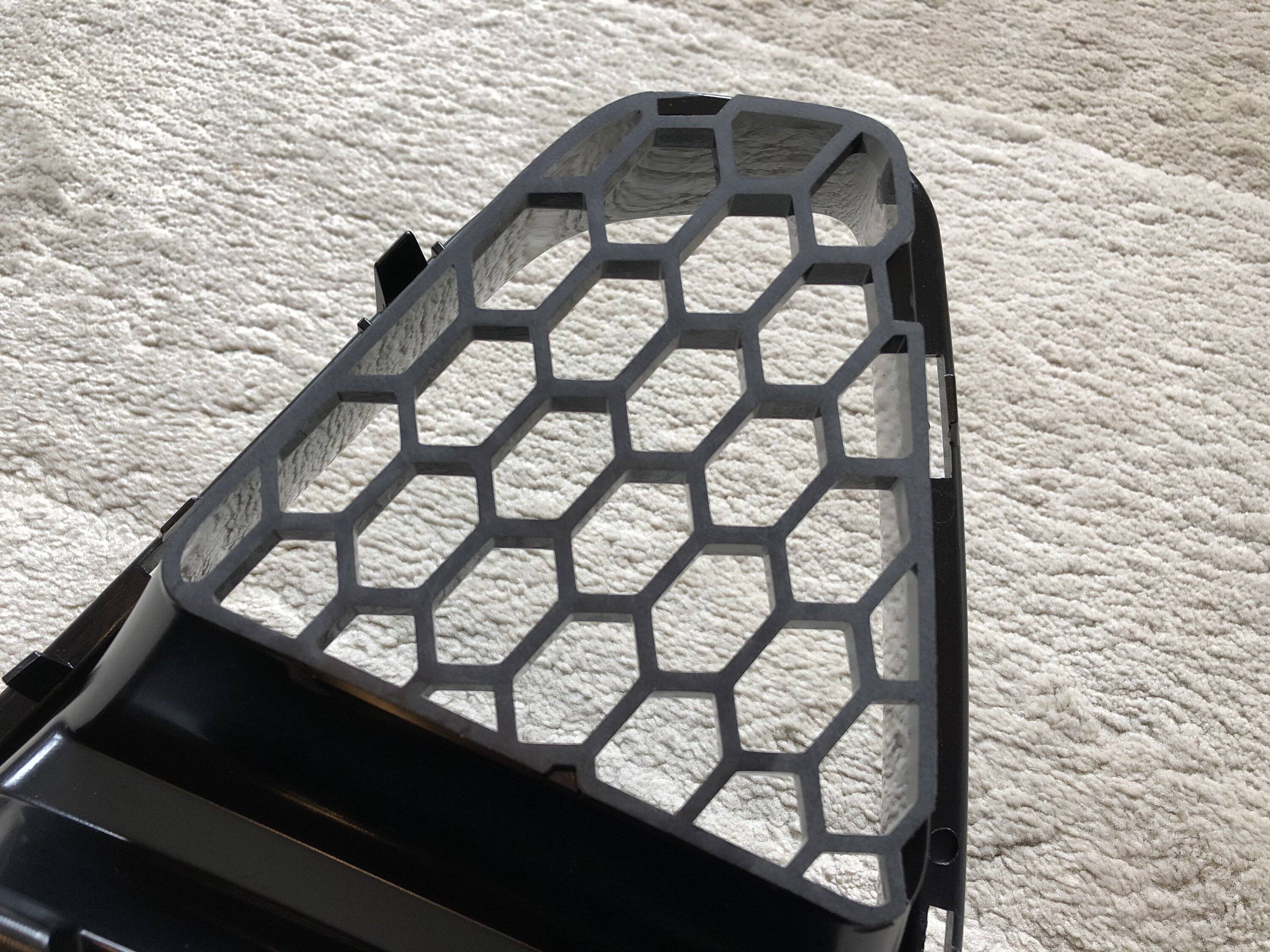

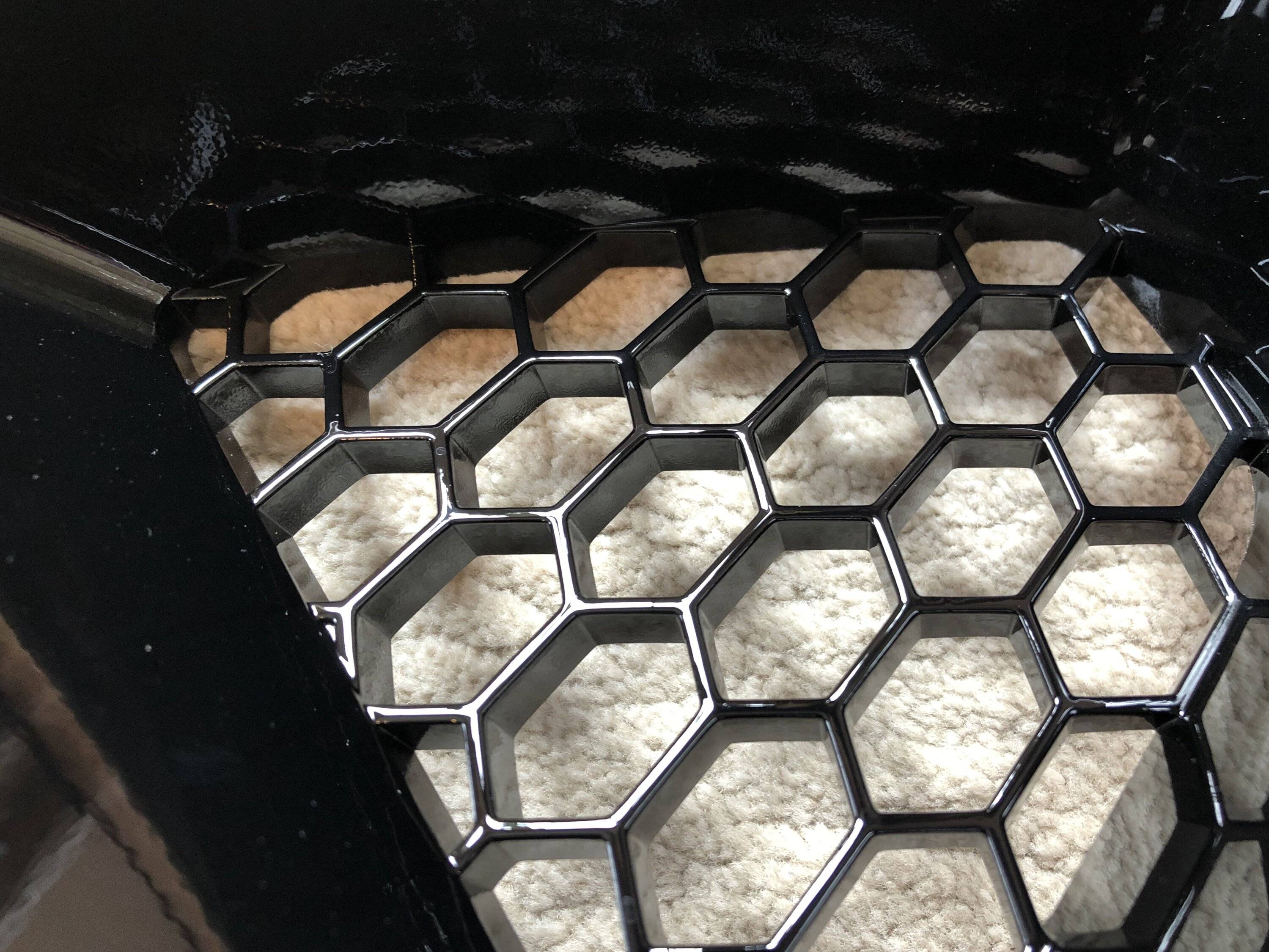

Yeah I sanded from the back when I added the big mouth :
WD :like:
that looks very nice! Is the remaining hexagon structure still stout? Or does it end up thin and flimsy? Last thing I want to do is replace the grill.
Yes, it’s almost as thick as the centre grill area - and that’s much bigger and less supported.
You can’t flex it by pushing on it by hand and it’s been like that getting on for three years now.
Using the big mouth behind it also minimises / eliminates any of the other concerns i.e. there’s no extra air going through the rad and messing up airflow or causing hood lift etc etc.
There’s also no hot air finding its way into the engine inlet and any increase in airflow due to the ram air effect, is directly fed to the filter / air box.
I power wash that area of the grill no problem - I guess any spray that manages to get as far as the filter is minimal due to the (self draining) pathway anyway.
