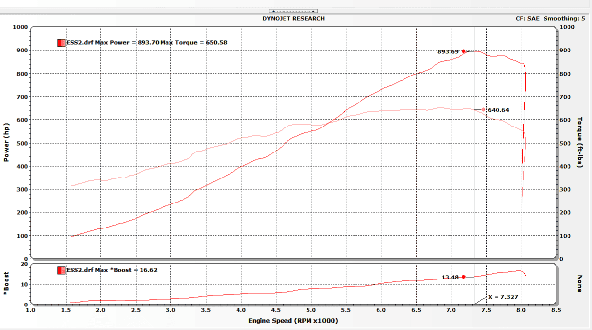

2020 Mustang GT 6spd w/ ESS G3 Supercharger 100mm pulley
ID1050x injectors
Stock intake manifold, catless stock exhaust manifolds, resonator delete stock active exhaust
Block is completely unopened
E50 ethanol
Transmission is stock đź‘€
Radium dual pump system
We did hit 900+ with 0 smoothing
I've had this kit for over a year now. Started on the G2 and made a best of 809. Kit has been great!
This has been verified on 2 different dynojet.

I cannot wait to pick up a kit for my gen 2 car. Aaaanndddd you have stock headers. That is really impressive and I bet it's an absolute blast with a stick.
Have you taken that thing down the 1/4?

Since it starts dropping off at the end while boost is still increasing, does that mean the blower is pretty much maxxed out?

I doubt it's maxed. There's a number of reasons why the graph dips like that.

Xtrim? Any idea what kind of timing it was running?

Seeing 21-22 and dropping to 18 at redline
Congrats on the numbers! Gives me hope for decent numbers on mine then except I’m an auto and with not as much timing.

Those are solid numbers.

not cams getting maxed out it's the tune or the stock headers hurting him.
People have made over 1600 whp on stock cams.
It's likely the headers.

Now it just needs to cool off so you can see what it runs out here before we lose our last drag local drag strip.
