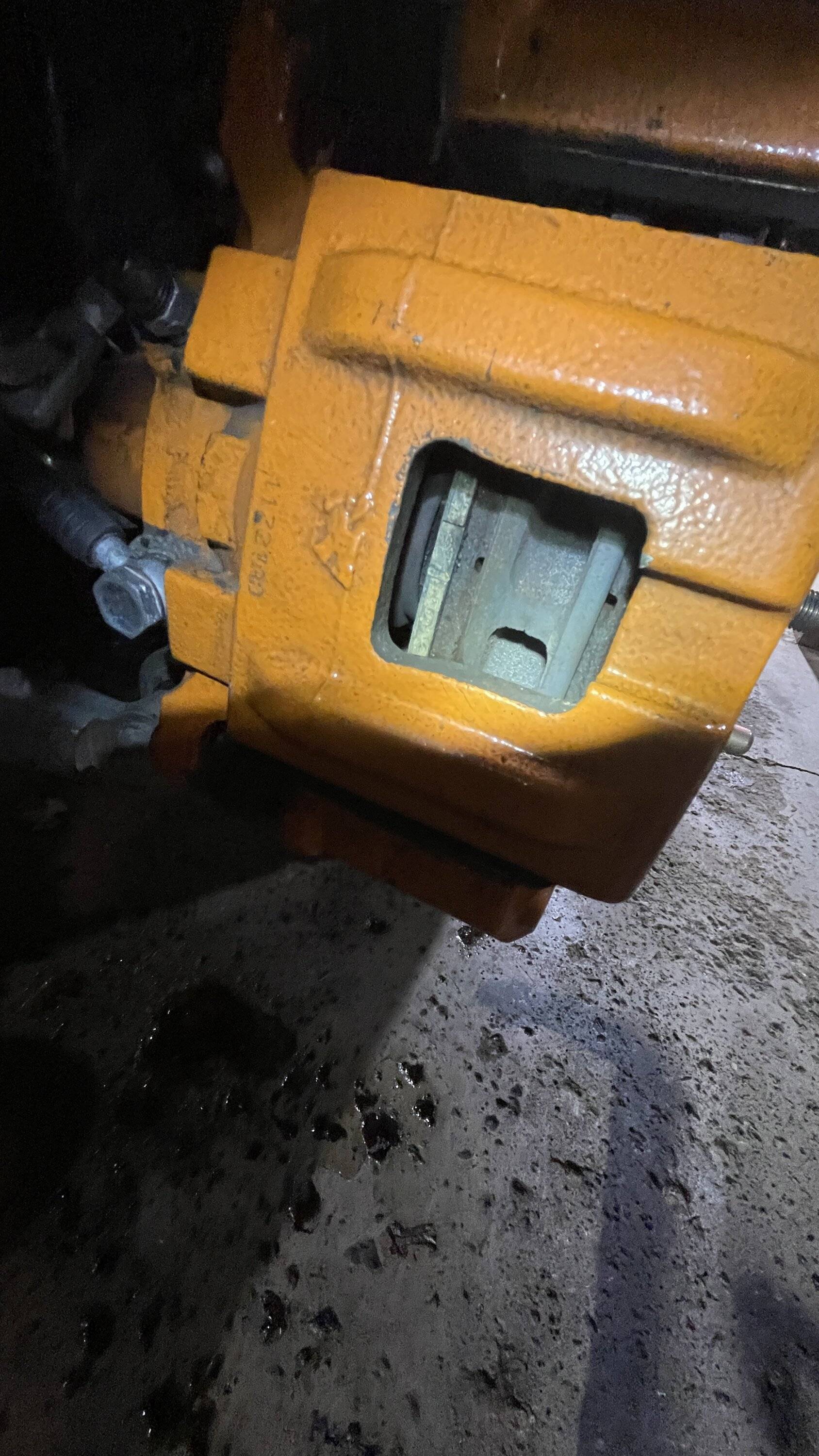

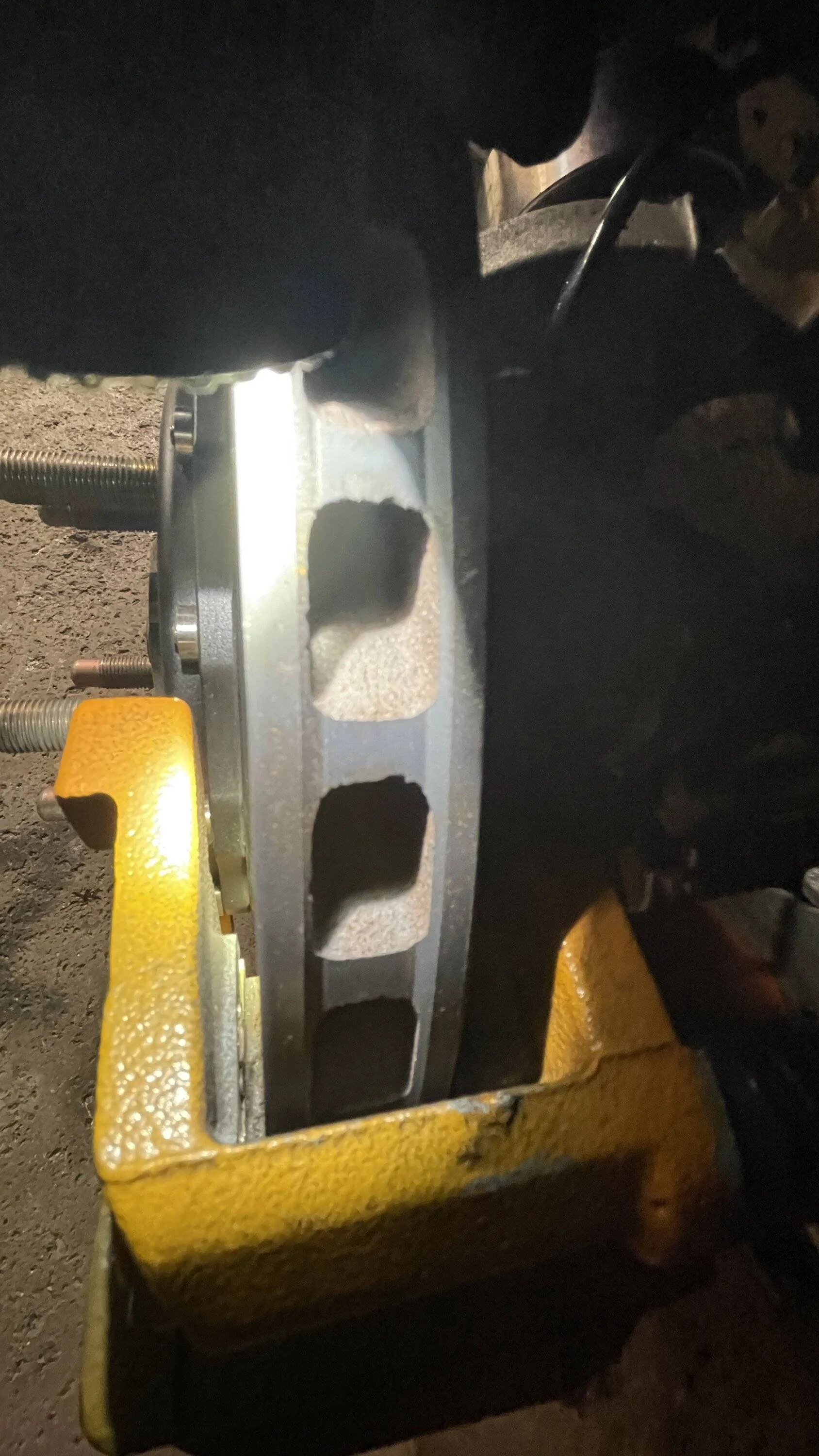

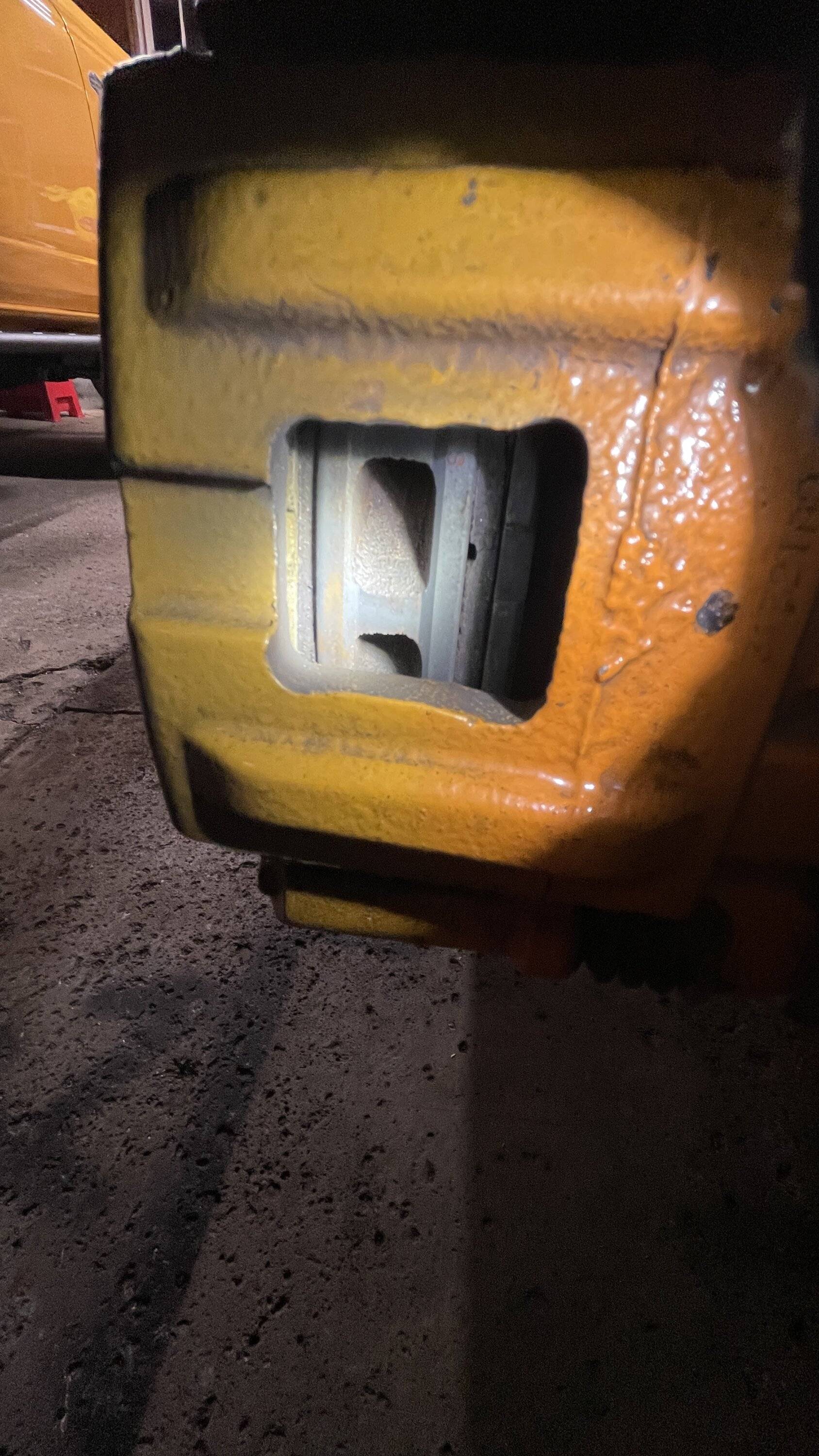

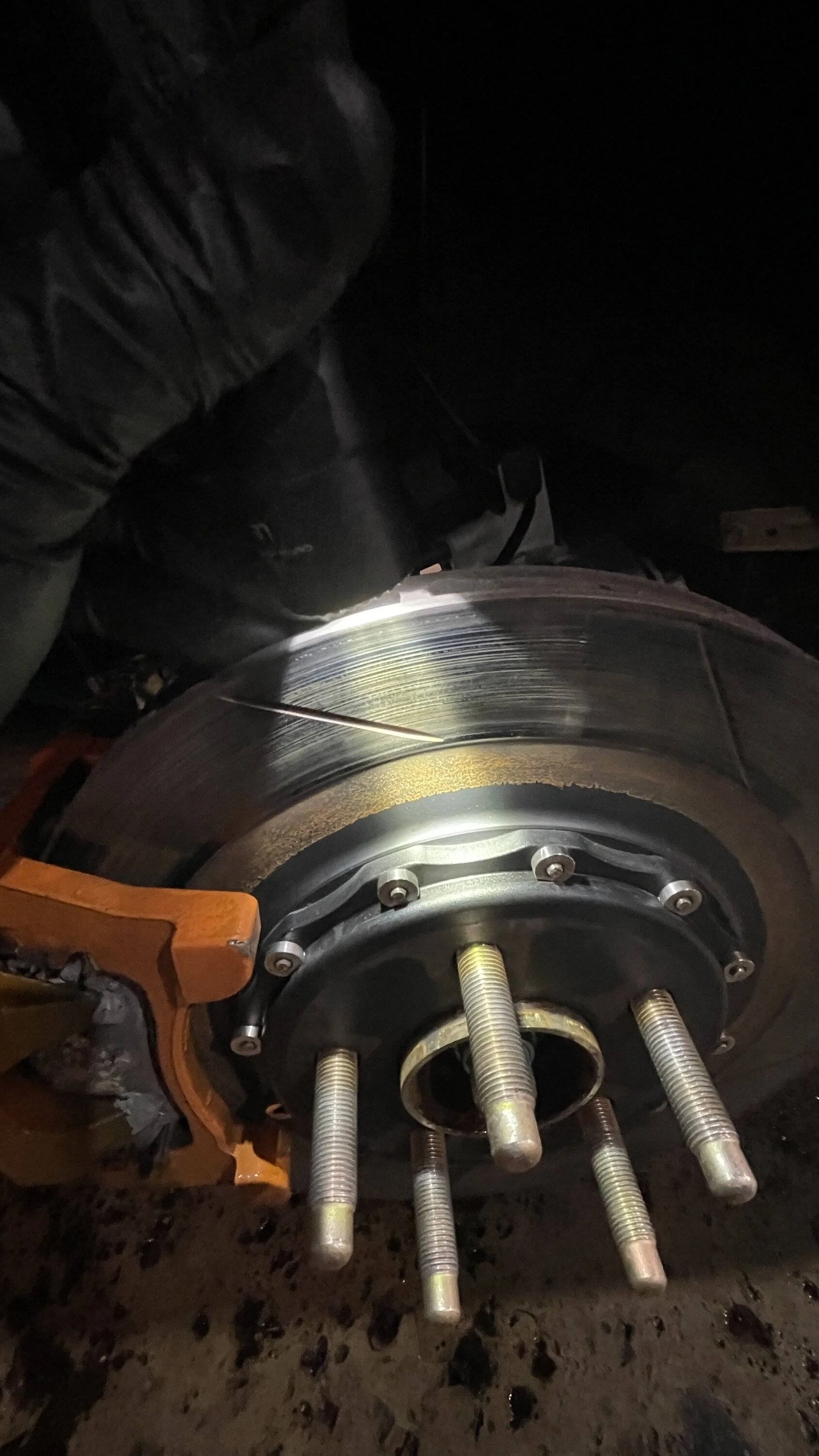

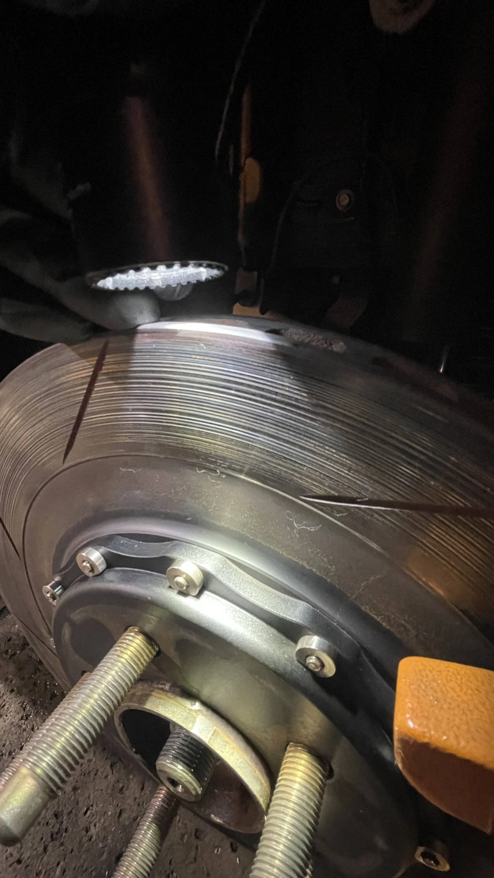

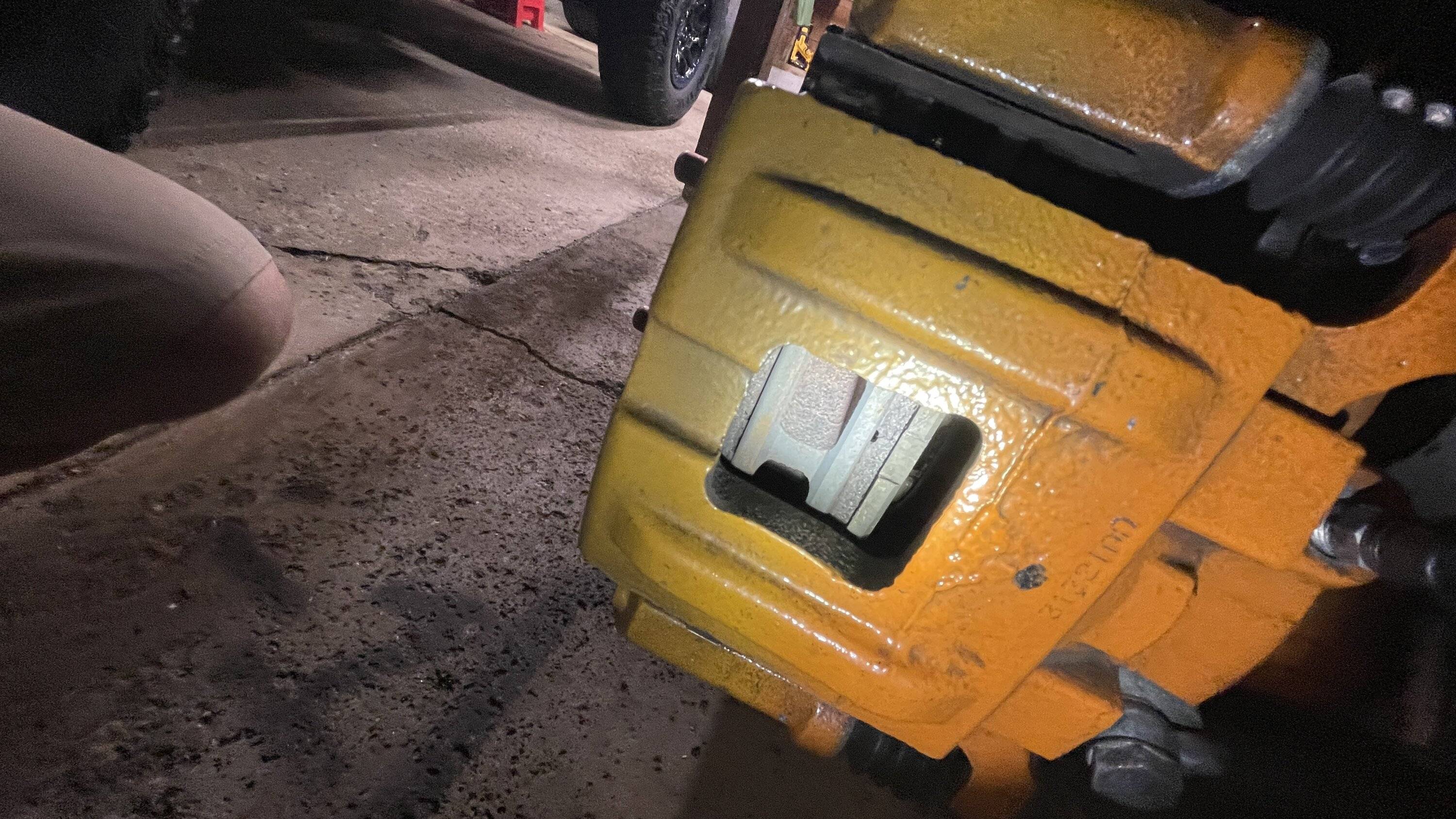

New friction disks on 2 piece rotors new DTC 30 pads bedded pads 35 to 5mph 10 times and 45 to 5mph 3 times moderate braking let cool. 1 autocross event 5 runs 65sec long + 8 20min track sessions at mid Ohio (best lap was sub 142 so the were getting some use). Outer left rear pad is worn more that the inner. this caliper obviously need a rebuild. I also have a crack in the right front friction disk that makes it unserviceable. I will need new friction disks all round and more rear pads plus a rebuild on the LR caliper at the least. I already have another set of DTC 60 from pads NIB.
Opt 1 stick with the 2 piece rotor setup above and rebuild both rear calibers.
Opt 2 pull the two piece setup and give away what's good with the sale of DTC 60 front pads NIB rebuild my rear calibers and reinstall the stock brakes Will do this for the remainder of the AutoX season.
Opt 3 GT 350R brake kit from LMR. only worry in my rear wheel fitment since I have 2 sets of HP wheels with good autocross and street/track tires.
Opt BEST... AP Racing by Essex Radi-CAL Competition Brakes. Only downside, I'm gonna have to sell some organs, plasma, and whatever else I can...

Edit: I believe the issue may have been the slides binding up or the piston was not seated (screwed back in) in the caliper. With that many sessions on the pads you really need to rotate them but again they are sliding calipers, they should move by hand easily. Also make sure the parking brake is adjusted properly.

Hard to tell from your photos but the wear difference on the pads doesn't seem that bad. Close enough that I wouldn't be worried.
