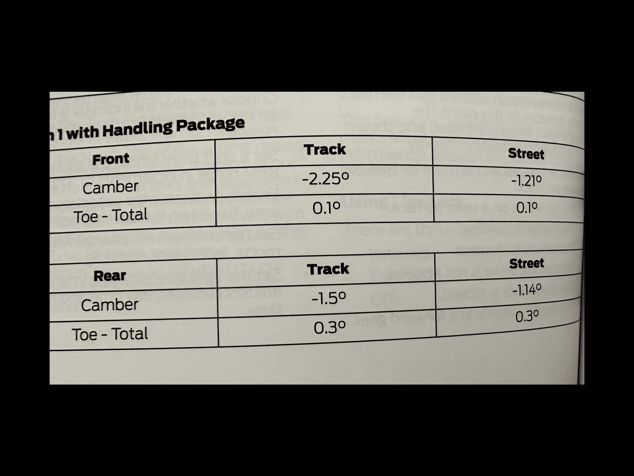

I'm trying to get my Mach 1 aligned with HP track specs. I have a nonHP car but have Steeda adjustable camber plates installed so the front should be fine to do. I took it to a dealer, I know but I asked them several times if they could do it and they told me yes, they could. Even talked to the guy that does it. Got my car back the front camber was -1.6 and -1.9 and the rear was -1.1 and -1.7.
When I called them about it they said they did it because they didn't want to be responsible for my tires wearing out faster than normal. (made it sound like it was going to be right away). After soon back and forth and telling them I know that the alignment will cause tires to wear out sooner and that I'm ok with it. I only drive about 4K a year and I do about 12 track days a year. I asked for an HP track alignment and was told that you could do it so that is what I want. In the end, I'm getting them to do the alignment again.
The odd this is that the car's camber is not balanced left to right. Even in the back, it is spec'ed for -1.5 so it is more and less on the sides. How important is it to have it the same?

What was your toe ? It matters more when it comes to wear than camber.
It's somewhat important to have it close camber between the sides but way less important than toe - I wouldn't sweat over hundreds but half a degree is little much for an alignment shop.

Hopefully you will be able to adjust your car for more negative camber at the track. And when you’re done move it back to street alignment. I have the HP and here are the alignment numbers for street and track.

The Toe is pretty good .06 on both sides (front) Total .12, rear is .12 L and .15 R
That was my understanding. It was just frustrating that I went over what I wanted before I took it to them and then when I dropped it off. Plus if they were concerned they could have just asked me and I would have confirmed what I wanted. I kept asking them "Can you do HP track alignment" Yes we can, are you sure? I have a nonHP car but I have adjustable camber plates so it will allow you to do the HP track alignment... on and on. They kept saying they could. There was nothing left for interpretation. So back to them.
