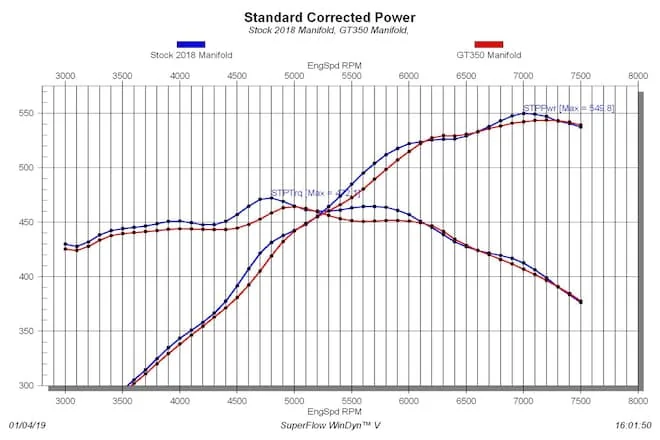

given the downward trajectory of the torque curve past 6000 and that the intake doesn't help, I don't see the point. I mean it'll still be "cool" but it unlikely to have any useful effect.
Exactly, whats funny is the Ford Racing tune that uses the GT350 intake, tune and throttle body makes more torque than the Bullitt and Mach 1.
it also requires 91, the Bullitt/Mach1 dont. Likely a reason why.
The Mustang Mach 1 HP rating is with 93 octane, but I think you are right. Ford Racing is flaunting that the motor makes 20rwhp more at 2200rpm probably due to the fact it requires 91 and the fact the OEM 18+ IM makes better low end than the GT350 IM.

I'm pretty sure all the actual power increase is in the TB and the cai tube. Because Ford performance is selling the power pack with only the TB, cai, and tune and claiming 19hp andn18 tq . The biggest increase is the 40 tq at low rpm.
The funny thing is that the throttle body and CAI are not likely to add anything at low rpm, all that 40 tq is probably timing (thus the need for 91 octane).

Also that 40
That torque increase is so low in the rev range it's kind of worthless. There is a 20ft/lbs increase though through most of the rev range.
