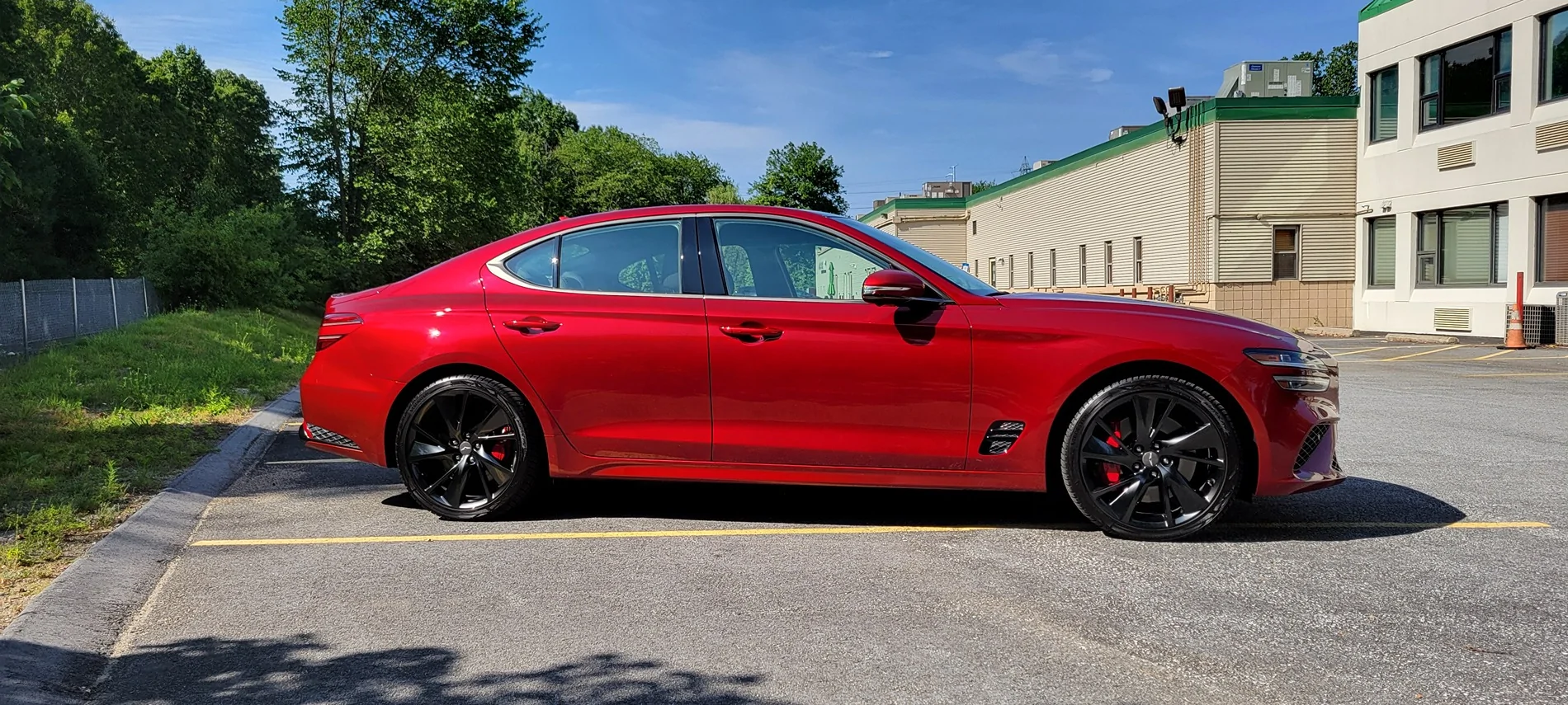

Depending on the coating that you got on your car, some make a "maintenance" spray for just that, maintenance.
I had my daily driver professionally ceramic coated with Car Pros ceramic coating. It's their 3 year ceramic coating. I use this product called, CARE, which was developed by Ceramic Pros, as a drying aid/maintenance item every time I wash the car.
Still looks pretty killer.

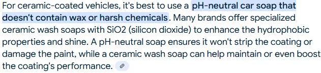

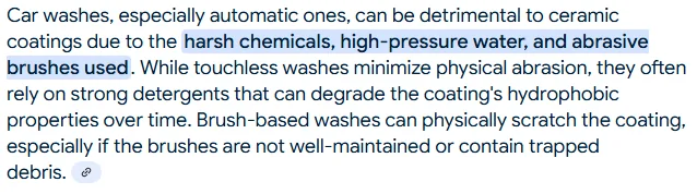

Well, my opinion if its worth it?? You still cannot run through a Brush type car wash and it is recommended to hand wash with a
