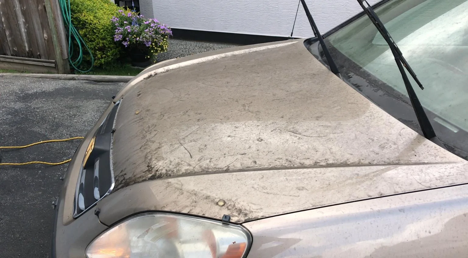

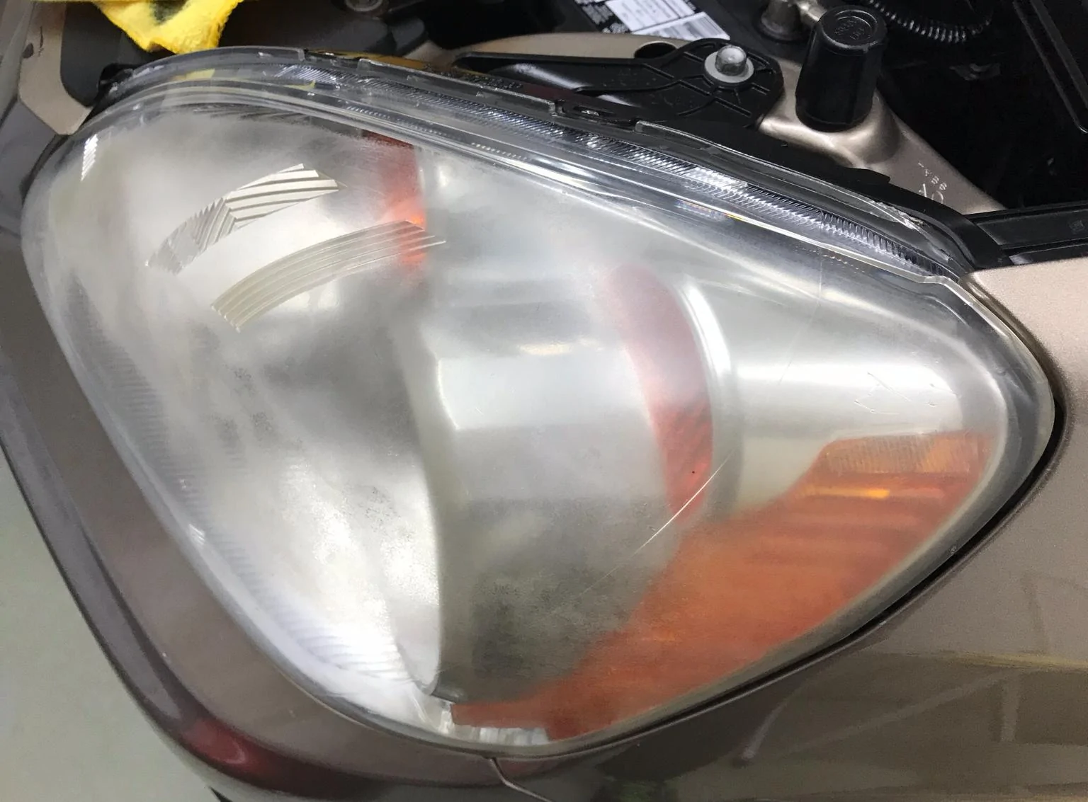

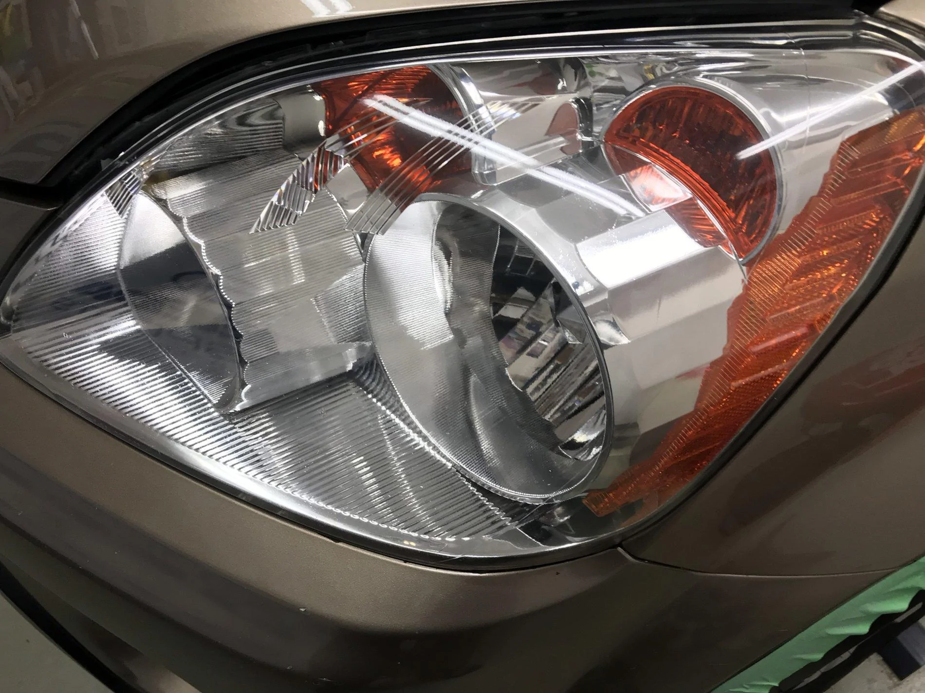

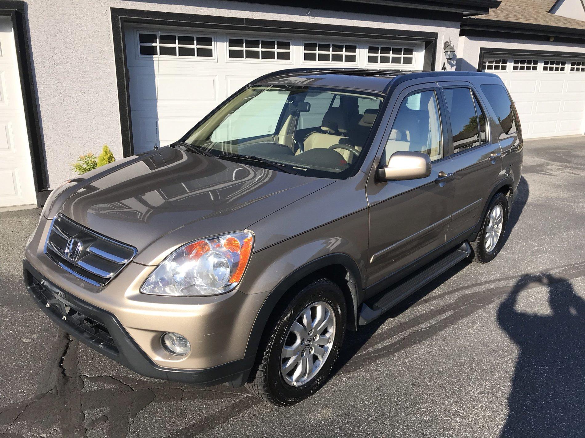

Not a Mustang...but it is the prep! This one sat under a tree for 4 months..Tree sap, green rotted leaves.. I had to wash it twice...Polish twice ( cutting polish then the finer polish...clean, clean, clean!! Added some pinstriping down the sides. Total time on this one.. 25hrs! ...but I’m retired and it really is not hard work..just tedious! As I mentioned before..tunes and garage beers!! NOTE...most high end shops have infrared lights to cure the Ceramic much faster!! Yes, I use a DA polisher...try Scholls S20 Black Polish...amazing product!!
Good lord. It looks off the lot.

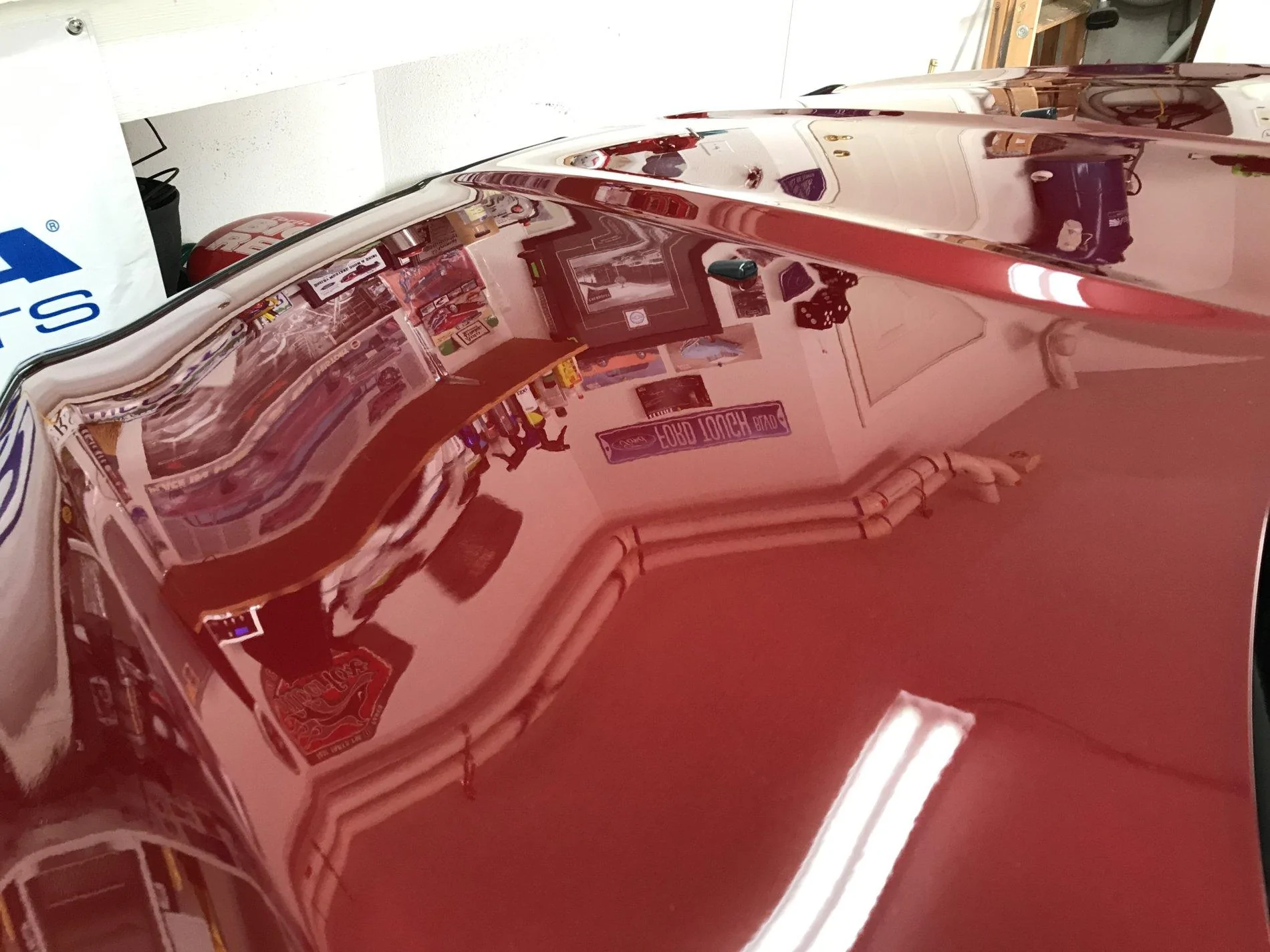

I did my neighbors 2014 Ford Escape..Ruby Red... incredible in the sunlight!! DIY is sooo friggin easy!! You really should try it!!

OK, now you’re just showing off :):clap:
I love my Oxford White, but I miss my Ruby. When done right, the depth is unreal.

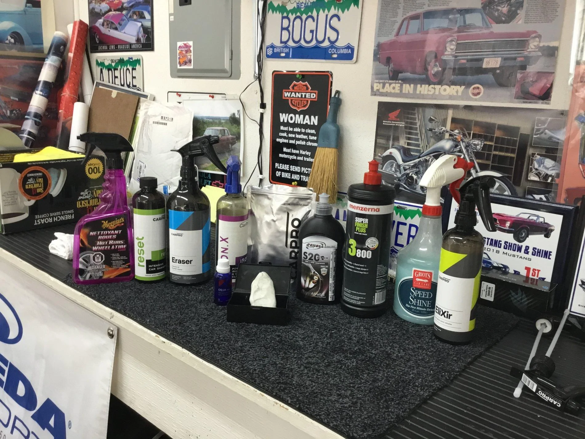

I use Car Pro Products from Sky’s the Limit based in Florida!!!.... so,yes... wash with Reset, Clay bar, Iron-X, .... Scholls S20 Black Polish ( debuted at last years SEMA show!! ... cuts and polishes with one pad!!), clean, clean, clean with Eraser.... apply CQuartz UK 3.0, microfibre cloth for removal and polish (garbage the cloths used in this process as they will contain glass chards!! One coat of Reload the next day!! Yes it’s a long process....but good for 3-5yrs !!!!

Big fan of Car Pro here too.

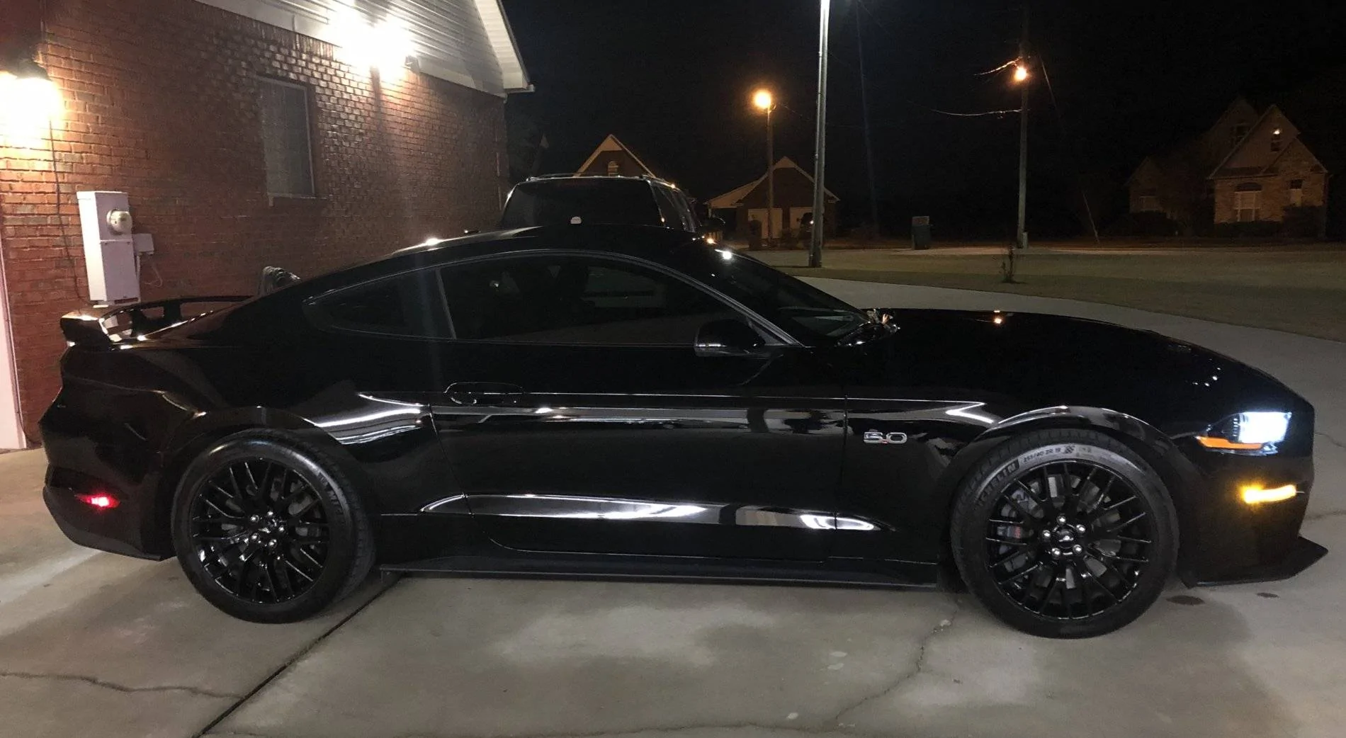

My husband and I have a guy that applies the ceramic coating to our cars and then we use the products to keep them up. We use Detail King and they are amazing! customer support is amazing on top of it.
Here is my 2019 Mustang GT Premium Black on Black. I have had it since the first of July. It feels like glass when you run your hand across it. It is my daily driver. No swirls, scratches, or anything from the constant washing. When I say constant I literally mean our cars are washed 2-3 times per week.
My husband's daily driver is a 2013 Camero ZL1. It's red. It looks like a showroom car as mine does.
My husband paid about $800 for each car for the initial coating. The guy "cut" the blemishes out of the paint and the trash that is always left in the paint. My husband bought his car used. The previous owner had it parked under a tree for years. Our guy really worked on the car and now you cannot see any spots on it. Our guys went a little crazy on my Mustang and did a little more than we requested. LOL As I told my husband... it proves that I have the better car LOL
