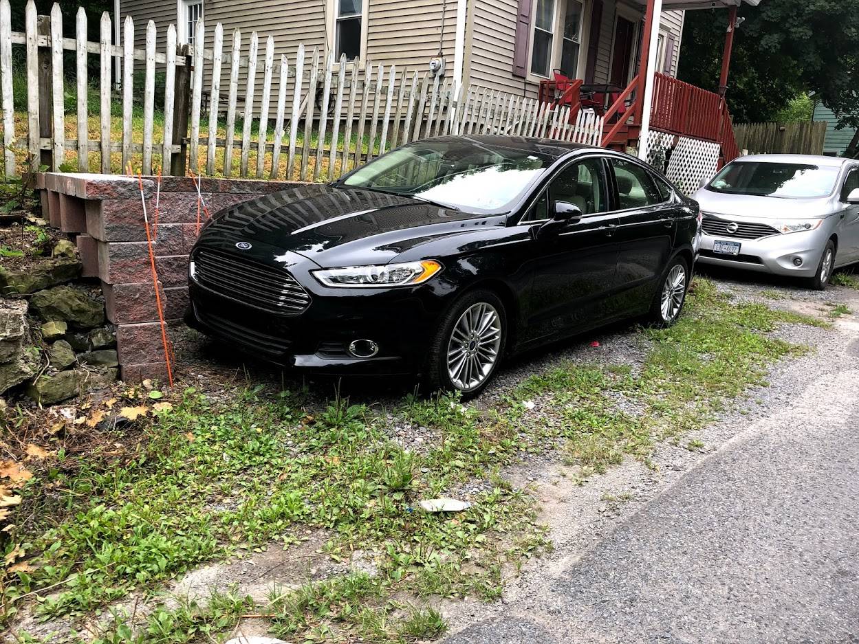

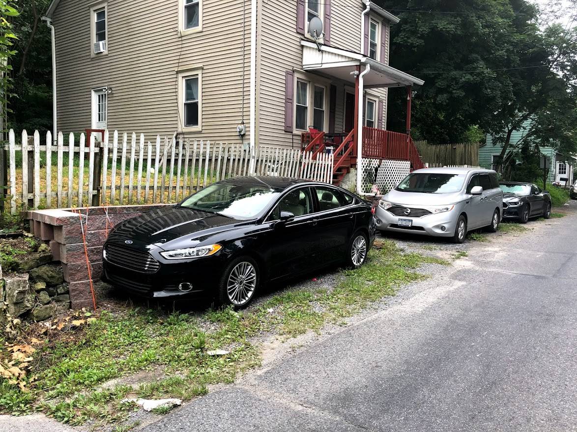

Below is my son's fusion. We went around this once with geyon primer by hand and 24 hours later carpro 3.0
Definitely worth it to do this step

It looks great and DIY friendly.
Would I use a paint sealant before using the 3.0?
