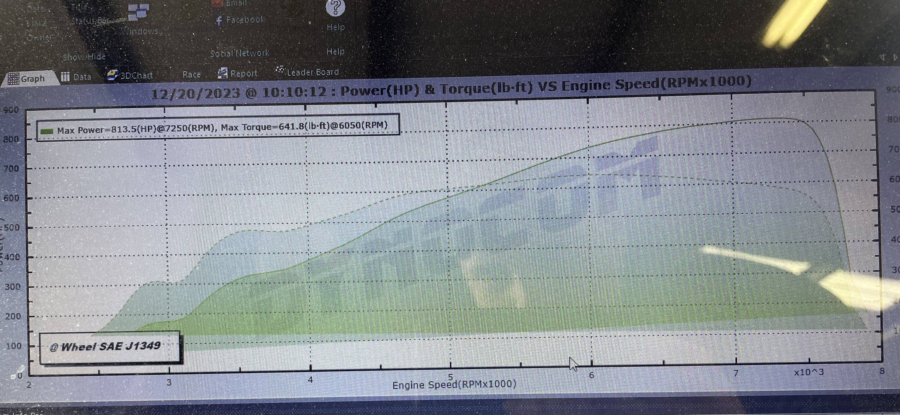

Hello everyone,
I’m just going to get straight to the point, how much horsepower are ID1050x fuel injectors capable of supporting on a boosted/E85 3rd gen 5.0?
I was running Sai Li dual pump with ID1050x injectors on E85 along with my ESS G3 110mm pulley and made 813 whp and that was it, the fuel system was tapped out. So I just bought a Lethal Performance fuel system triple pump (3x Walboro F90000285-486lph) but I’m wondering if I need to also buy ID1300x if I want to make 1xxxHP, obviously I will pulley down significantly after my fuel system install because my Sai li was only able to safely run the 110mm. So again will ID1050x be able to push 1000whp or do I need ID1300x?

On the gen 3 you'll be able to get decently higher numbers out of a set of 1000x. As long as everything is plumbed correctly and wired correctly you should be able to hit 4 digit power without tapping out the injectors. Increasing the base pressure will help extend the top end of the injector and shouldn't be as problematic on a set of 1000's as the bigger squirters for idle quality.
The other aspect is ID's internal limits vs what a tuner is comfortable with seeing for duty cycle. Someone would have to weigh in with what ID sets as the duty cycle limit, but I generally think it's both lower (at max output) and higher (on the bottom end) than what most tuners are comfortable seeing. With a high pressure system helping you shouldn't have any problems hitting 1000+.

850-950 depedning on power adder, rpm, year of car

2019 5.0, ESS G3/G4 IC 100mm pulley, midnight stage 2+ 10r80, triple pump return style fuel system

850-maybe 900, centri for whatever reason seem to tax the injectors more, because of the increasing boost curve. after about 900 we go to an id1300 of fic1440 for the guys
