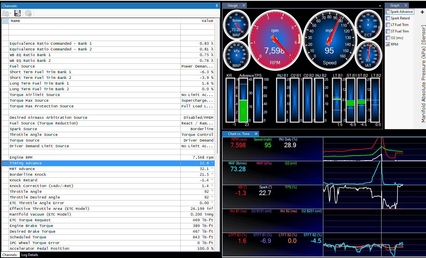

Obviously, the answer is always Uni-Corn Blood. You don't need a "full Blown" fuel system. Go with a Sai-Li or other entry level return system, stock fuel rails, and larger injectors and enjoy all the benefits and safety of E85, and easily run a 115MM pulley. Here's a log of mine (Don't you flat- landers laugh at my tiny MAF lb/min). Still adding timing at 7500 RPM, 22.8 degrees.
It’s so tiny!!! 🤣 What was your PI fuel pressure reading there? That timing is very nice, I see a max of around 20 degrees with mine.
