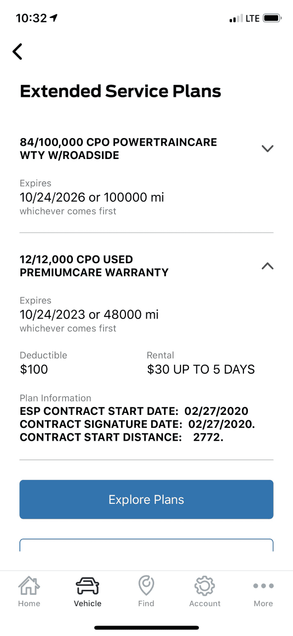

The dealer told me it runs concurrent, but on the app, I see the opposite info below. The car was first sold/titled new on 10/24/2019, and traded in on 2/3/2020, I bought it on 2/27/2020. Its showing the CPO warranty expiring 4 years after first title (with the extra 12,000 miles), and powertrain 7 years after title. Is the info below wrong?

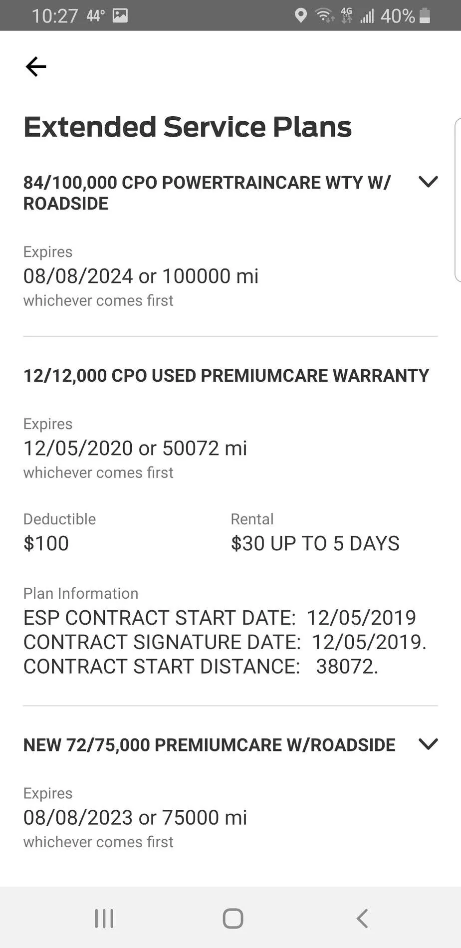

I purchased my17 CPO View attachment 448242 on 12/5/19 it had 38072 miles. Its orginal start date was 8/8/17. Out of b2b on miles. The screenshot is from Ford pass app.
I did buy additional ESP Premium Care from Ziggler not the selling dealer. I think depending on what the time and mileage is causes some confusion. The CPO for b2b starts from your purchase date with 12k miles. The pwrtrn portion is from orginal start date or the expiration mileage whichever comes first. Having a low mileage short start date, main advantage would be extension of pwrtrn coverage. Kinda simple but maybe not.

OP, you are correct that that 12/12 warranty starts at the conclusion of what is left on the original 3/36. The powertrain adds 2/40 to the original that started at the original purchase date. The dates you see in Fordpass are correct. If you still have doubts call Ford (not your dealer) to confirm.

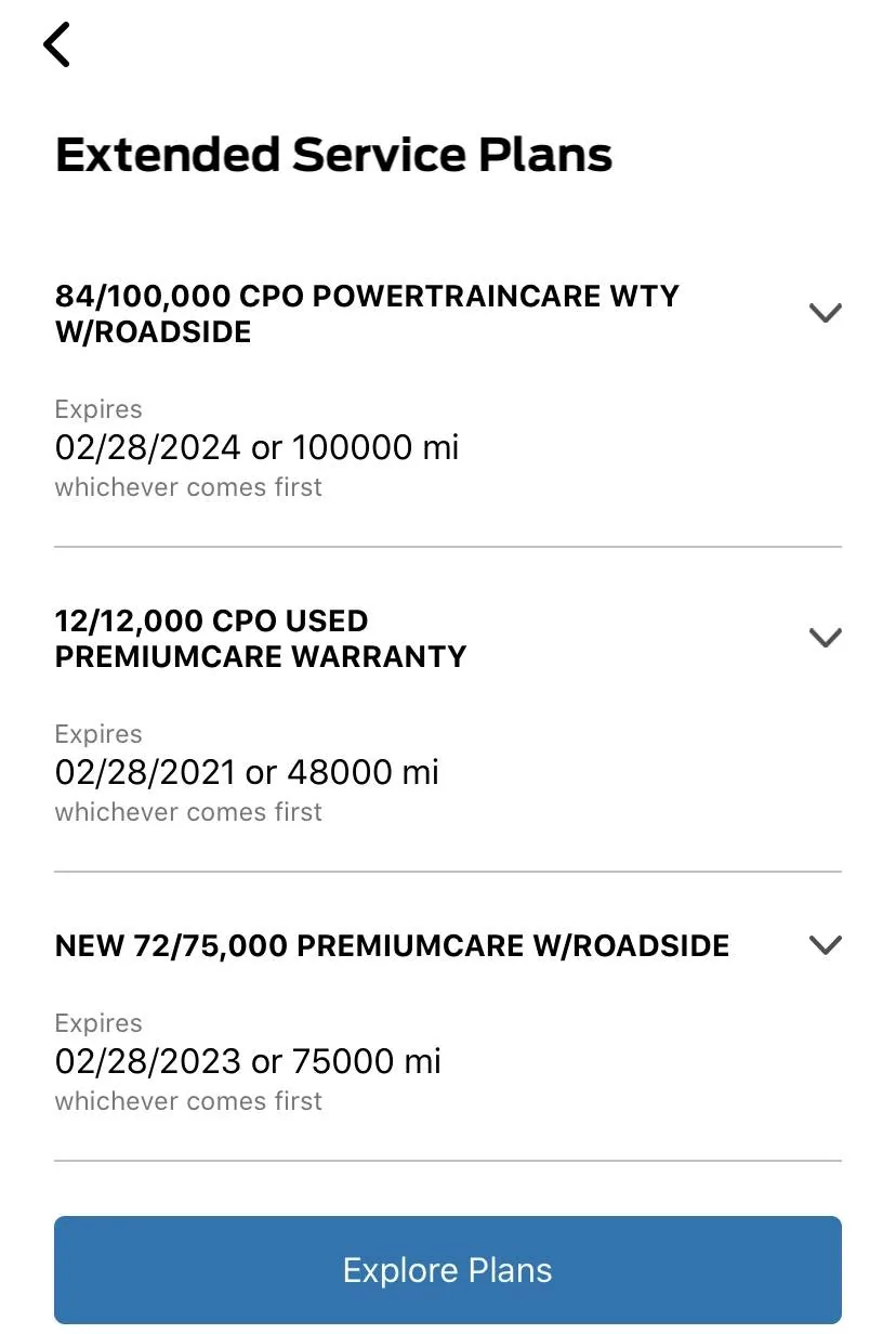

@17Magnetic5.0 thank you for the reply. Yours is showing more like mine, 4 years/48000 miles. So, hypothetically, if you took your car in on Feb 1, 2021 you would be out of bumper to bumper warranty, but would still have CPO warranty, right?
@Stone pony If I am reading this right, your warranty is showing different than ours ?
Is the possible that when you buy a CPO car the factory warranty/bumper to bumper is gone and replaced by the CPO $100 deductible warranty for the duration of the warranty time period? That would at least make sense to me
Sorry if I am making this way more complicated than it is, I just want to know what I have, and don't want any surprises if I ever need to use this warranty.

I actually was thinking after I made that post that wether or not the b2b is still in effect might make a difference, mine was out. But by any means, whatever shows on your app for your car is what Ford has regardless of what a dealer may say.

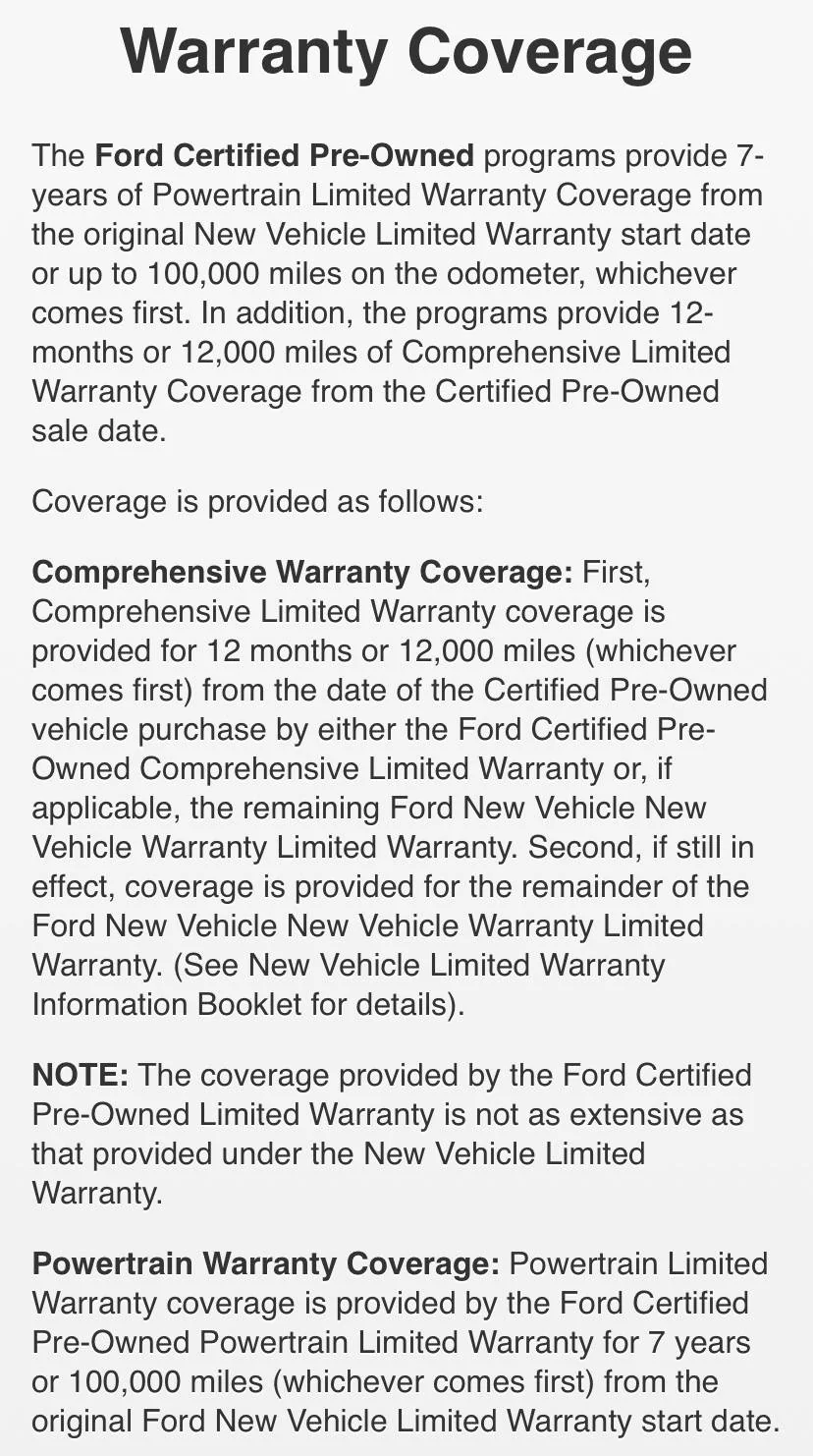

Here hopefully this clarifies the answer:
