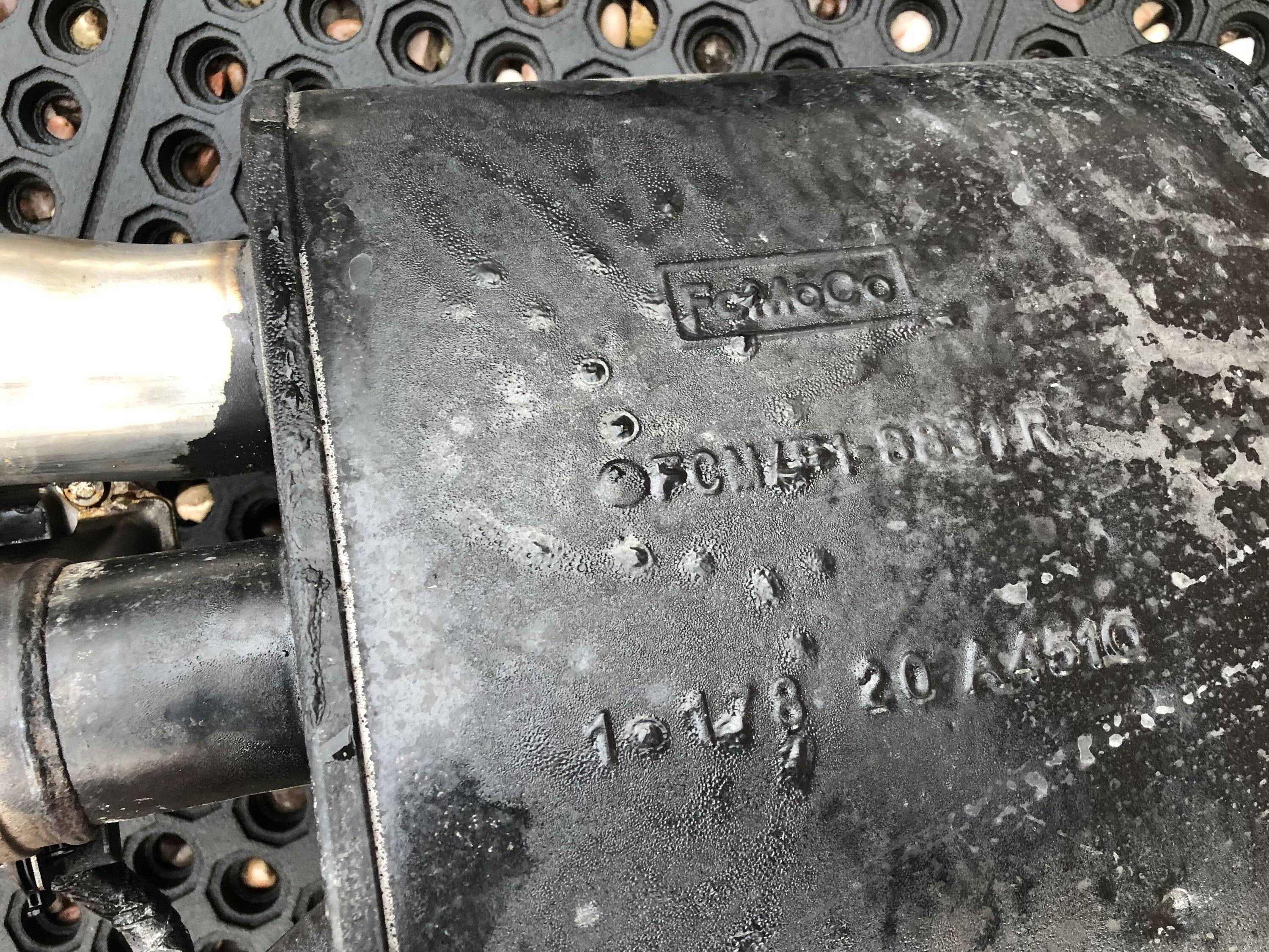

My factory Cat back is in my building collecting dust since my Borla upgrade. The Borla system had the valves already installed I just had to swap over the motor actuators. I hope to sell one day to someone that doing a trade or lease return and wants to return to stock otherwise I would take a sawzall to it LOL...
