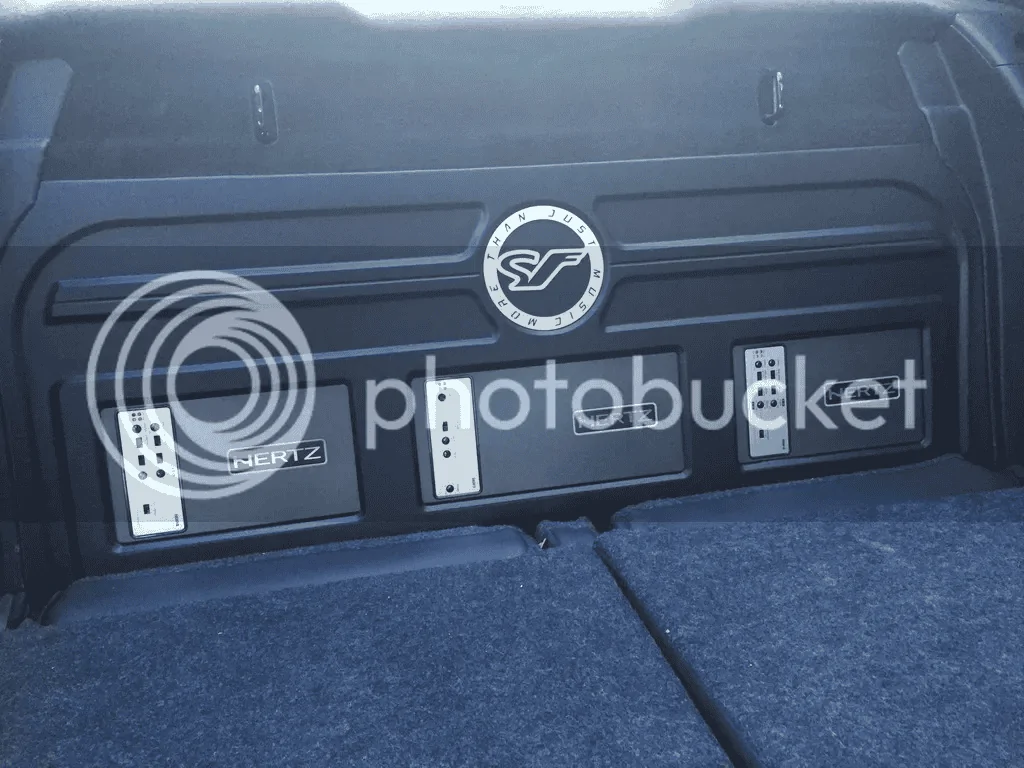

Vicr
Mar 8, 2018
530
350
Fortuna Foothills, AZ
Vic
2015 Mustang Ecoboost Premium

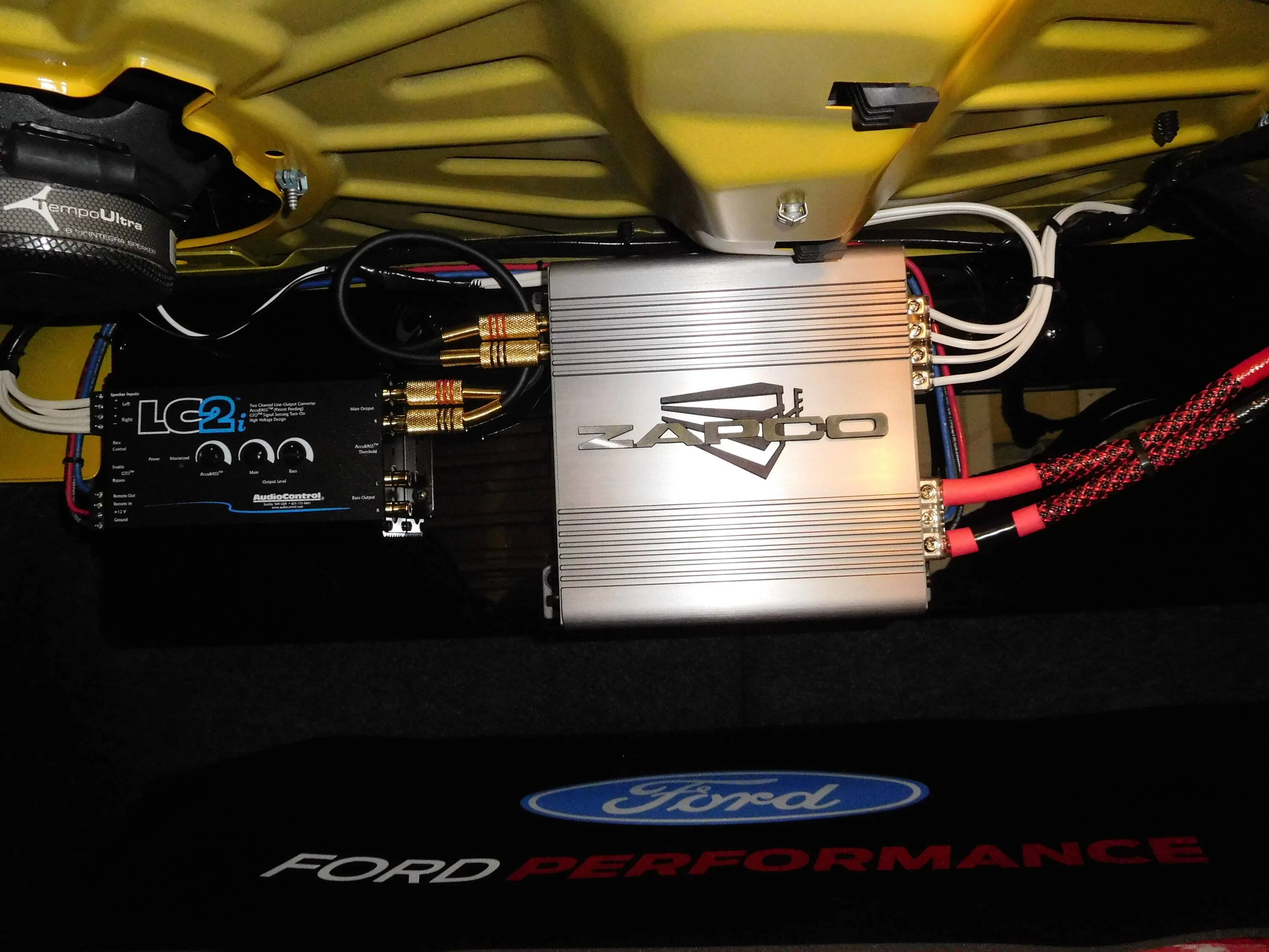

I mounted my DSP and my dedicated amp for my rear deck speakers on the vertical piece right below the rear package tray. I used black Lexan as a mounting surface. There is still room for a dedicated sub amp if I want to go that route.

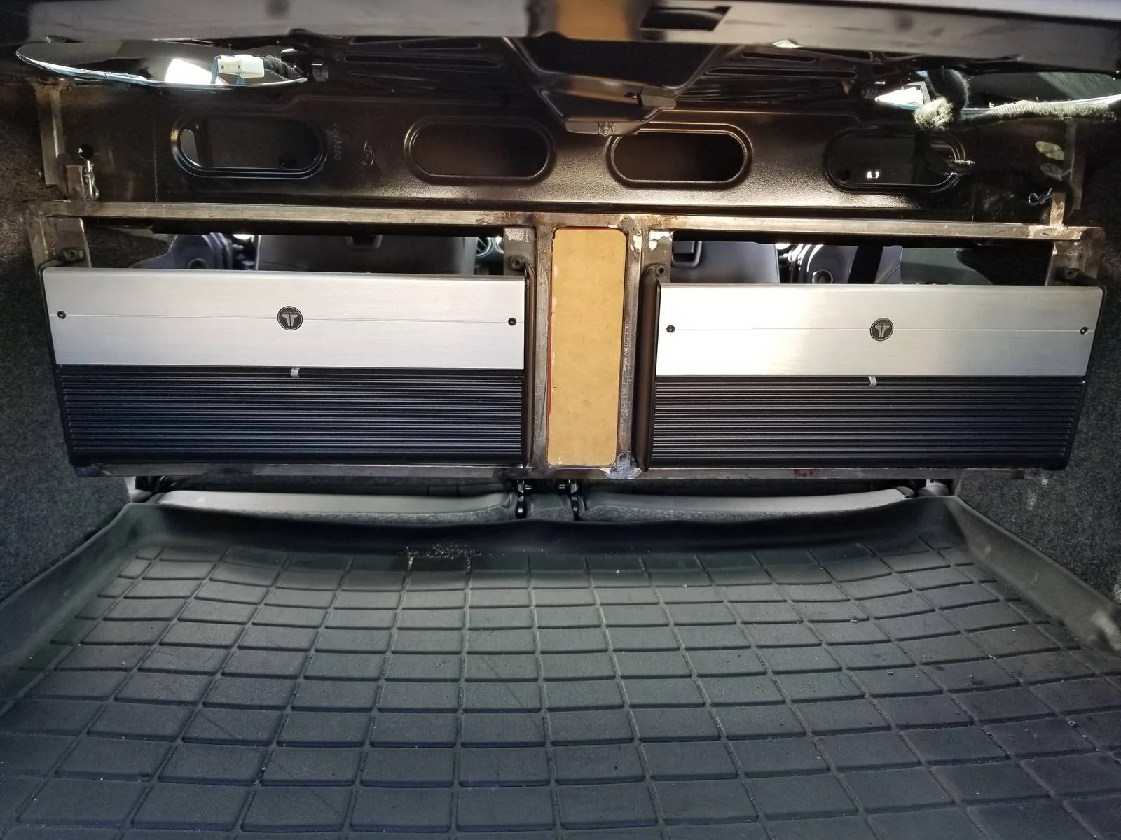

Ackbar00
Jan 18, 2021
54
119
Dayton, Ohio
Paul
2020 Mustang GT / 1969 Mustang 302
Back of the seat for me:
Vicr
Mar 8, 2018
530
350
Vic
I thought about doing the back of the seat but I need to fold the seat down for my rifle cases to fit.

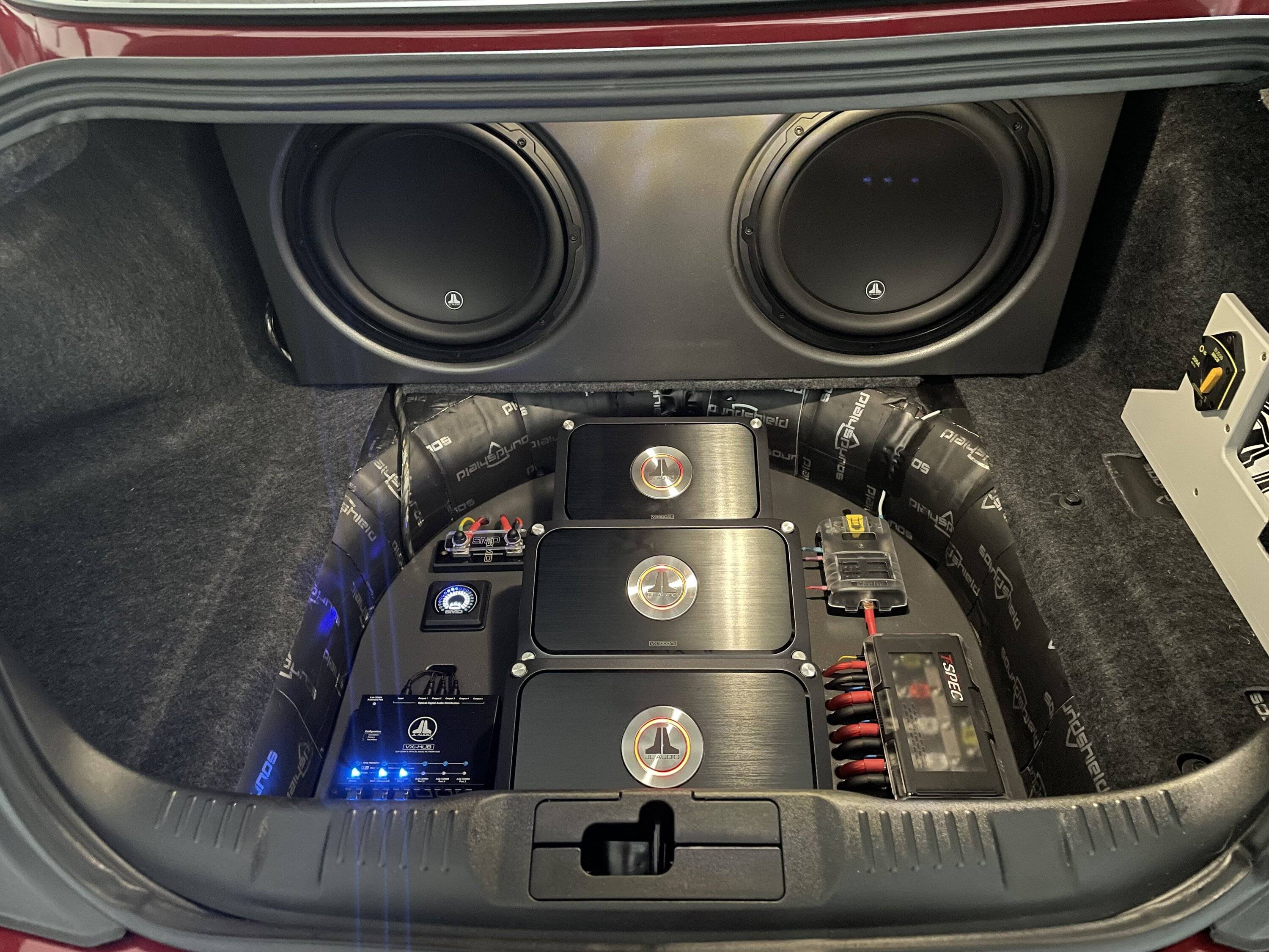

m3incorp
Feb 6, 2020
4,624
3,135
Georgia/Colorado
James

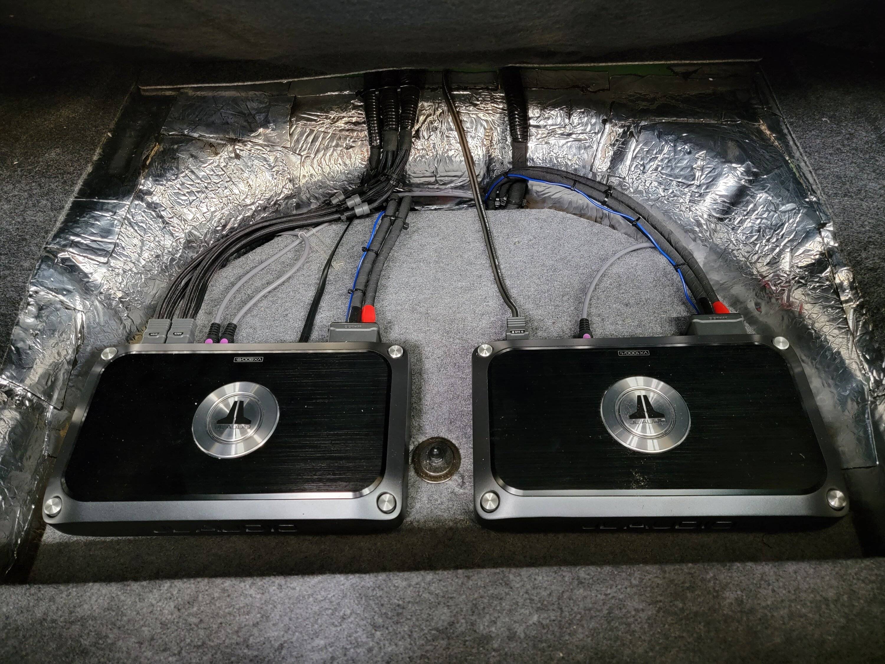

In spare tire well.

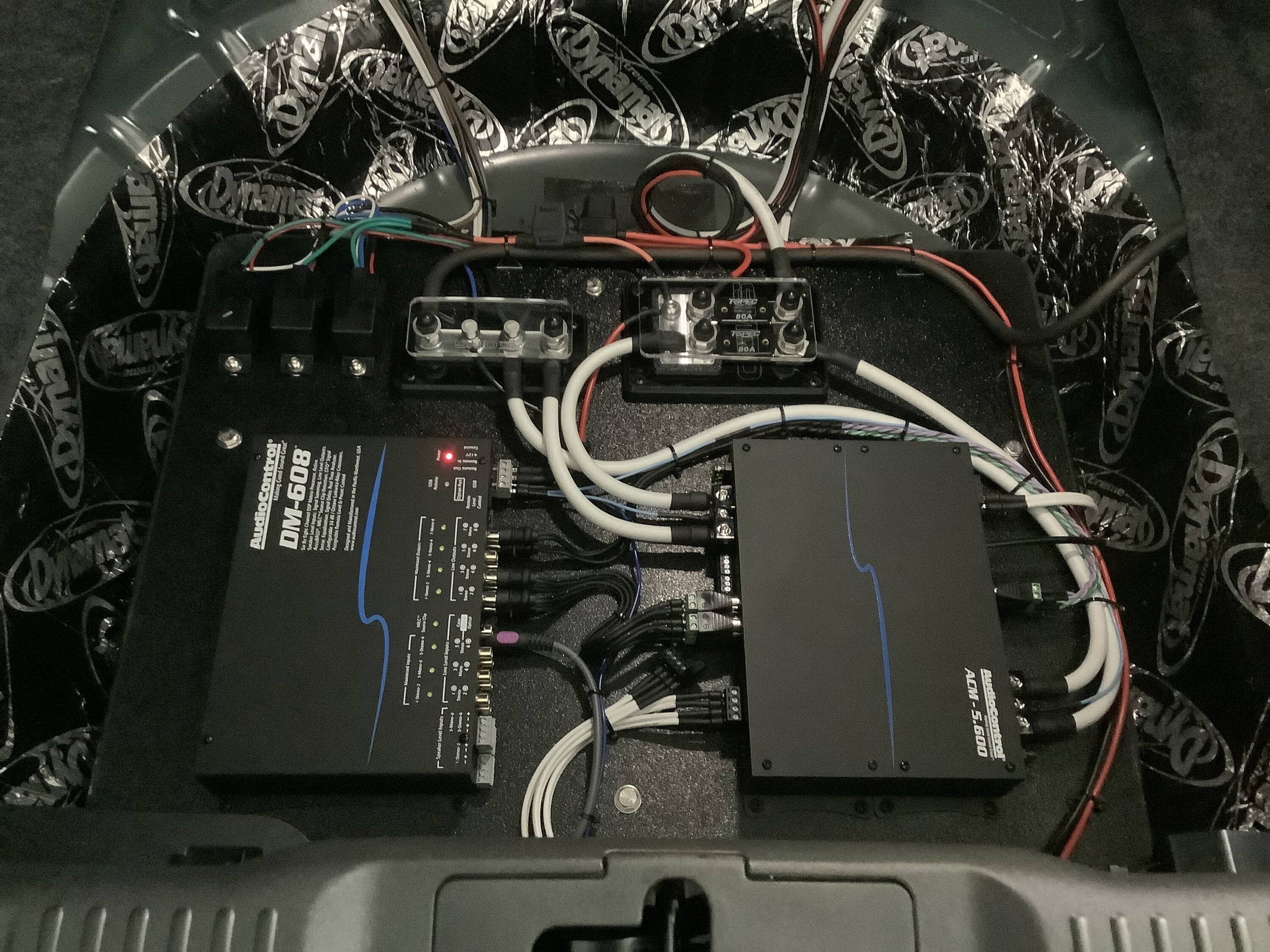

joe603
Feb 2, 2021
771
500
ATL
Joe
2021 GT Premium PP

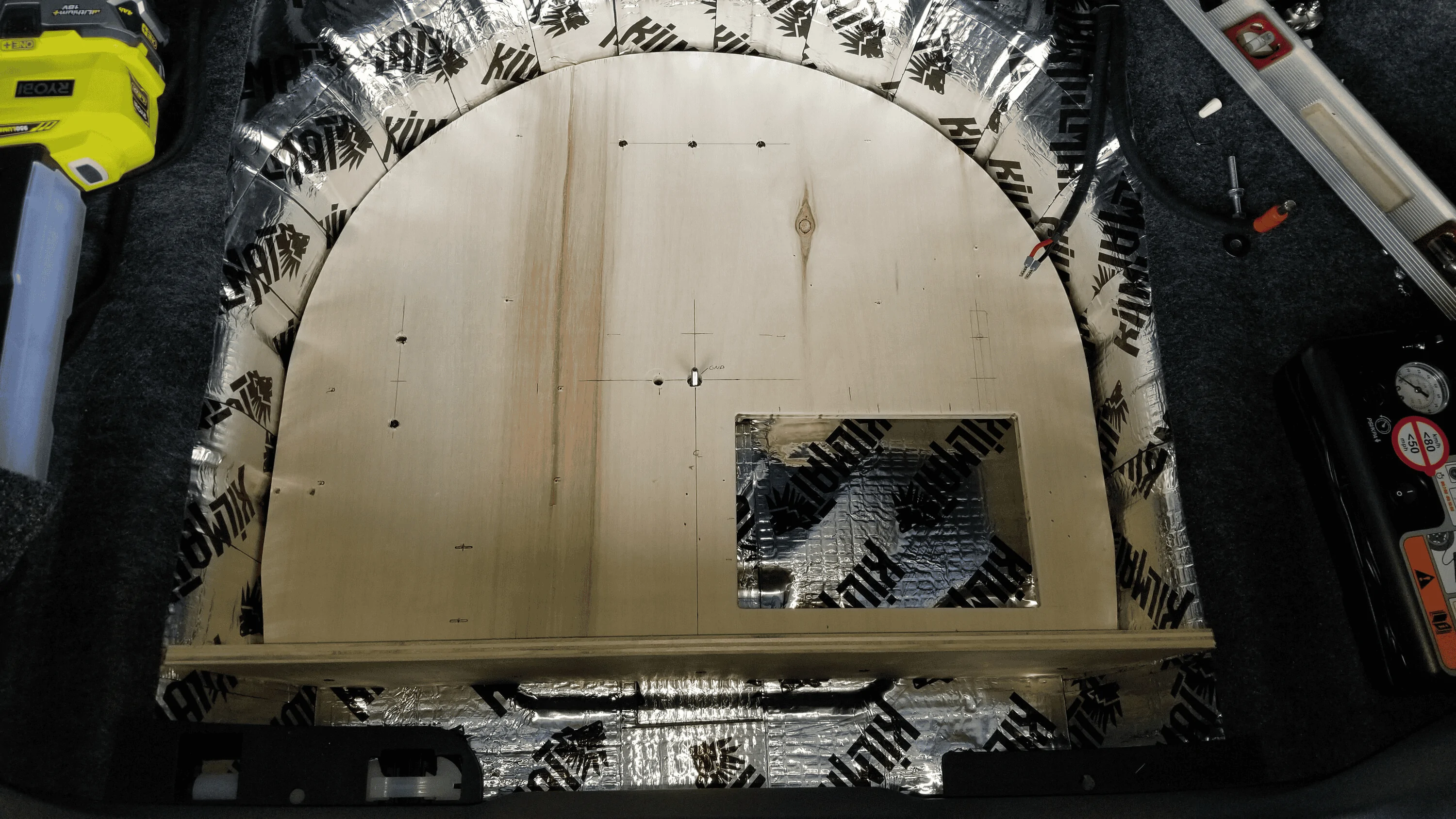

I did mine in the spare tire area. Took a wood board and started to mount the gear and run the wires...still a work in progress. Replaced the B&O sub with a pair of 12s and a pre-fab box made for the S550. Still need to replace the door and rear deck speakers and get a dsp...

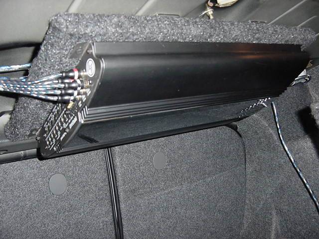

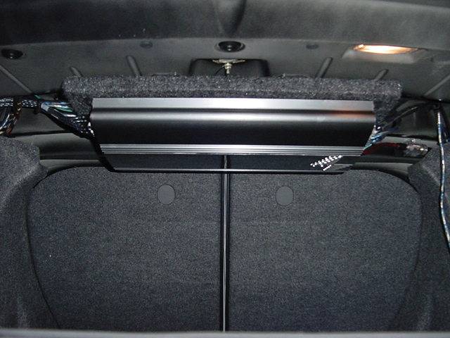

I dislike seeing wiring bundles or taking up trunk space …. Not that any upgrades posted here are not great, they’re excellent - but that’s just my personal tastes. I like everything stealth and hidden where possible.
If it allows, try to mount the amp(s) upside down to the under side of the rear deck. Then run all wires from the amp along the bottom of the rear deck and down to their respective L or R channels under/behind the L or R trunk wheel liners. Looking into the trunk you won’t see a thing UNLESS you were to bend down and look upward.
This is how my PPI 5440 is mounted in my 94 Cobra and also how the same amp was mounted in my prior 95 BMW M3. The only single wire coming down from the amp was the RCA lead that would plug into the sub box.
Here it is when it was in my M3 (don’t have any pics of it at the moment in the Cobra) and these images are after stooping down to looking up to getting the pics:
You also can’t see in those images, but on the back side of the amp rack are (2) integral mini computer fans I installed which draw hot air out of the amp. They kick on when the amp kicks on with the same turn on lead to the head unit. Never had any issues ever with clipping when amp is peaked….
I know it’s not an S550 install, but it’s just to give an idea where else Amps can be installed… :)

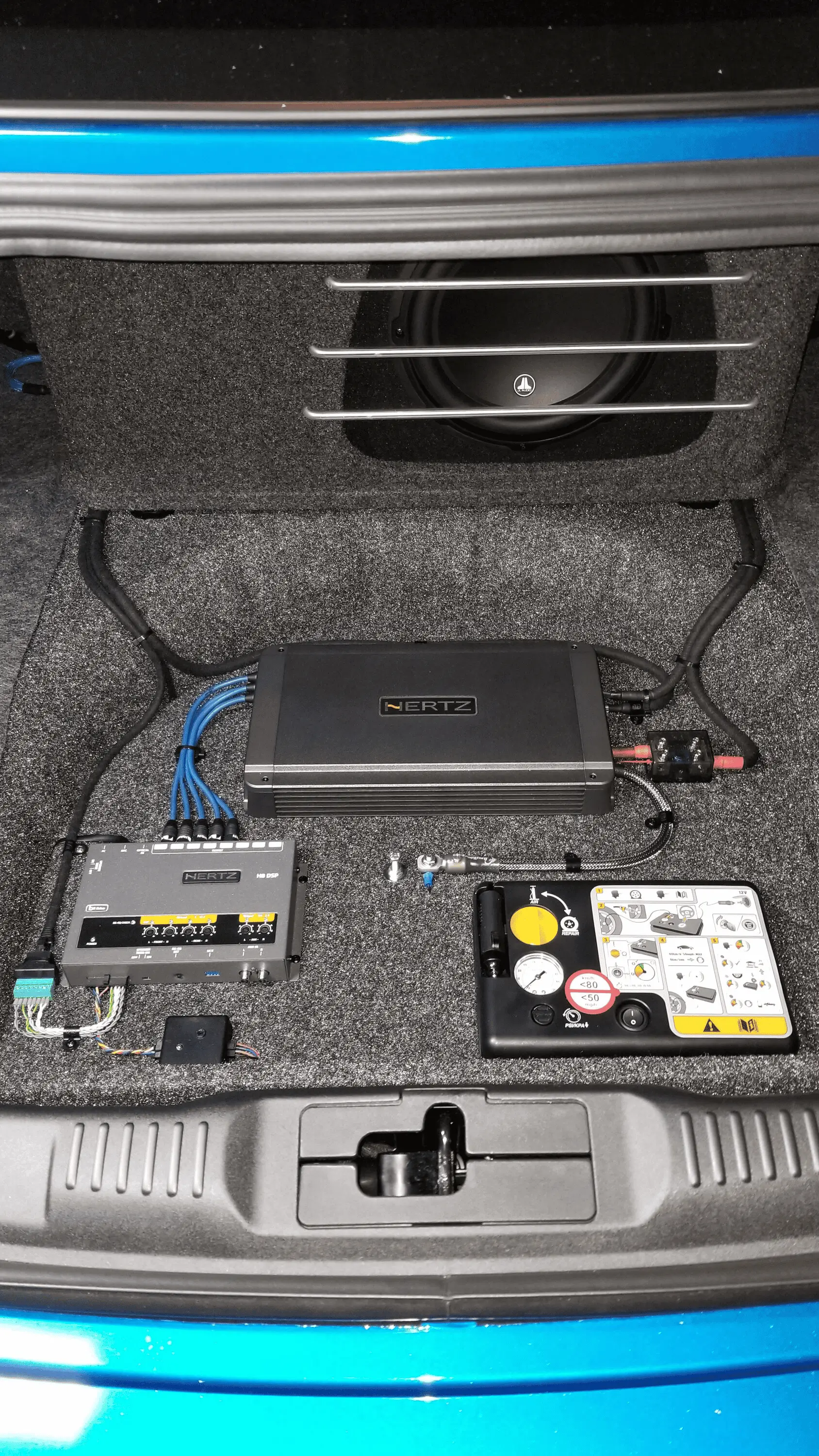

Another idea:
Evolvd
Instigator
Jan 19, 2015
186
6,881
5,895
Northwest Florida
Brian

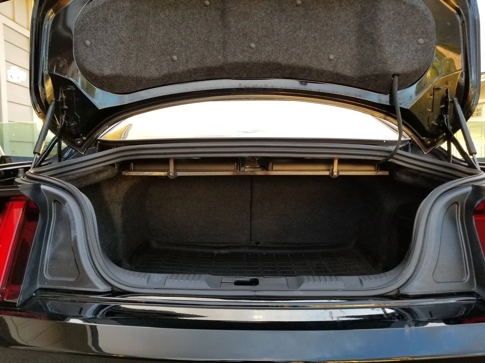

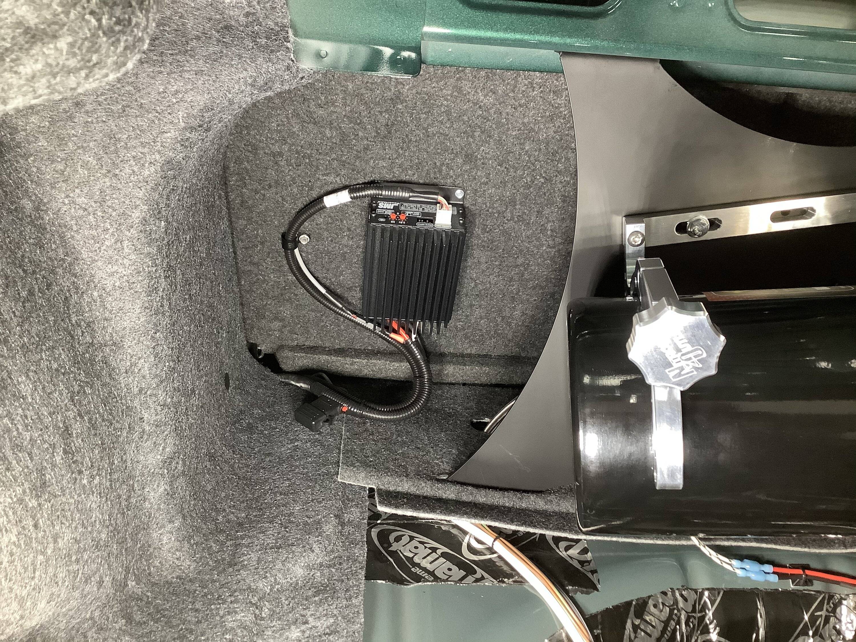

2021 Shelby GT500
Since my Shelby came without a spare, and I’ve replaced the cigarette lighter negating the use of the inflator kit, I’ve done this. I have roadside assistance, I’ll be fine lol. (I still carry the inflator cause someone else will stop who has a cig outlet lol)
