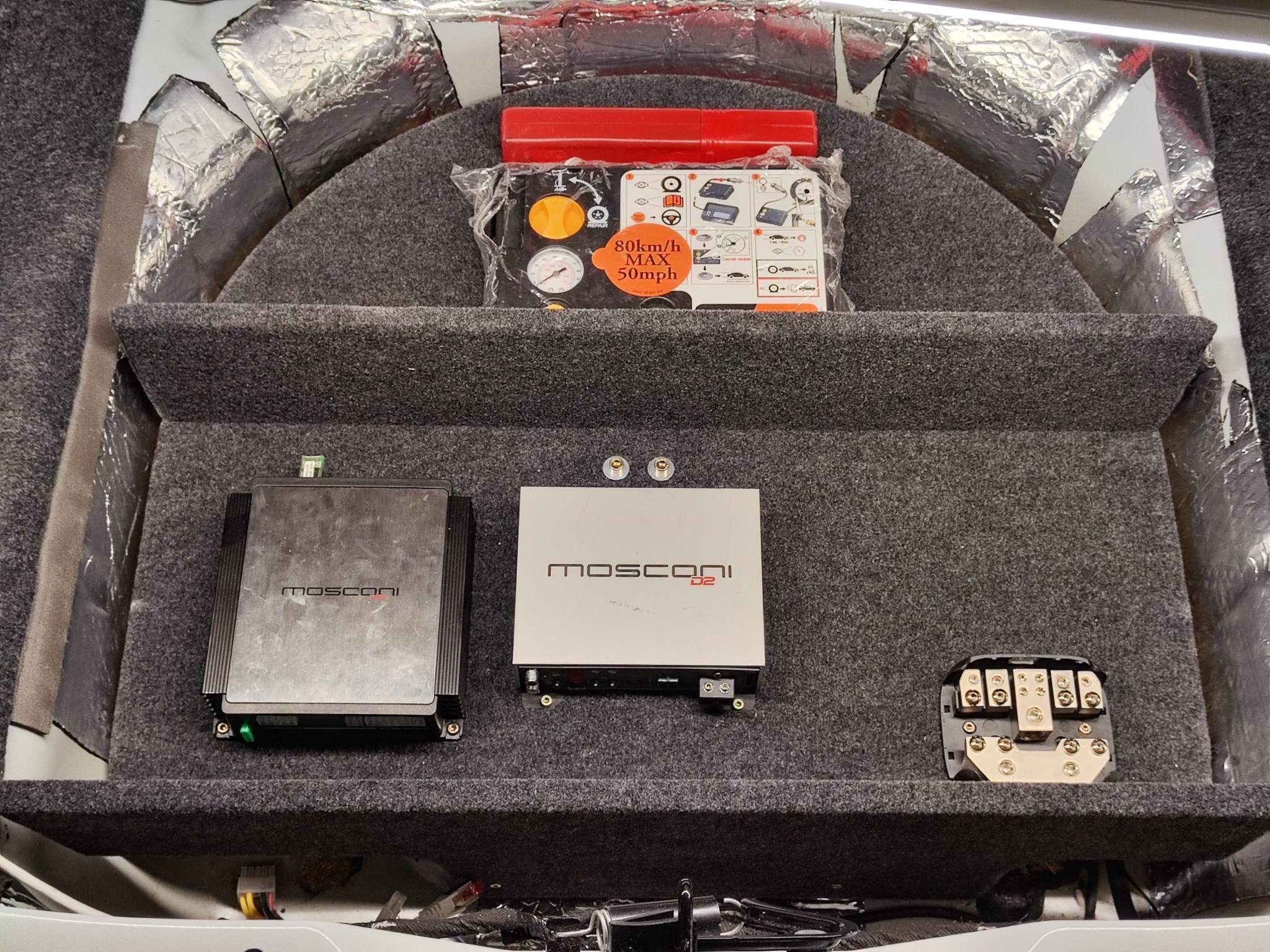

Preliminary picture as the new amprack is not 100% finished yet.

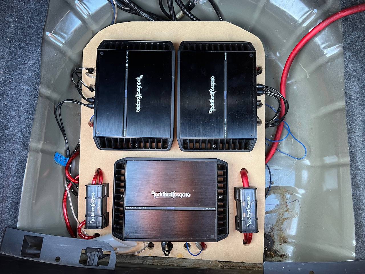

'15 GT PP, '16 EB PP
Just screw all your components to a roughly cut piece of MDF and toss it into the spare tire well, no need to secure it in place or do anything else to make it look better. At least that's the previous owner of one of my cars seems to have thought :cwl:
It blows my mind how people will throw money at a car in the worst way possible. This is just as bad as all those Honda Civic owners in the 90s who bought ugly body kits and slapped them on their car without bothering to have them painted….except that won’t cause a fire from shorted wires 🤣
Sad part is that it was a 'professional' car audio shop that did this, the car came with a bunch of receipts in the glove box. I may have been too harsh on the previous owner, likely that he didn't know better.
