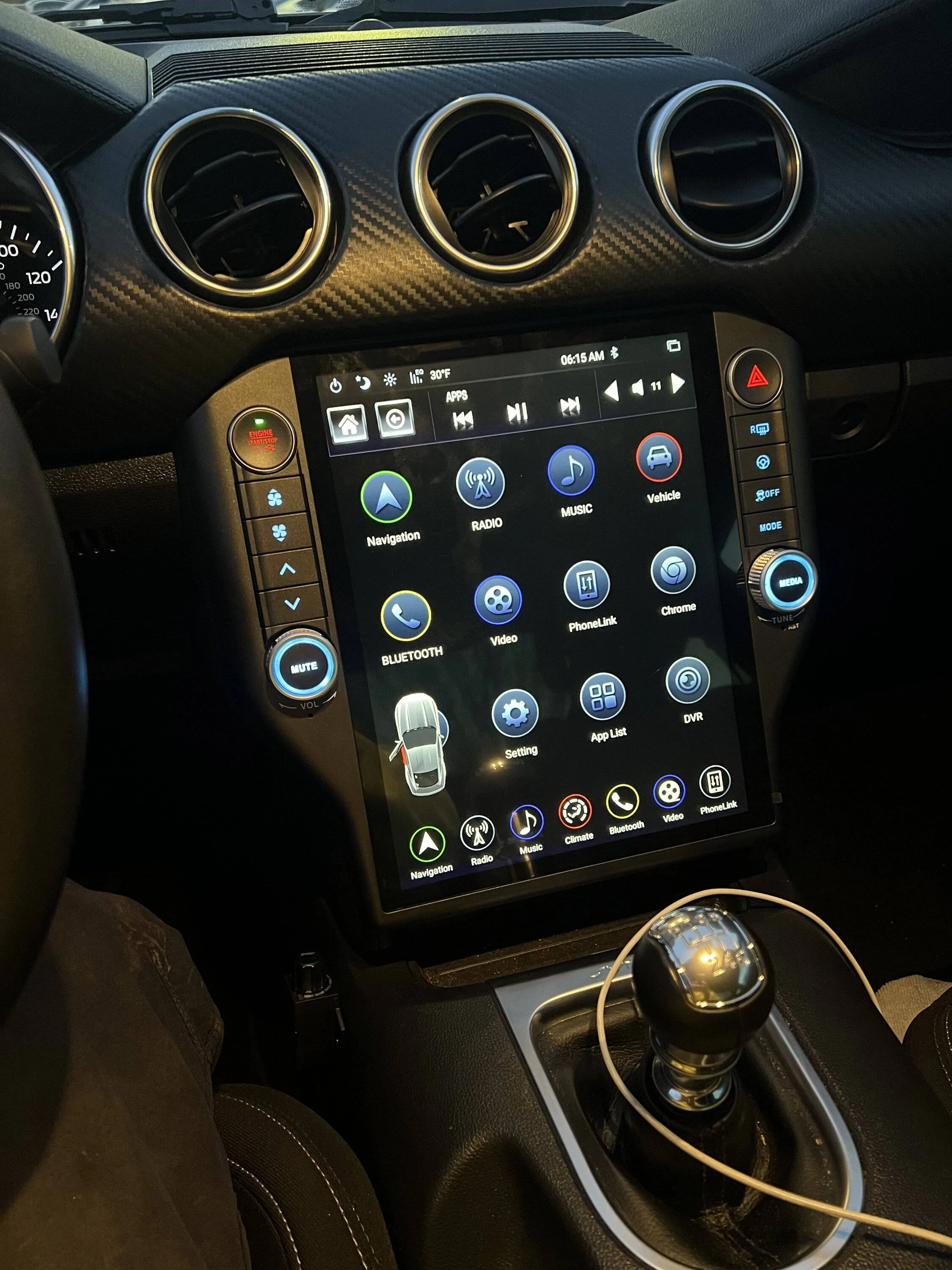

idatalink RR, idatalink MFT1 (for 8 inch radios) or idatalink MUS2 (for 4 inch radios) and a headunit of your choice....
Keeps factory HVAC controls, put HVAC controls into idatalink enabled radios and stuff.
Expensive? Yes, but retains all factory functions.

The integration devices can be used with Kenwood, Sony, Alpine, Pioneer and enable these radios to provide the same functionality as the stock radio and even more.

I already replied to you with that answer, Dynavin.
As Cathul said, there’s plenty of options to integrate aftermarket into our cars or to build upon the existing setup. There’s really no need to remove the stock 8” screen when you have the Maestro or PAC Audio integration systems.

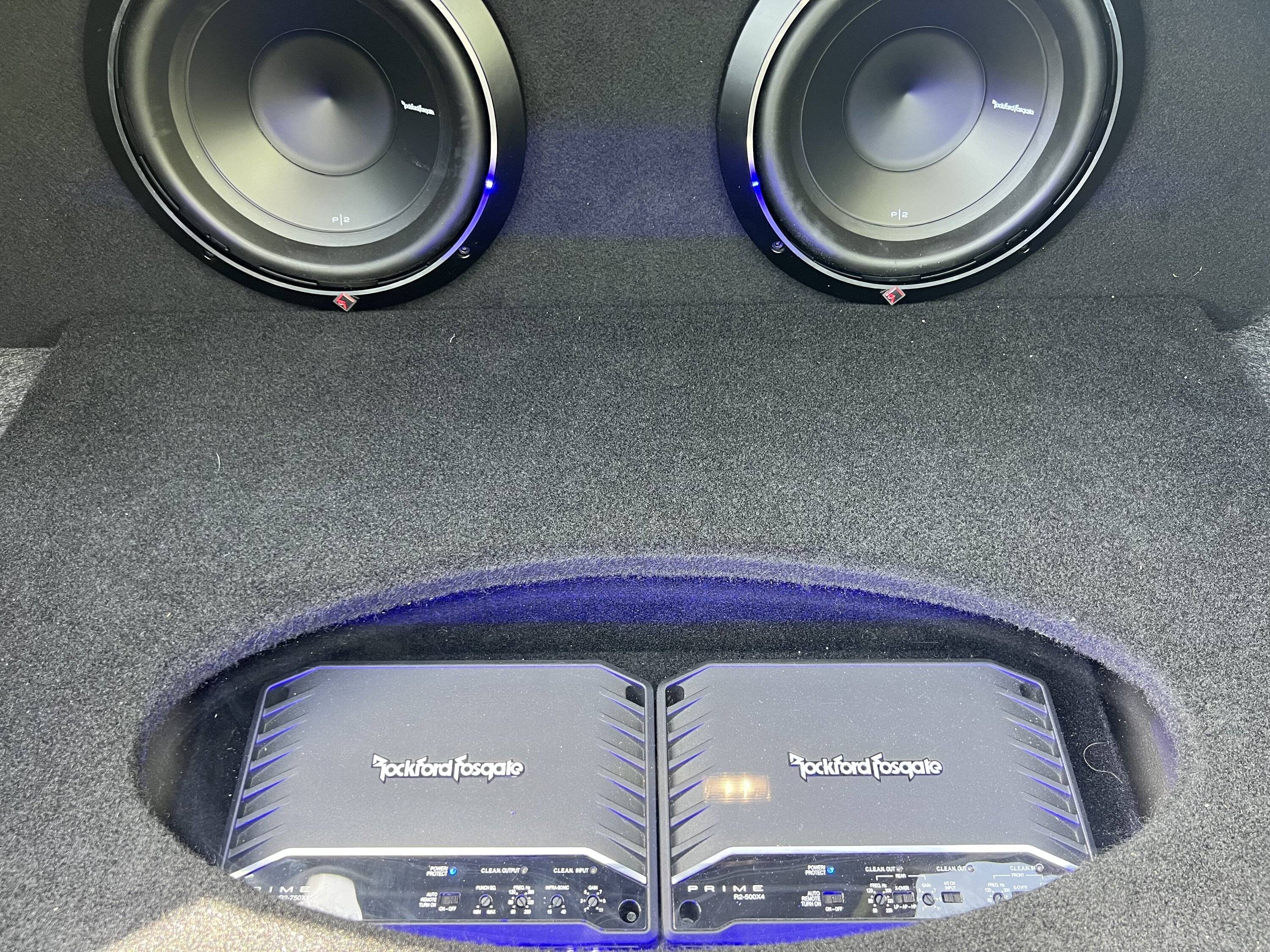

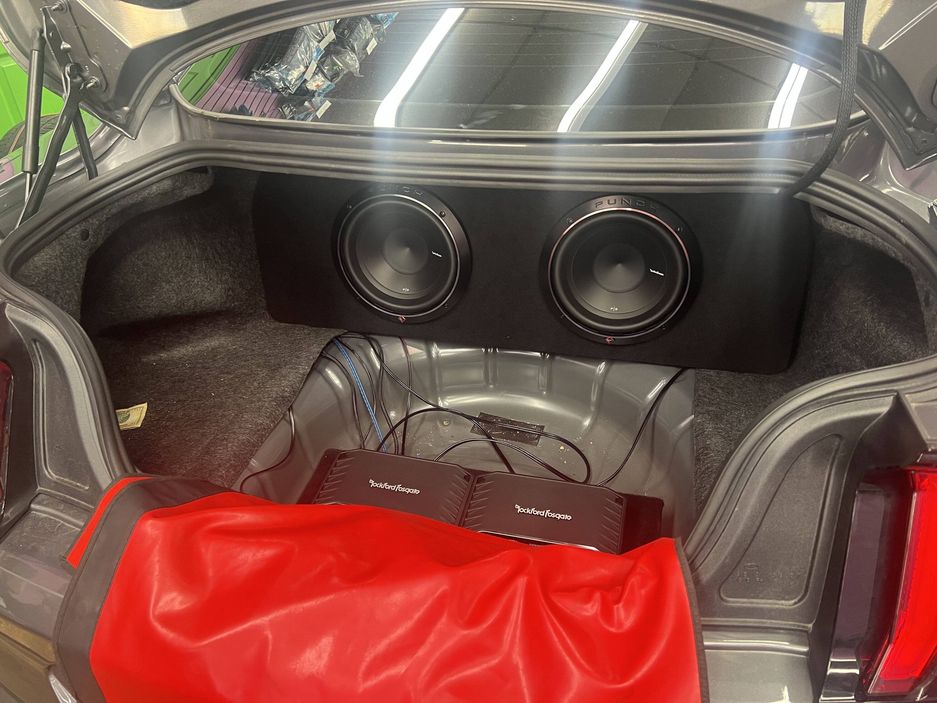

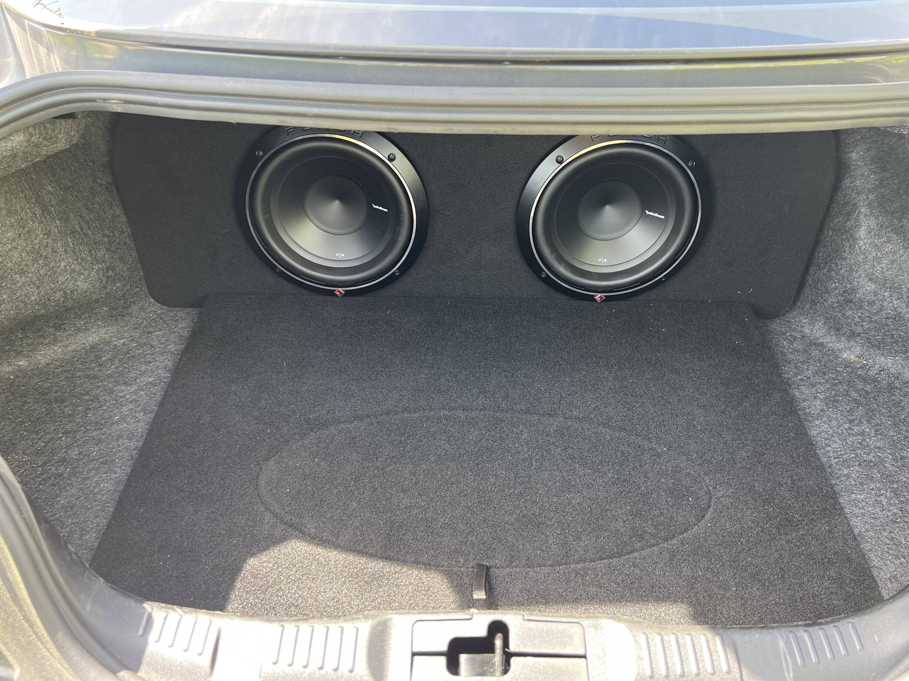

Mounted mine in the spare tire area. Installed carpeted wood so I still have functionality while I travel to and from work
