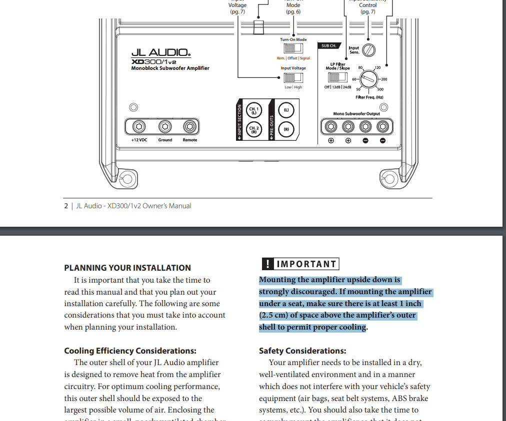

NOTE: Where ever you mount the Amp Remember, "DO NOT" Mount AMP Upside Down. This is a Big No No For Amps. Good Luck

Why? Heat dissipation?

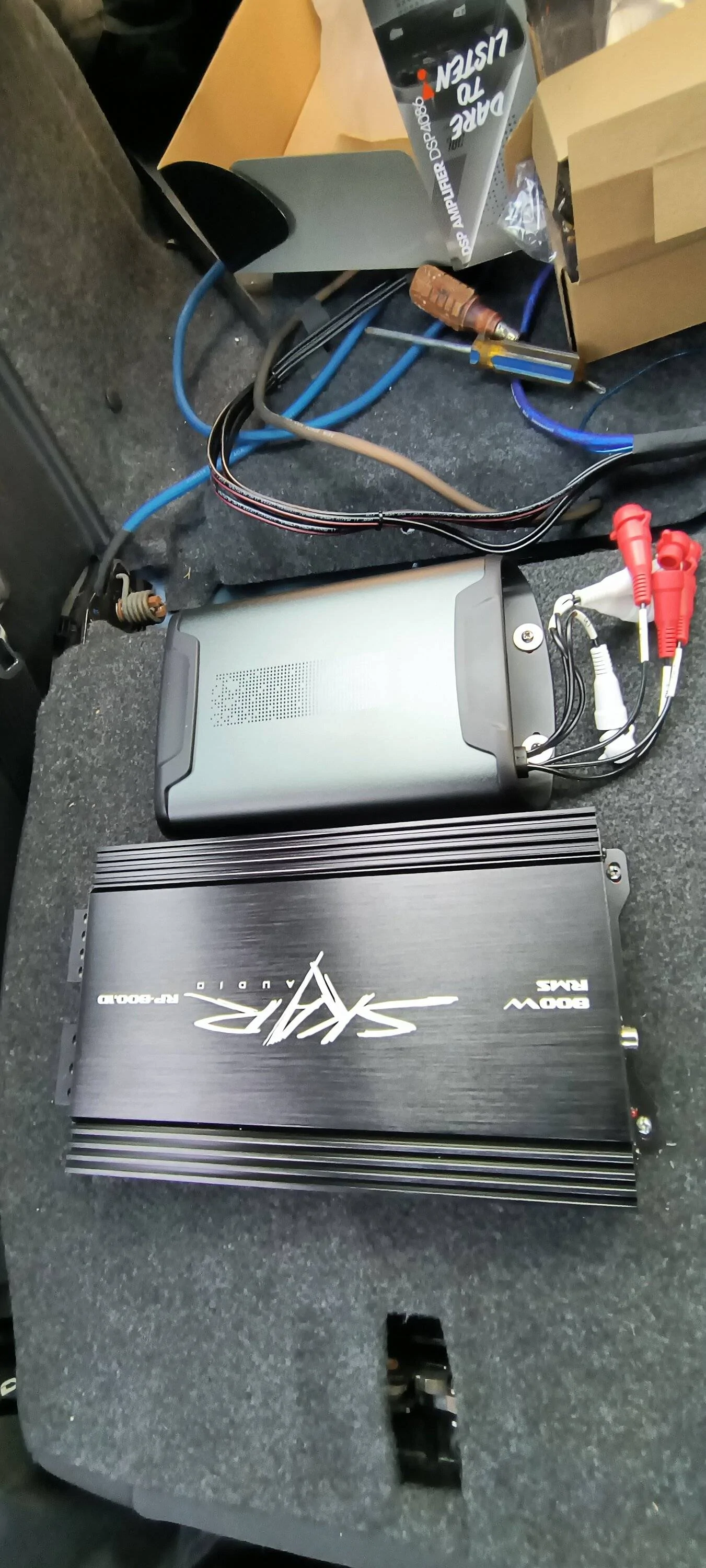

Thanks to everyone for the replies. I went with the seat backs, as it seemed the most straight forward way. Marked the amp locations with a sharpie then drilled small pilot holes with a tiny drill bit. Just need to figure out the wiring, mount the distribution blocks and decide if I'm going to flip the Skar Amp around. It has RCA's on the opposite side as the power/ground. I bought 6 channel RCA's, so they need to be close. .
Trunk was still a mess from the retail packaging. Not nearly as good looking as the rest of your installs, but Tesa tape definitely helps. I'll be wrapping the rest after I connect the amps.
