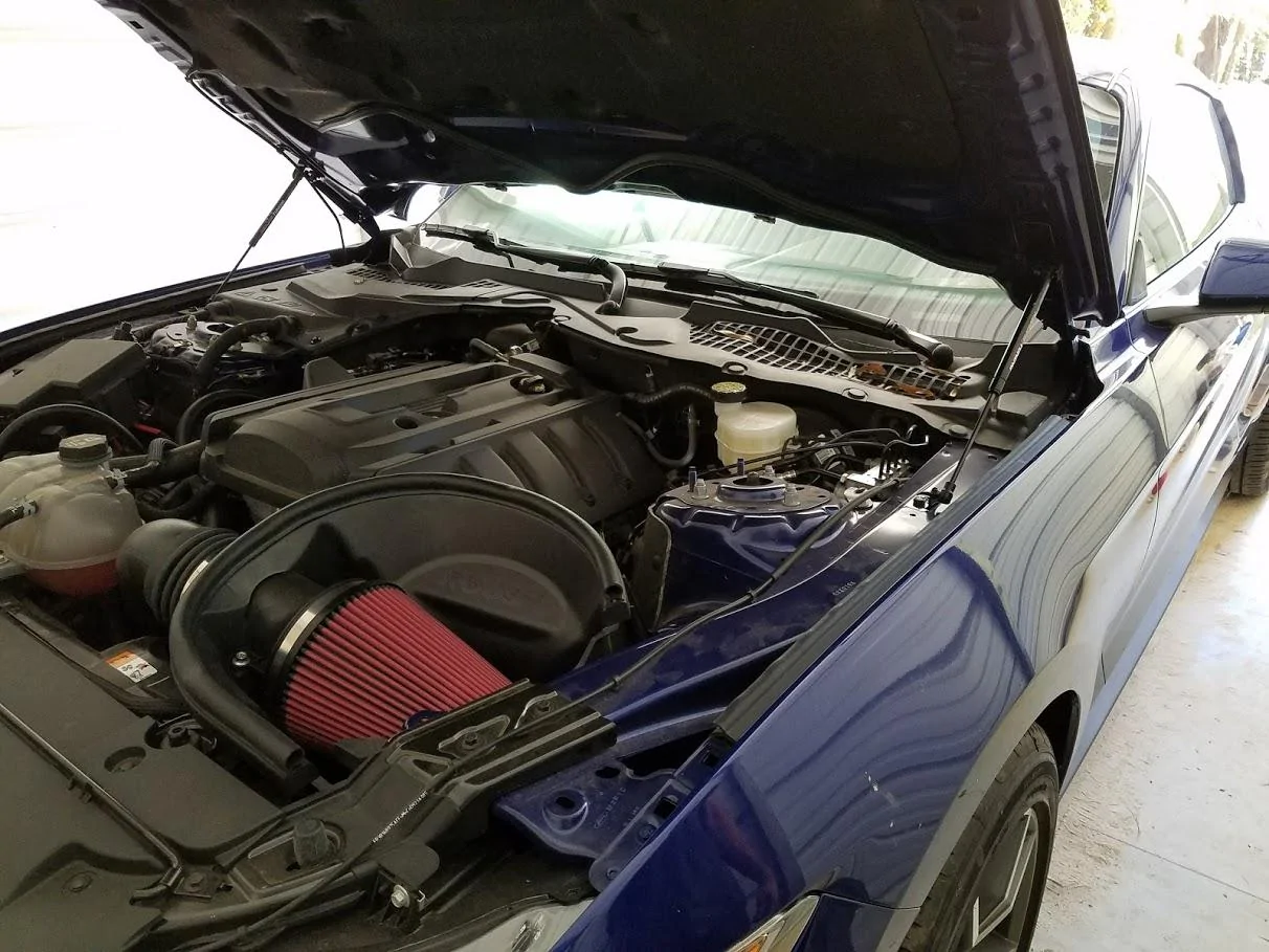

When we ended up with one of the mount ends not working out during install of the Redline, Andreas responded to me within the hour requesting our mailing address to replace the part. Both they and American Muscle hit me back quickly, part arrived, all is well.
Thanks Andreas, as a small business owner I know that in the end, it's service when you need it that counts. Loving the struts!
(and yes we did remove the prop rod after this pic was taken though)

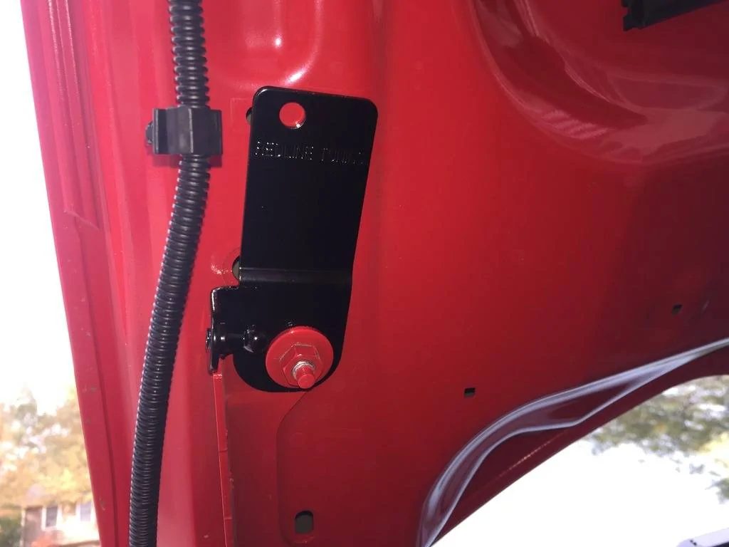

I purchased a set of Redline Tuning Quick Lift Plus struts via a reseller/sponsor on this forum. They arrived quickly and I began to install them. When I came to the alignment of the passenger side hood bracket, my experience was very much like that of [MENTION=19467]S550ilver[/MENTION] noted in this post.
http://www.mustang6g.com/forums/showpost.php?p=1406012&postcount=24
[FONT=&quot]Changing my hood installation position to make an add-on bracket fit was not my desire. A resulting visibly mis-aligned hood was not acceptable. I chose to modify the bracket (shown in picture attached). It totally escapes me why the bracket couldn't have been designed so as to fit ALL S550 Mustangs.
[/FONT]
[FONT=&quot] The installation seemed to work just fine for a week. After a 300 mile road trip, I opened the hood and found the the passenger-side strut popped off at the fender end and wedged between two parts of the fender. Please note that the problem was at the fender end NOT the hood end which I modified.
I removed all the strut parts and returned to my good ol Ford prop rod. I sent a detailed writeup and pictures to my reseller/sponsor. Their customer service folks worked for three days with Redline Tuning who simply, totally rejected any warranty ... or discussion.
Apparently Redline Tuning is perfect. They never make a mistake ... and their parts are never defective. It is really disheartning to not even be able to DISCUSS what the real failure cause is. Consider this before doing business with them.
Yea, I had to modify my hood bracket as well, and I got the same response: that they measured it from a perfectly aligned hood... blah blah blah.
The real fix is taking the step drill bit they provide, and widen the hole the windshield nozzle clip goes into.
It's still a quality product though, and I'd recommend it to anyone.
On Edit: I did not see post #74 so I have sent a PM to Redline. My apologies.
It is a quality made product, but...
As the OP I finally started to install the passenger side bracket and have the same problem with interference with the hood hinge. The bracket is not designed to take into consideration all possible hood alignment positions. A re-design that moves the ball stud mount toward the top of the bracket 1/4" would eliminate interference with the hood hinge.
I can not simply make the hole bigger, it doesn't even come close. The interference forces the bracket to be rotated to the right too far. I'm not too found of grinding my hood hinge either. What is the proper fix for this?
Grind the edge of the hood strut bracket where it contacts the hood hinge, and touch up the bare metal with black paint. But yeah, if the hood strut bracket was designed to give more room for clearance in that area it would be better, and not show up like this for some guys.
No need. Andreas has already PM'ed (on a Sunday even) and is taking care of things. I can't say enough about the level of customer service witnessed in only a couple of hours. Did I mention it's Sunday?!!!
