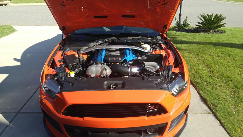

    redline. even work on aftermarket hoods...oh and my car will be at their booth at mustang week!

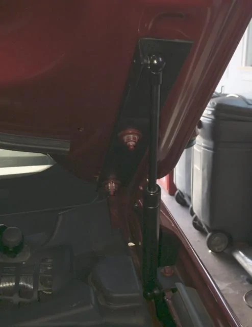

    I was torn between the Redline and the MMD's.
    I ended up going with the MMD's and installed them today for 2 reasons, rather minor reasons:
    1) They sit back farther than the Redline and I like being able to have less of an obstruction toward the firewall, not like there is a need to do much that far back.
    2) They cost me less :)
    Downside:
    Since you are loosening BOTH bolts on the brace I advise that you carefully mark and measure your gaps and even mark the brace location with a Sharpee or a scribe so that you can match it back up later. It took me 30-40 minutes to get it back to where it was. Other than that it's a vast improvement over the prop rod! Prop Rod.jpg
