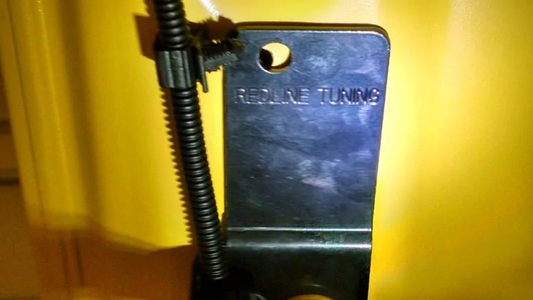

So I went out and messed with my hinge nuts on the passenger side and was able to get the bracket lined up with the hole. Everything was great till I closed the hood to see that my racing stripes no longer lined up. SHIT!! I tried adjusting the drivers side to compensate, and no joy. Doesn't seem to be enough adjustment to get my stripes lined back up. I had to go and put the passenger side back to where it was and the stripes are lined back up again. If I didn't have the V-series stripes with the tapering edges I would have just pulled the front section off and replaced those pieces. I don't want to have to buy another whole stripe kit just to replace that 1 little section.
Martman GT: Send me a PM with your contact info and we will figure out a solution to your issue. :thumbsup:

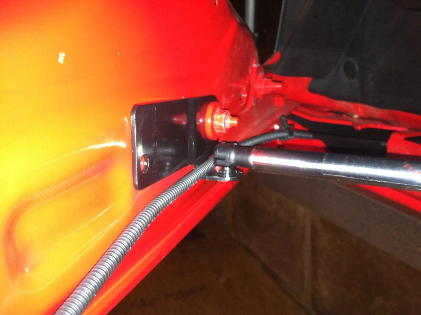

I have 2 O Reiily auto parts Hood Struts rated at 92 lbs each ..Fabricated 2 L brackets for the hood attachment points and 2 for the body attachment points ..these struts are great at holding the weight of the aluminum hood in position ..I am sure that the 2 1/2 inches afforded the L brackets I made helps ..
I have experienced no flexing of the hood what so ever ..these struts open the hood after a slight opening ..
I love em and shoot , I came up with this on my own ..No package deal here ..
Total cost $ 48.00
