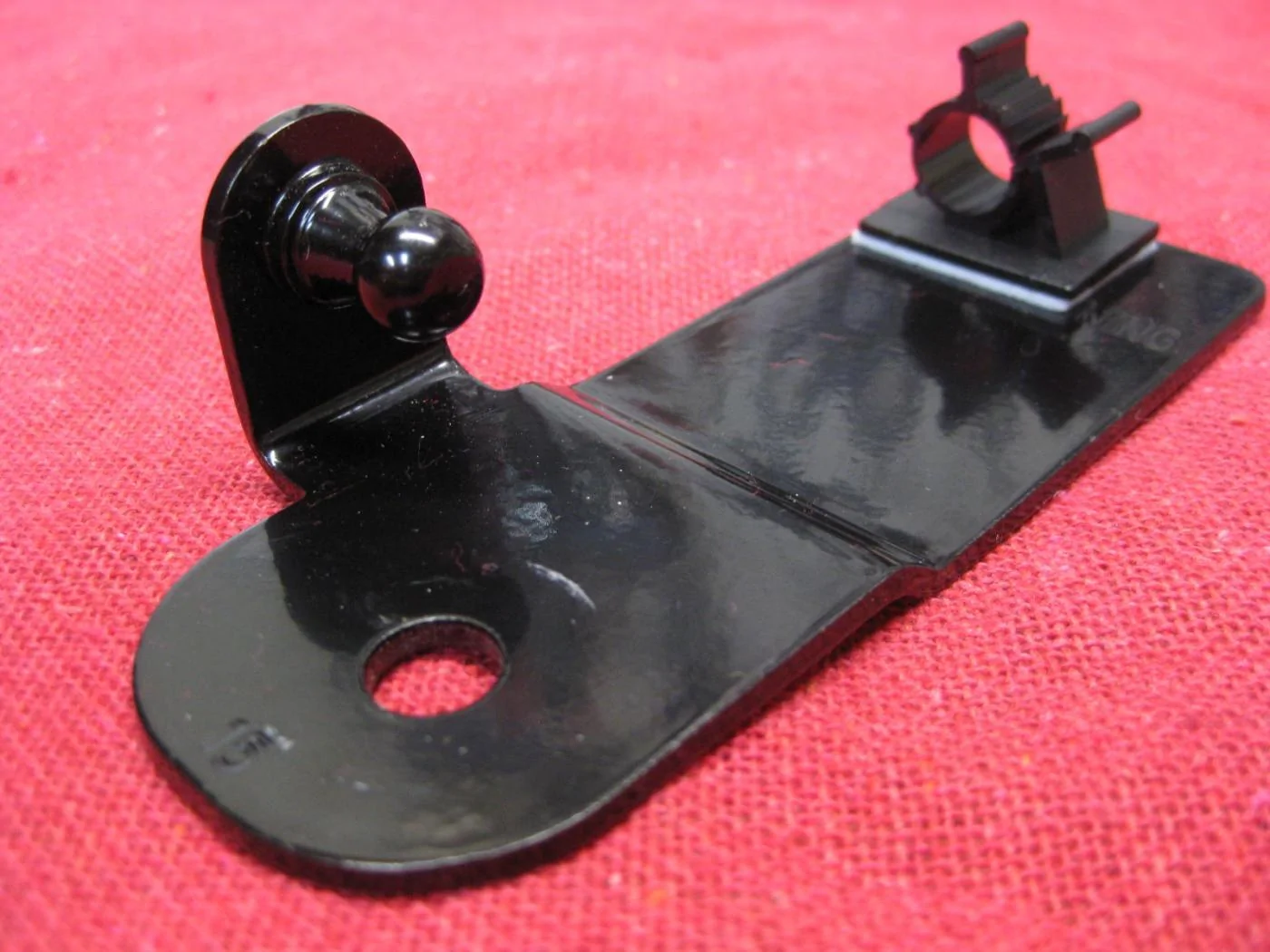

I used a different clamp.
I took a different approach to the 'problem'. Since the hole alignment for the hose clamp in mine was only slightly off, I removed the stock clamp and used a small adhesive-backed cable clamp at the same location. It works like a champ, and there was no need to return anything. Keep in mind that the hole mis-alignment in mine was slight, so I was able to live with the very slightly angled bracket that no one will notice. If the mis-alignment is way off like the diameter of the hole, then it won't look right. Anyway, it works and looks fine.
