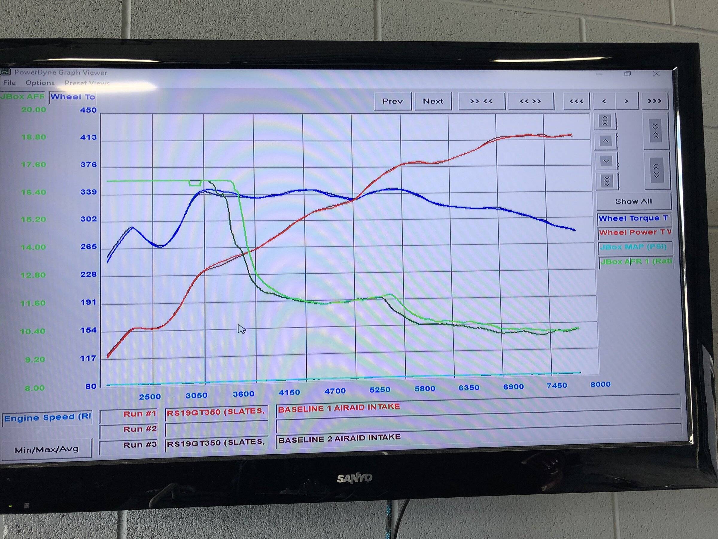

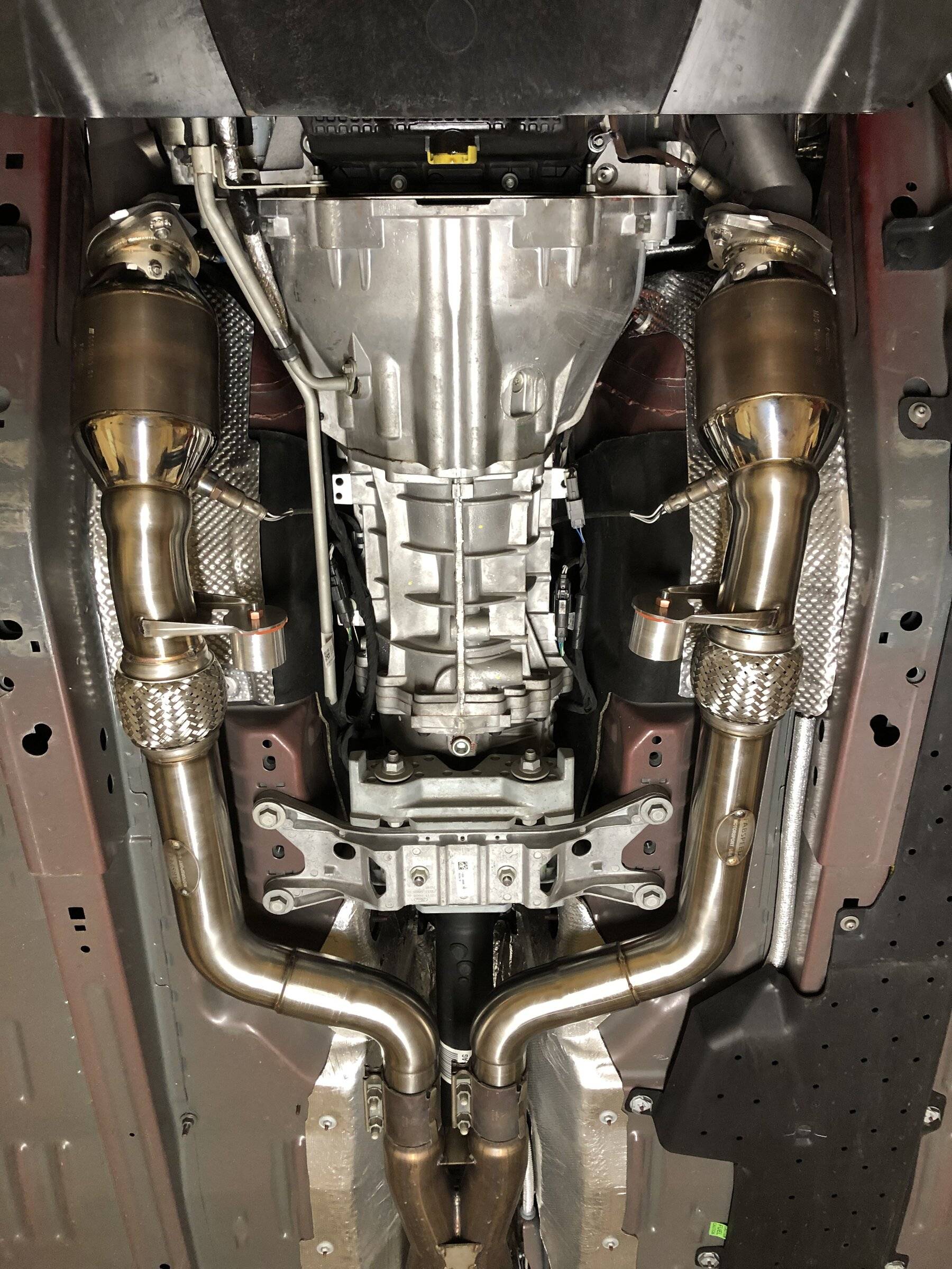

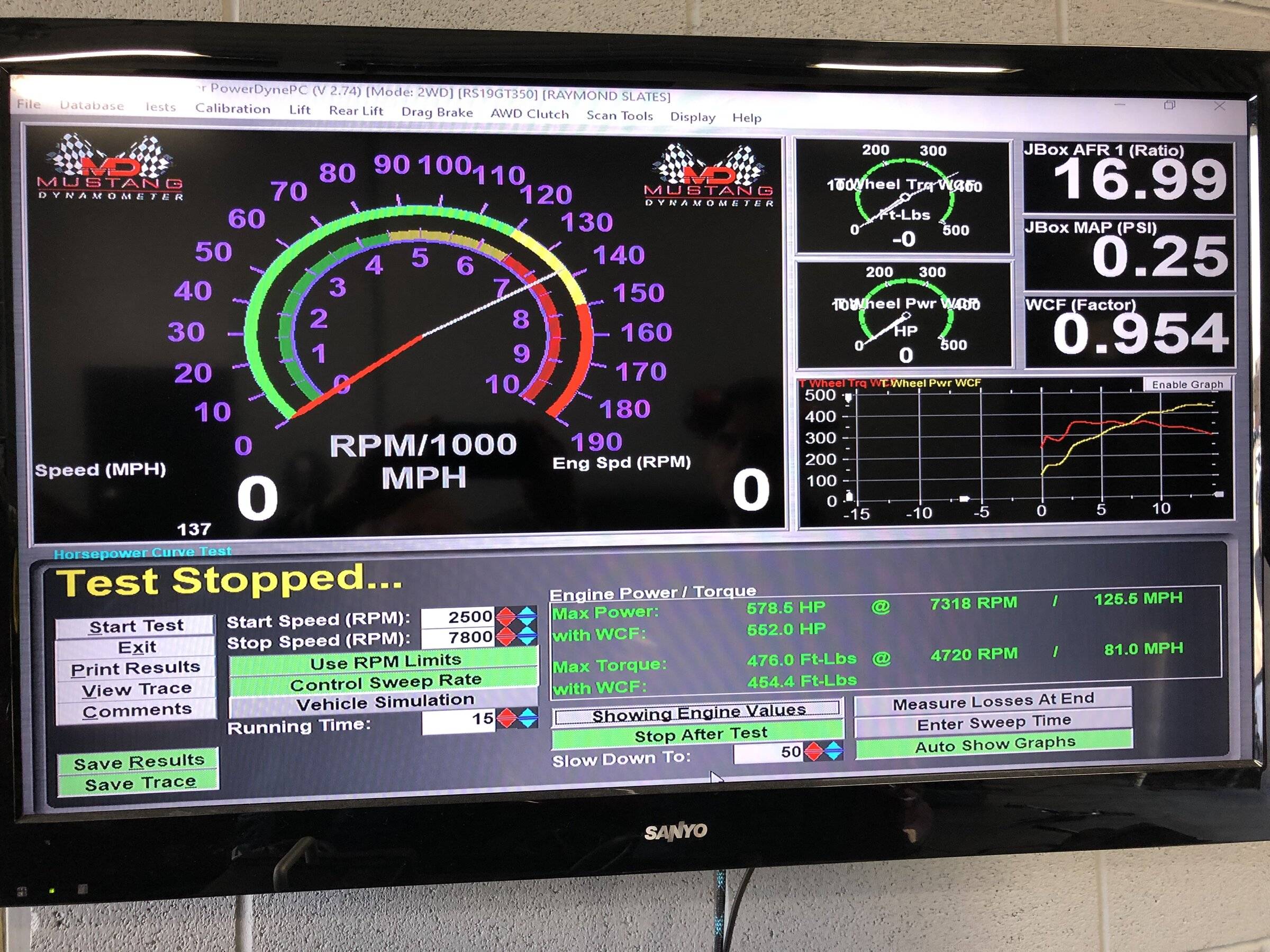

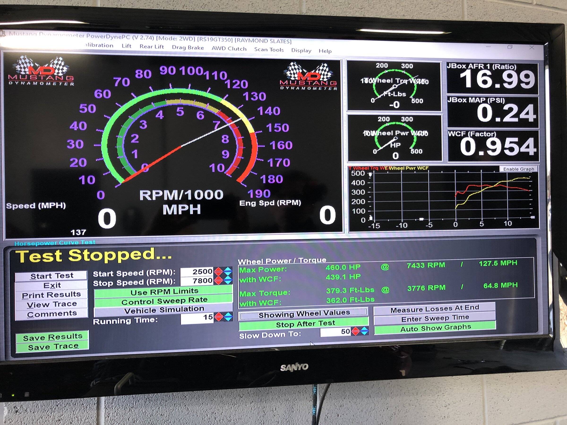

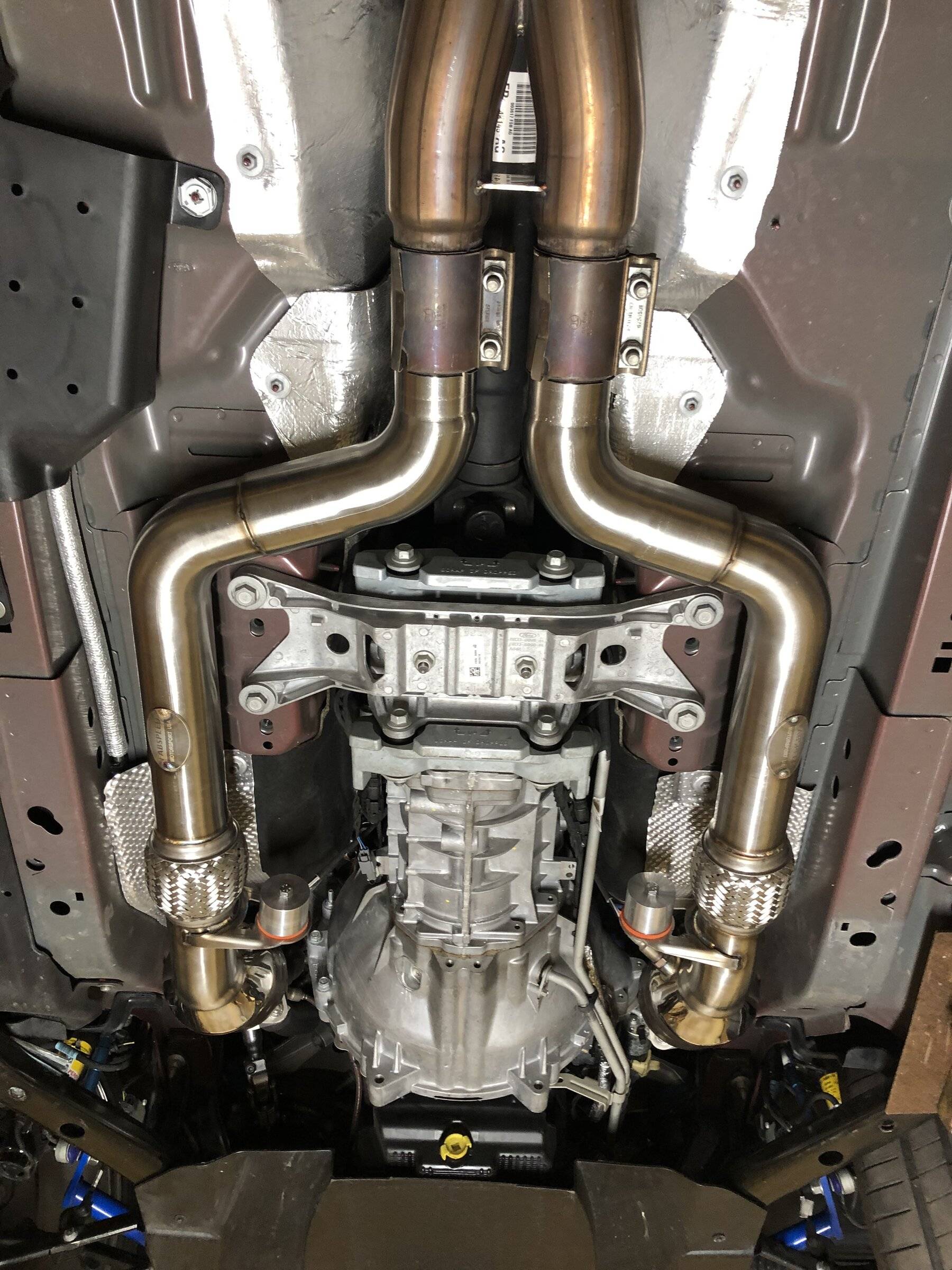

I had my car on the Dyno yesterday and in the “Stock” configuration ( I do have a lethal performance resonator delete X pipe). I am scheduled at 1:00 today for the run with my new “FABSPEED high flow cats installed. Changed them out last night, THEY SOUND AWESOME !!!

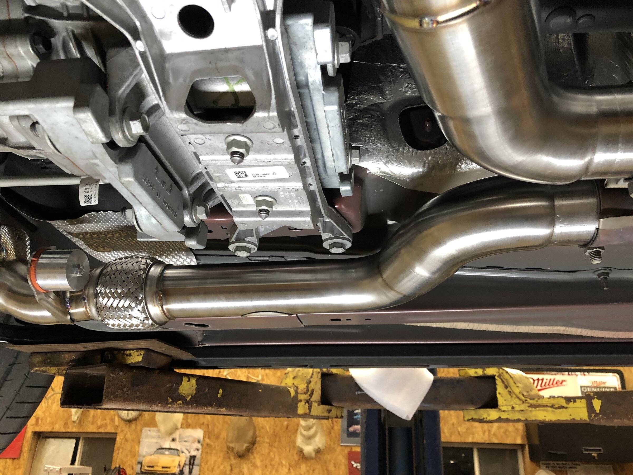

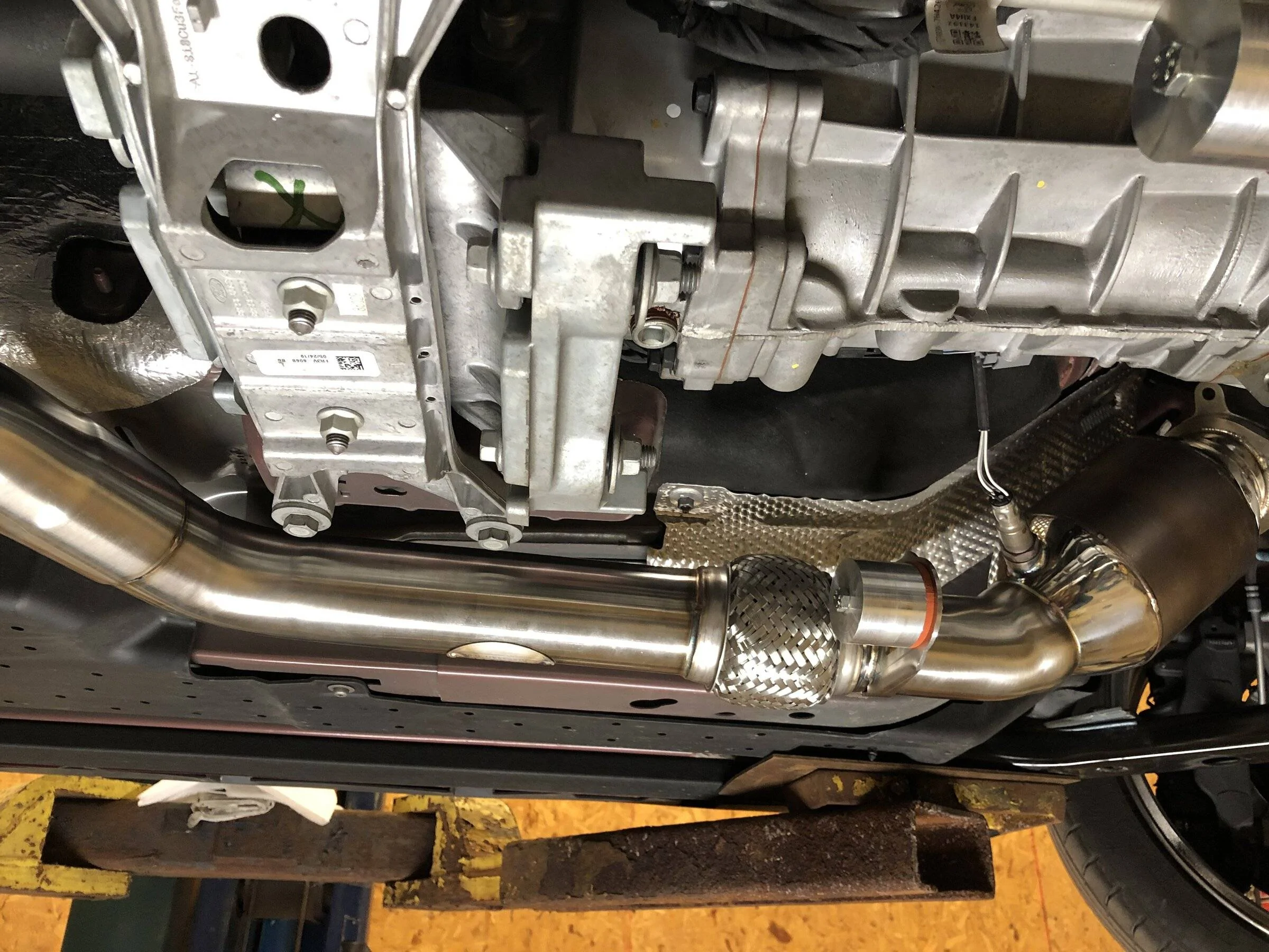

Nice perfect fit, definitely a quality product. I think that they fit better than factory.
And I would like to have a discussion with the engineers from Ford who designed that setup. What a pain to get the old ones off…..especially the passenger side. You better have 3 feet of extensions to get that one off…..
The car was running “Rich or Fat” on the big end, that’s what the green line indicated on the first chart

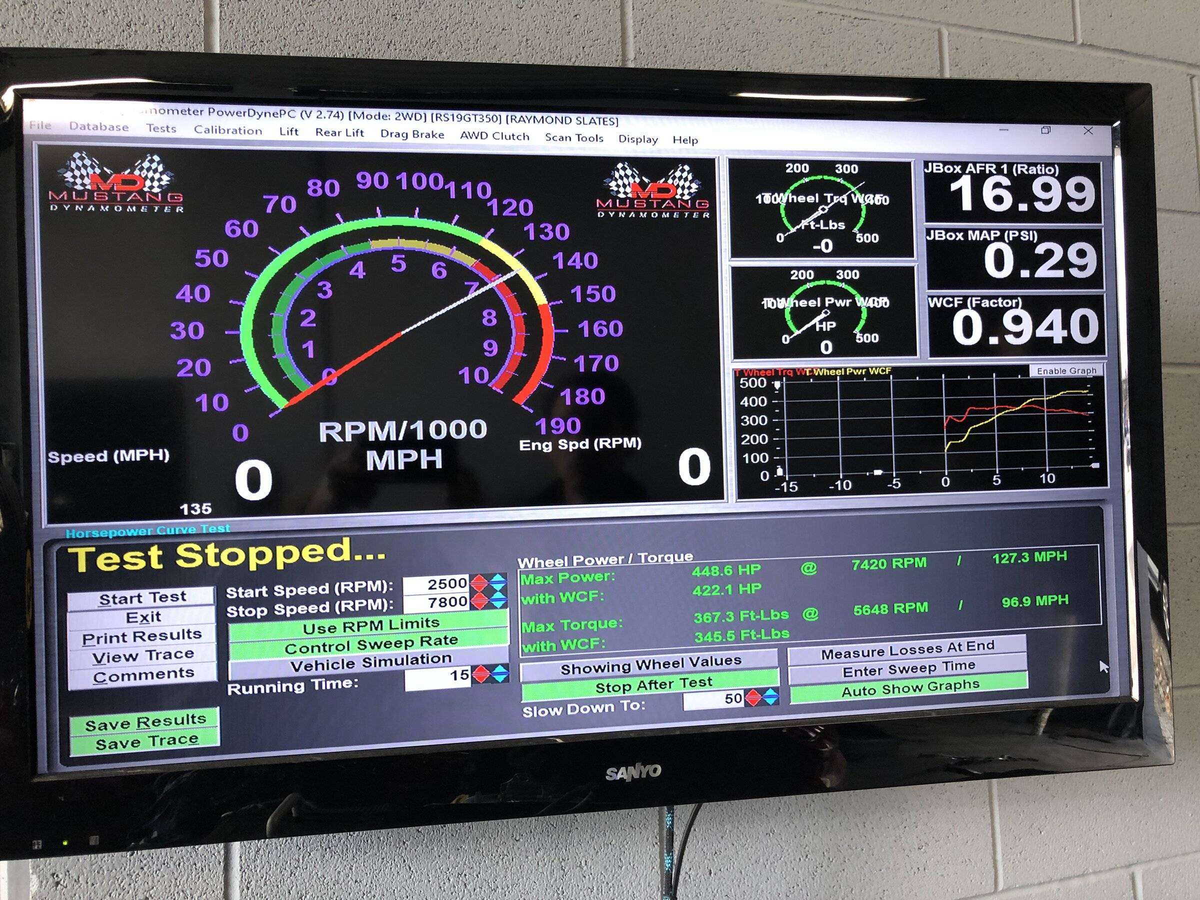

Cool! What does "with WCF" mean? Also how do they compute the engine HP and torque. Seems like they are estimating a ~20% drivetrain loss?
I think that it has to do with the temperature, air density, atmospheric conditions that effect HP. But I'll check when I go at 1:00 today, and yes the engine HP & Torque is a calculation. I guess they use 20% for a manual transmission, I'll see what they use for an automatic transmission

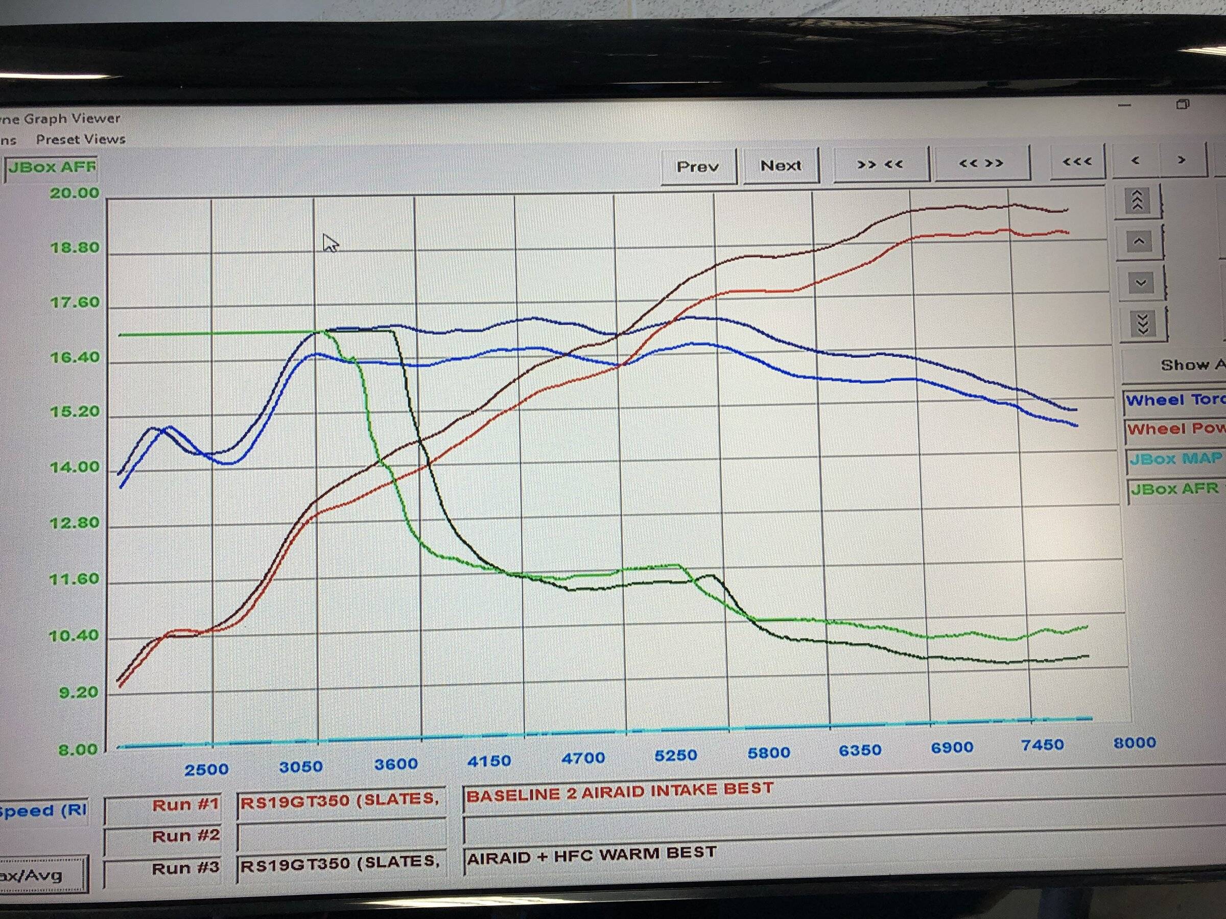

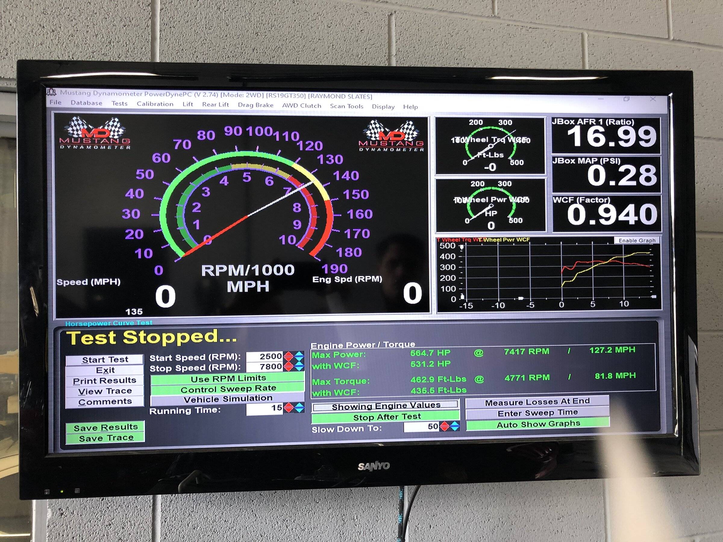

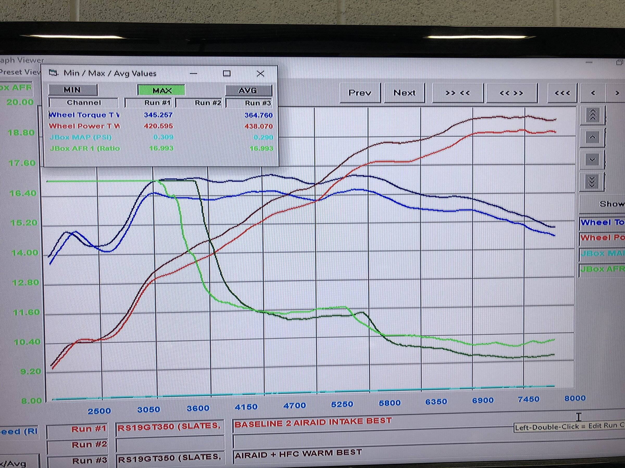

Ok guys here are the results in a nutshell, the difference in HP & Torque for my GT-350 at as follows. The best number for Torque before Fabspeed HF Cats is 345.25, after installation best number is 364.76. Which equates to an increase of 19.51 ft pounds at rear wheels.
The best number for HP before Fabspeed HF Cats is 420.59, after installation best number is 438.07. Which equates to an increase of 17.48 HP at the rear wheels. All figures used are “WCF”, Weather Correction Factor. The way I understand those numbers that they represent like a say 80 degree day, certain air density and so forth to allow for an even standard comparison.
My actual numbers were higher because of “improved” air conditions (cold and dense).
Therefore higher HP & Torque numbers. Here’s the supporting information.
My car is still extremely rich on the top end represented by the green line.
