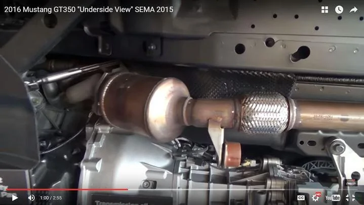

There are dampers on the headers as well. Unless the exhaust companies know the critical frequencies to properly place the dampers, any changing of the headers will degrade durability.
They're on the cat pipes, not the headers.
569c0fbc6336d_FORD_2016_GT350_UNDERSIDE_VIEW_07.JPG.347c6290591c18136ef381ee2d5cbb10.webp

2018 Mustang GT A10
Before the flexpipe, not after. So it will act as a dampener for the engine itself through the headers. Everything prior to that point is hard mounted.
Adding and or removing a fixed mass to/from the exhaust system will not effect vibration. It is there for other reasons.

That thing looks like it's attached to the factory exhaust, which I removed

I'll chime in here. I just did Kooks LT's on my 350 and I removed the vibration dampeners from the stock cats location and bolted them onto the where Kooks had designated on their headers.
Now another person with a R did not do this and he had serious vibration issues. So much so that the oil came apart and yeah you know how that nealy ended...Luckily it was caught just as he reached the shop.
I would not recommend driving the car without the dampers connected...unless your exhaust has some type of counter vibration built in or in the design of the headers.
