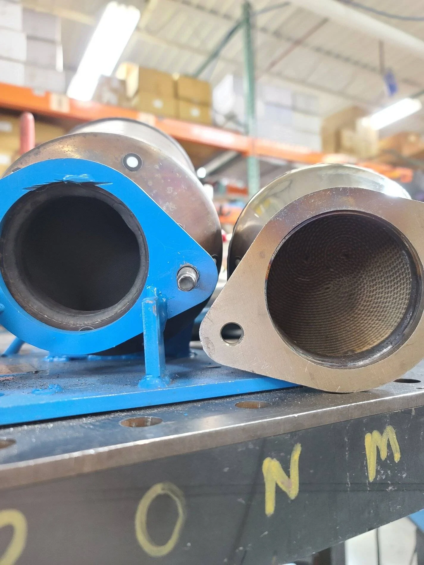

I'm not sure the exact catalyst B-Line or Kooks uses nor the power or size they support. I'm assuming it's a Gesi cat, which doesn't use the same wash-coating HJS German Cats do, but I could be wrong! Maybe someone on here knows.

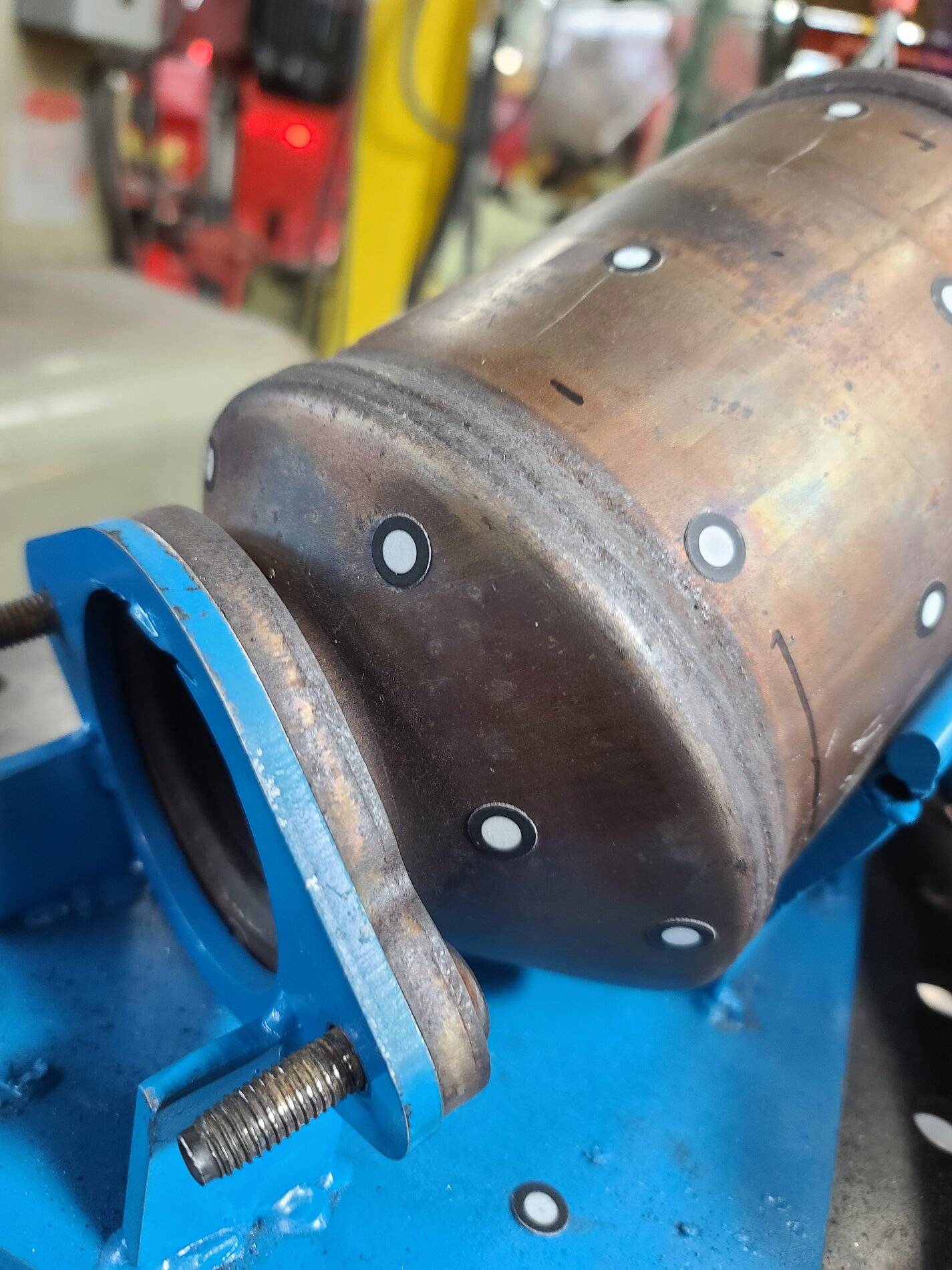

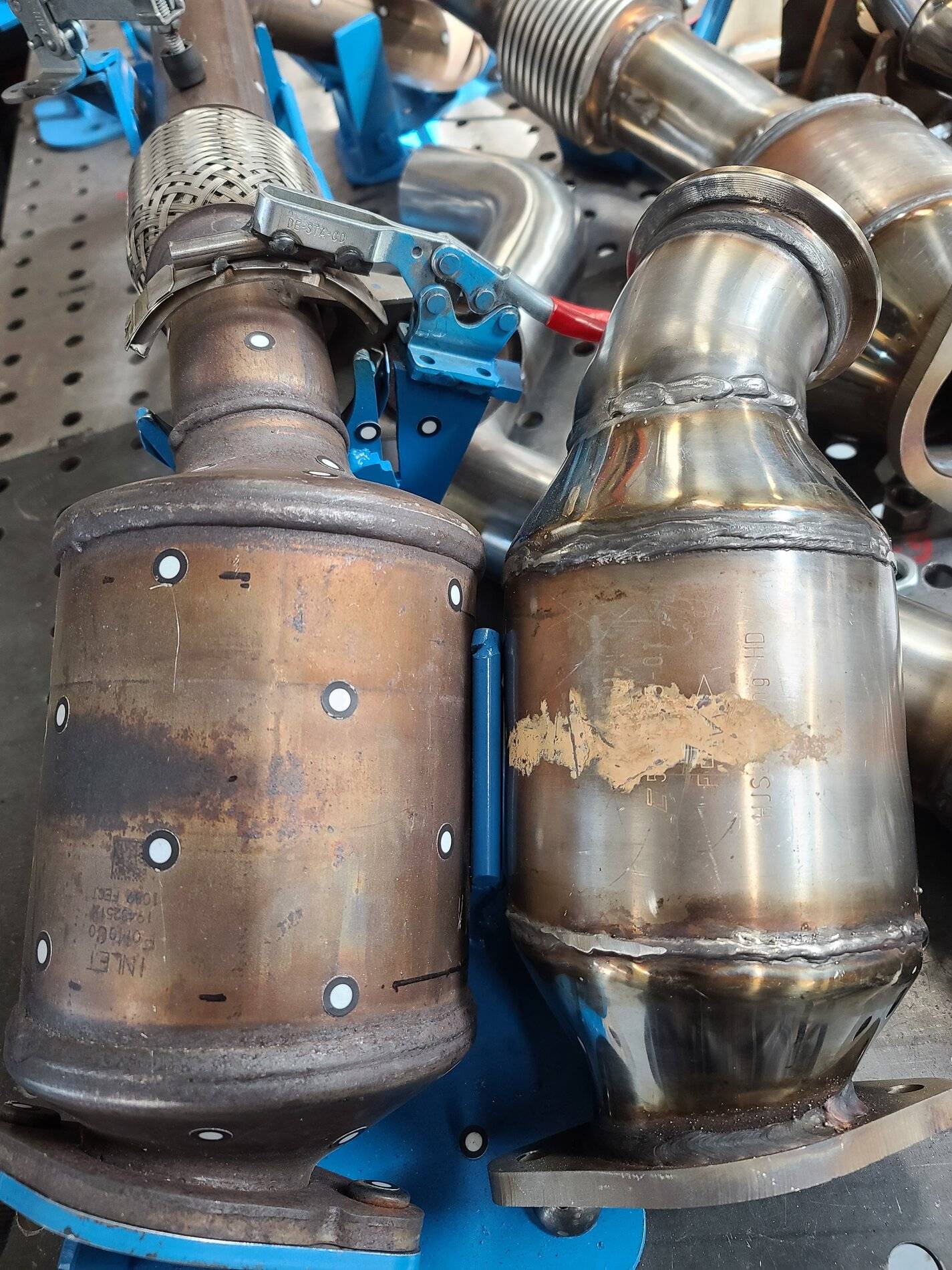

A good factor to consider too when they're looking to change out to High-Flow cats is the end-cap. It SQUEEZES the exhaust gases entering and exiting where it's still very limiting to exhaust gas flow. You can see below how restrictive the end-caps the OEM have compared to the Fabspeed high-flow cats.
Essentially getting straight pipe flow, very similar sound, but no fear of CEL/Tune.
OEM on the left HJS Cat on the right
