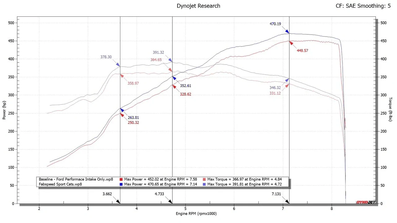

Probably should have asked you to weigh the stock vs the new ones. Guessing you don't happen to have the weight of each? Are you doing a before/after dyno?

^^^This. If we can get weights and a third person dyno to confirm the power numbers with someone from the forum then that would be great.

Notice any power increase?
I do notice a difference while driving, yes, albeit slight. Looking forward to some of the early adapters to get theirs soon to get other dyno comparisons - the DynoJet used on my car for figures was an all-weather dyno.

Oh you mean you're dyno was the one they used for their website?

I've seen a lot of stock dyno pulls of 350s and the red line looks to be 15-18 or so hp down compared to what I've seen. Will be very curious to see if anyone can replicate as I would expect to see 485-490 whp with a claim of +20 hp.
