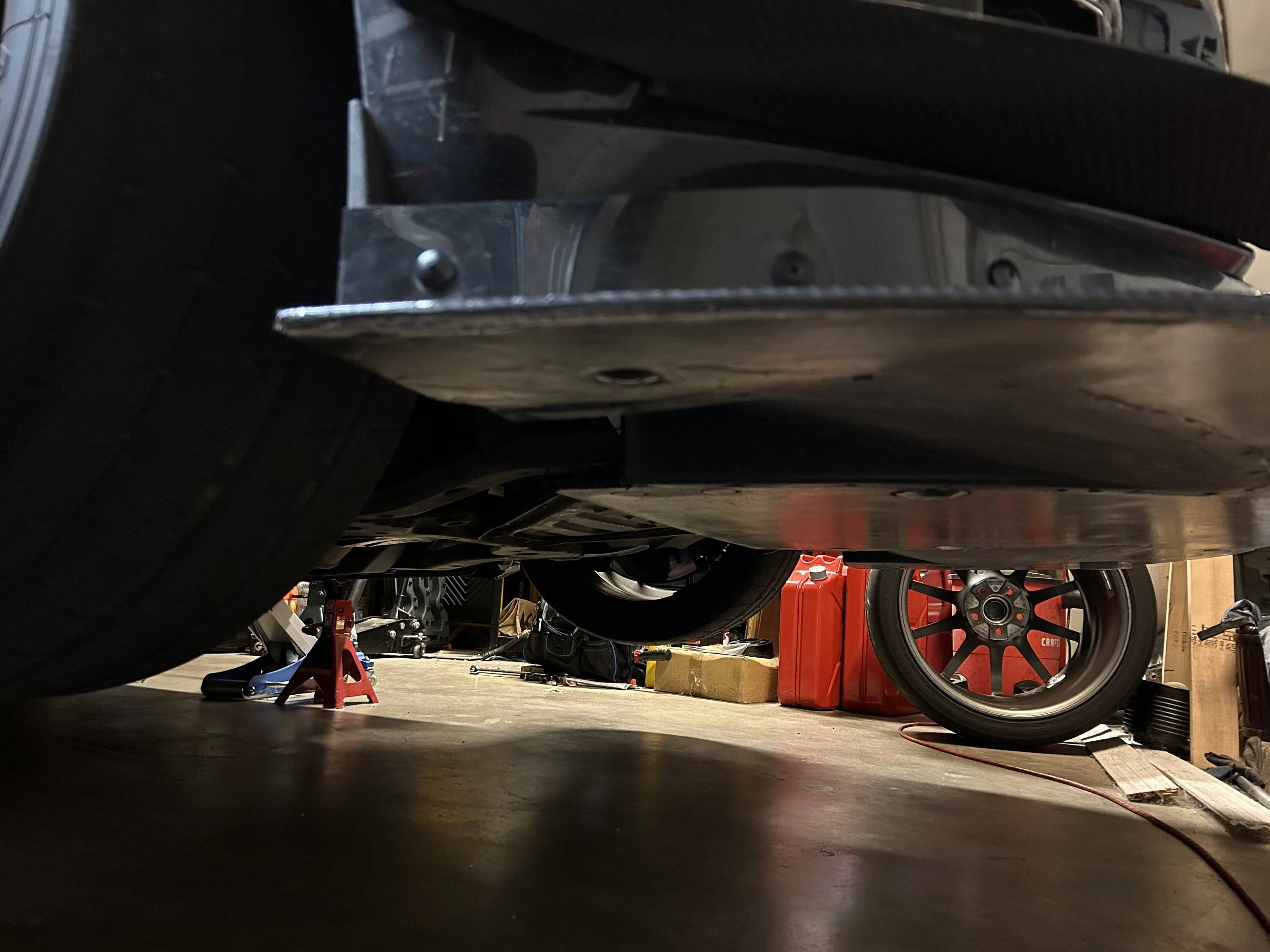

right. I used some Professional Awesome hardware (mounts, support rods, skids) as part of my solution. These days my quick detatch solution isnt so quick because Ihave to remove the stock undertray because I went with big splitter diffuser ducts.
MDO or marine grade plywoods are usually the goto. MDO is rigid but you need some thickness to make it strong. Marine grade is strong, but flexes more so more supports required. Both are waterproof.
for rear aero, a wing will likely be more effective. Nine lives racing has the more affordable bolt on options. You can spend more with AJ Hartman or other, but you’ll need a lot of front aero to balance.
