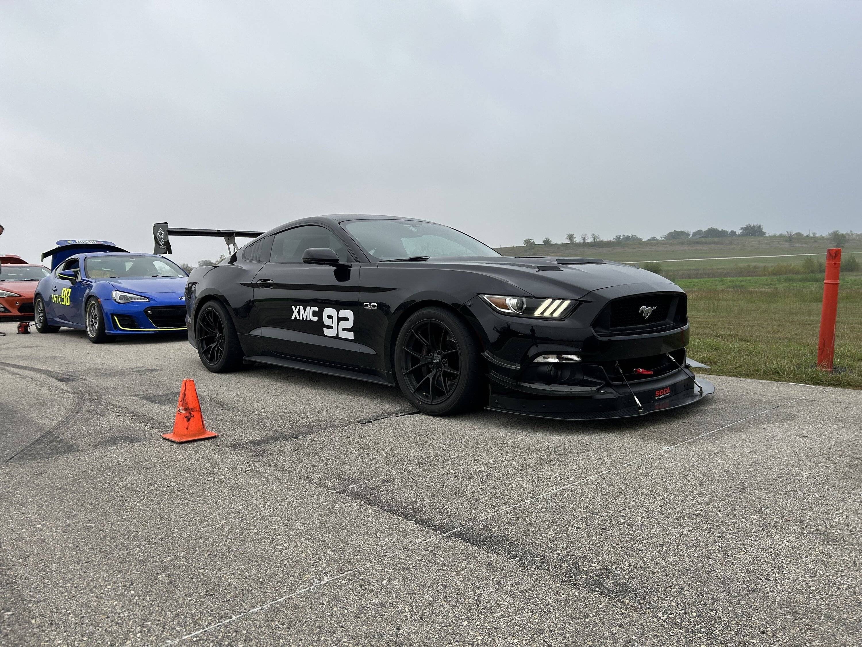

What wing and end plate is that? Im seeing more of that style of end plate design on GT cars and also the new Mark IV GT
