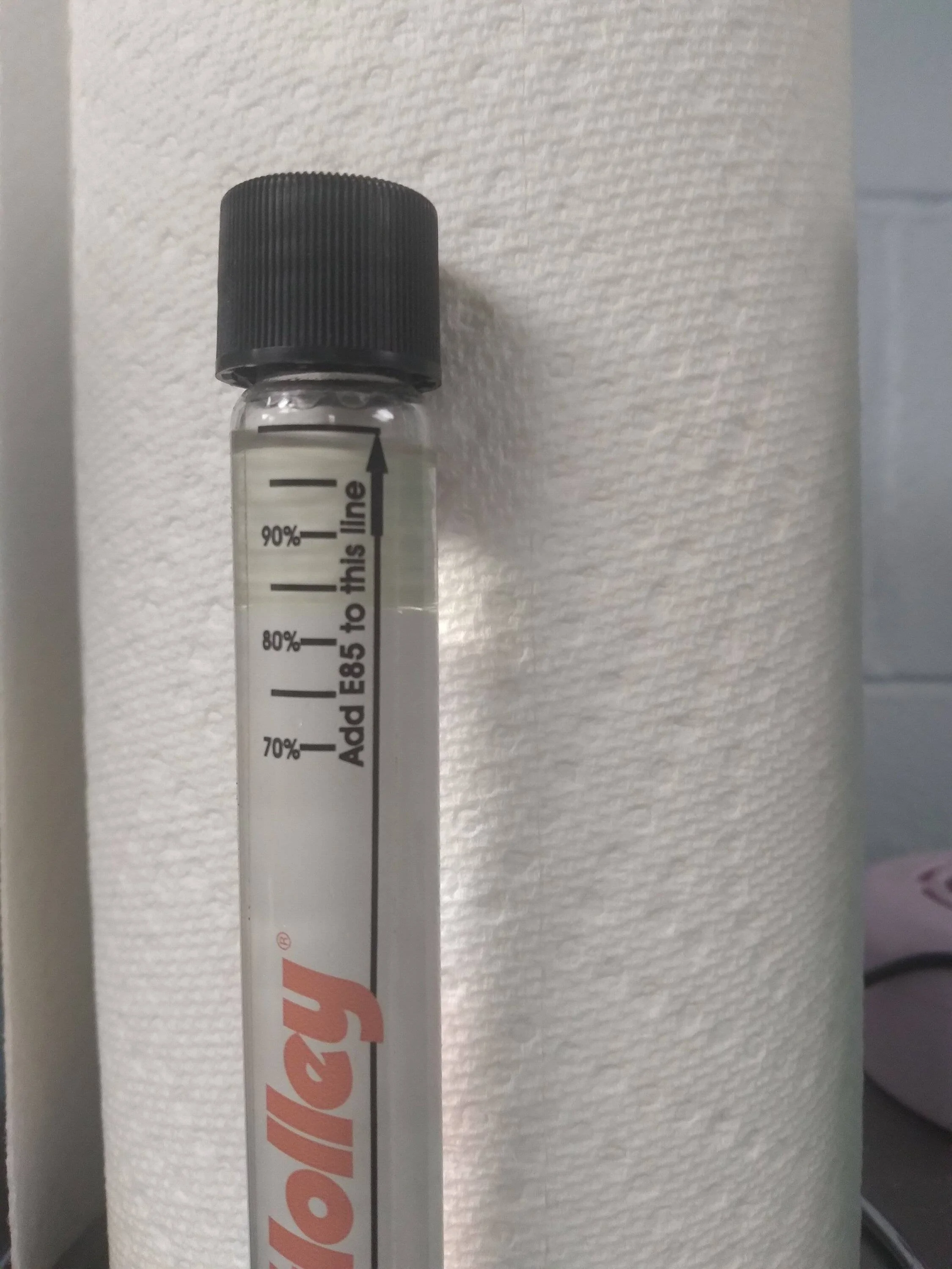

How do you measure the ethanol content? Obviously a sample but does it need to be shipped off for fancy testing? Or is there a device like diabetics use for a finger stick and a drop tells you all you need to know almost instantly?
A test tube tester works, I use both the bigger Holley and a smaller vial type.
They both read the same but the you have less waste with the small vial.
The Sheetz stations around me have historically ran E70 winter blend and E80+ summer blend.
This test is from last weekend when I filled up some 5gal containers.

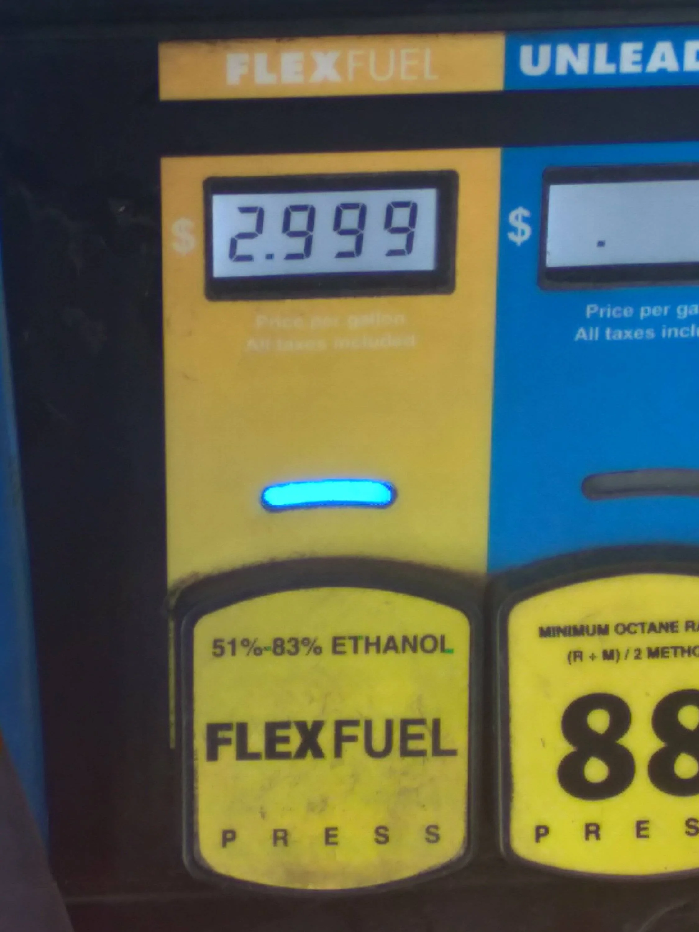

The issue I seem to see here is Everybody calls pump ethanol 'E85'
Even when the Pump Clearly labels 51%-81% Ethanol as Flex Fuel.
Even on the Hellcat forums people constantly say the E85 around them only tests E70 or whatever, Well, Then That's NOT E85, It's Flex Fuel, LOL
The BP down in Ft Mill used to have a full E85 pump and it would test E90 in the summer.
But they took it out last year and installed another diesel pump so all I have around me is Sheetz flex fuel.
I run a flex fuel tune on my hellcat and it is spot on,

Yes.
