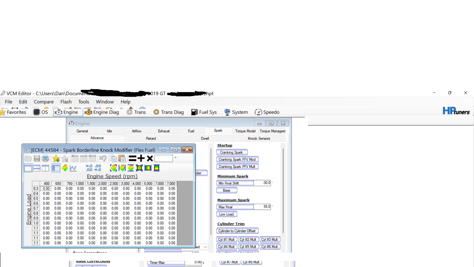

Pull up an F150 tune and compare it to a S550 tune. You will find that there are no flex fuel dependent borderline tables, mbt tables, or flex fuel blenders for aforementioned tables. About all they give you are tables for getting the AFR to calculate correctly and some cold start stuff, nothing for spark.
This is a 2019 GT mustang tune and........
Ok fair enough, I’ve not looked at 19MY+ calibrations, I’m more focused on 15MY. Perhaps with upgrade 3 and PFDI it was added. Good for those folks!

On the 2 gen you can use the octane adjustment under borderline corrections.
Ford uses this table on the 2 gen F150's also.

It uses that table and another to increase borderline spark due to octane. When the logic senses anything over E20 or so it calculates spark using this modifier.
The gen 2 uses 1 table to do the same. There is more resolution in the Gen3's
A head scratcher, the F150 uses less total advance than the GT even under FFV tuning when using optimum power tables.
