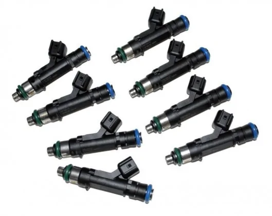

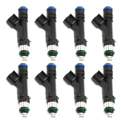

As @Stephen@lethal mentioned all you need for that setup to be able to run E85 is a custom tune and some injectors. 47lb injectors are quite popular as well as our LP52's which actually flow more and cost less than the 47's.
Feel free to give us a shout if there's anything we can help you with.
Thanks!
https://www.lethalperformance.com/ford-performance-ev6-47lb-high-impedance-fuel-injector-set.html
https://www.lethalperformance.com/l...-impedance-fuel-injector-set-8-injectors.html
https://www.lethalperformance.com/f...mm-high-pressure-fuel-injectors-8-pieces.html

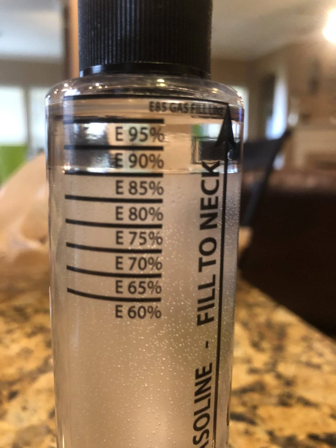

I recently switched to E85 in my 2016 with a dedicated E85 tune. I can switch it back at anytime to my 93 gas tune like if I need to travel. Huge difference. I’m about to upgrade to a GT350 intake as well and I’ll get the bigger injectors when I do and also an updated tune. I’ve got a Sunoco station near me that has some good E85.
AZ18yote
Nov 24, 2017
3,221
1,531
Arizona
Bryan
2018 Mustang GT Prem PP Magnetic
It's a completely different animal on e. And that looks like some quality right there !
