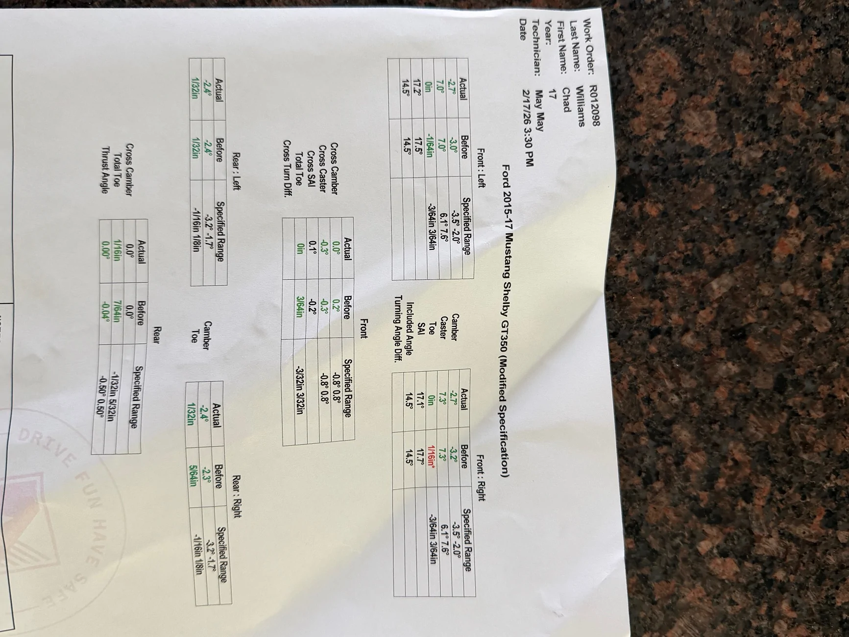

I have a 2019 GT350 that has a relatively aggressive alignment for track use. The alignment was done in DFW by a reputable company who regularly works on track cars.
5 months ago I put on Vorshlag camber plates and had them adjust front alignment to -3.2 camber, 0 toe. Rears are -2.4.

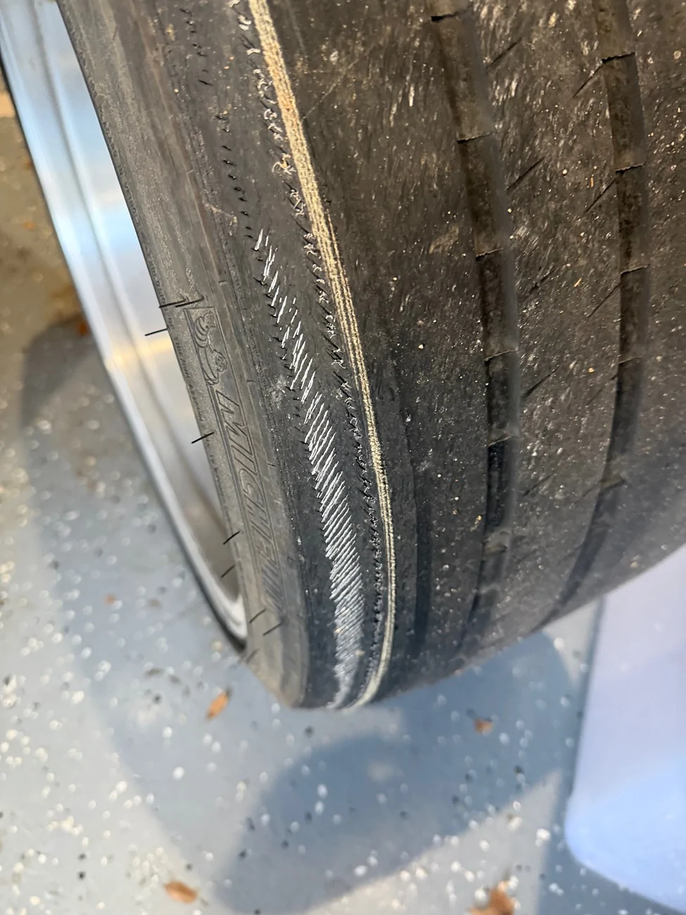

I've had no issues with rear wear but the fronts corded in less than 1000 miles. I had them relax the camber to -2.7, thinking the super aggressive camber may be the culprit. I moved the rear tires to the front and they corded in less than 500 miles.
Full transparency...the corded tires were 2019 Cup 2s so I understand they are soft tires. The alignment company suggested that the old tires were the cause for the wear.
Sooooo....I put new tires on and in a couple hundred miles, they are showing significant wear where the other tires corded.
I'm not sure what to do at this point. Anyone run into this before? I can't keep blowing through tires every 1000 miles.
I have FP springs, Vorschlag camber plates, Apex 19x11 all around, 25mm spacers up front. I never had issues until I jumped from -2.7 to -3.2 up front. Going back to -2.7 didn't seem to resolve the issue.

It's your toe. Setting it at zero means under hard braking (track time), those tires are actually toed out. Thank Ford for the geometry they designed up front...
It definitely is worth checking ball joints, rubber bushings, etc...for wear. BUT I experienced exactly what you are experiencing when I went to zero toe. Go to the Ford spec, slight toe in.

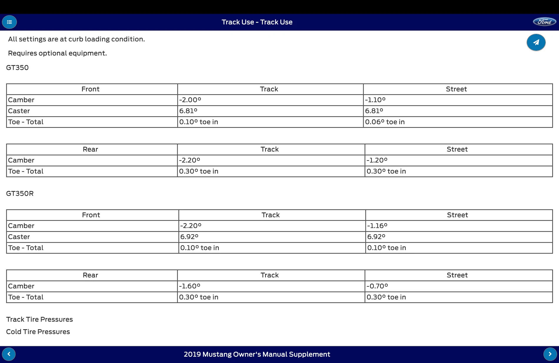

You need more toe in front and rear as illustrated by the alignment specs supplied earlier. Too little toe in will kill the inside edge of the tires, as you are seeing.
