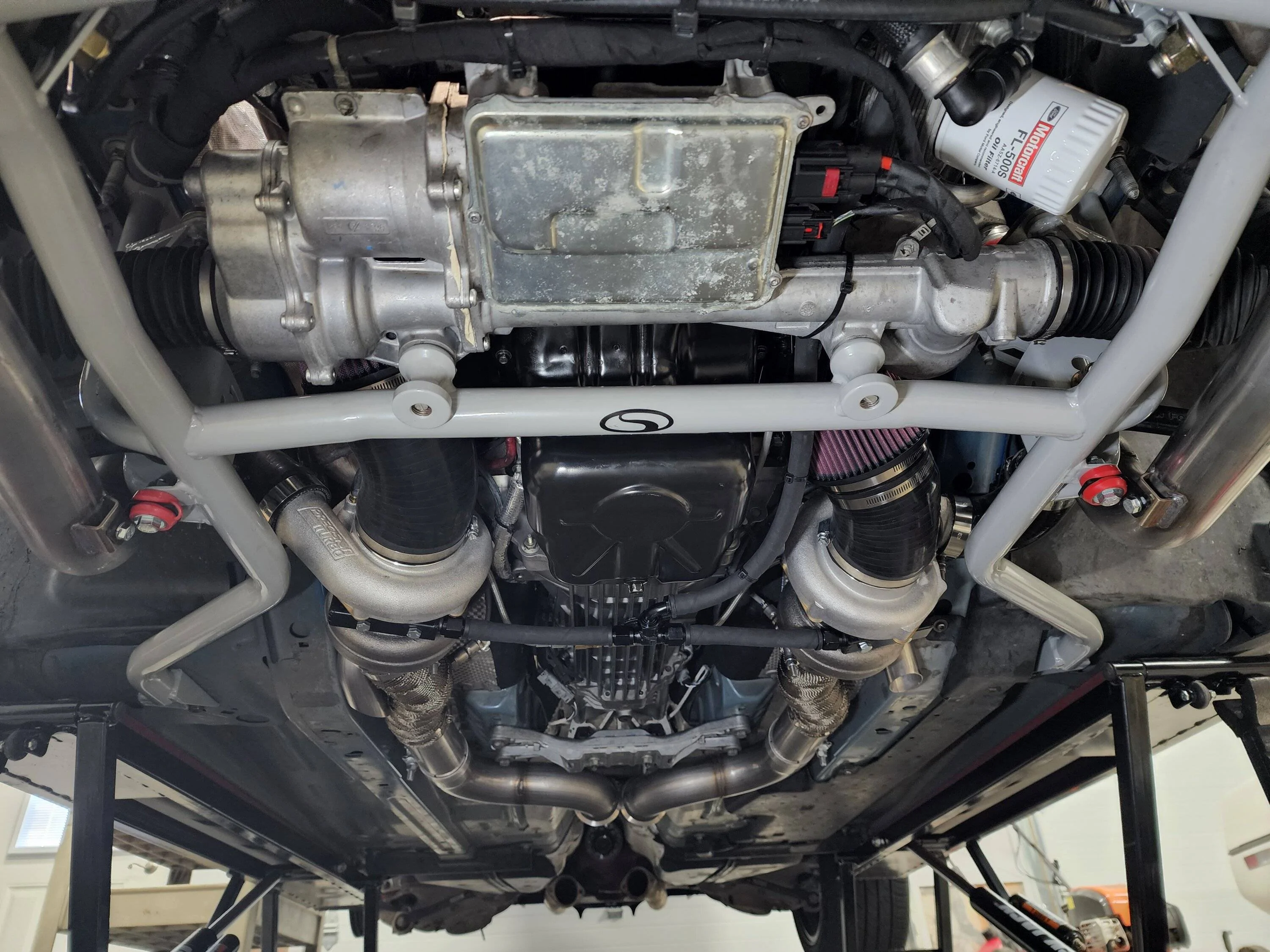

I love the steeda k-member. It fit perfect with tons of room.

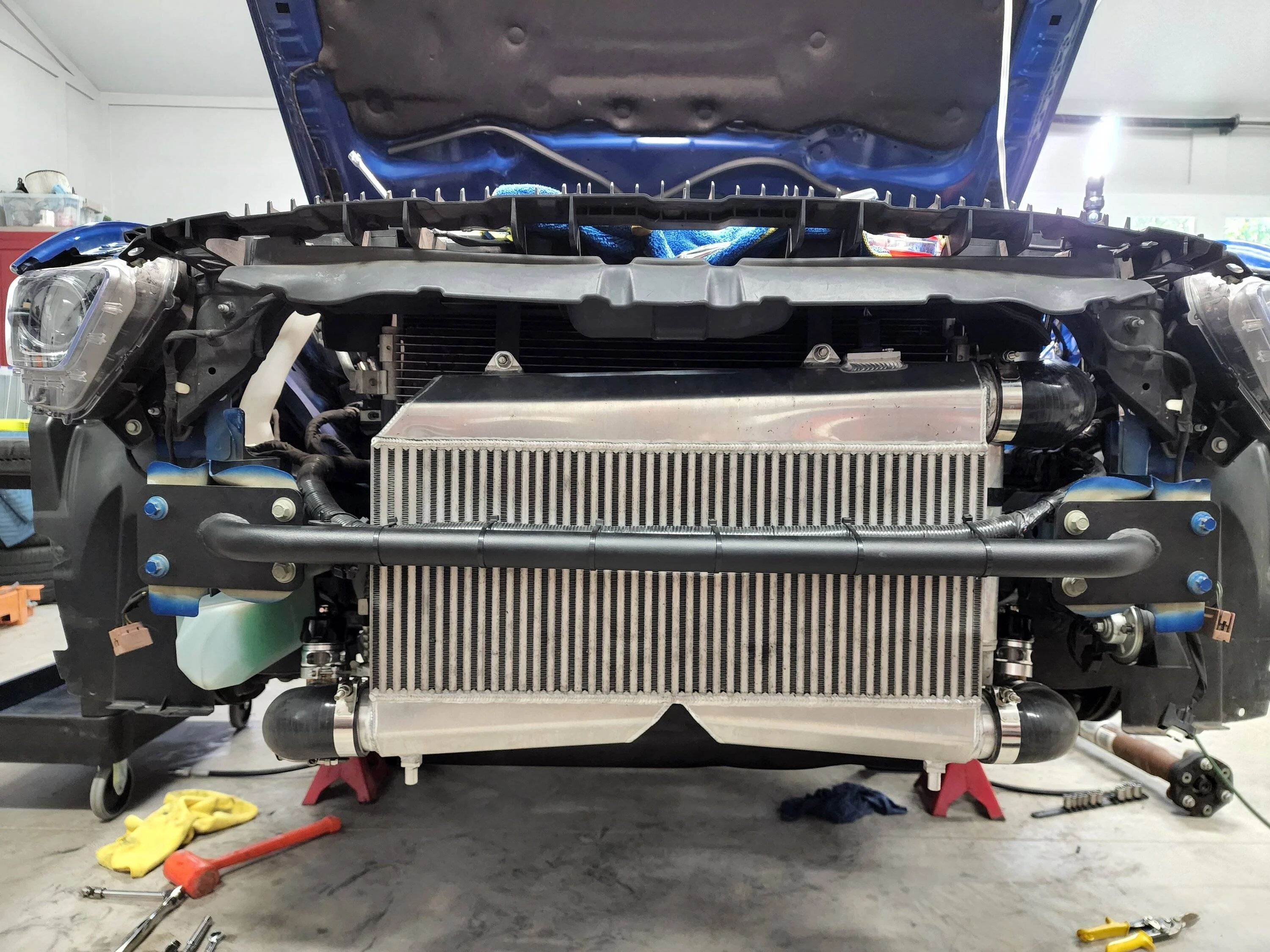

looking at the steeda k member for my sleeper gt350 does it keep the front horns to mount the angle iron support for the intercooler?

Wow! Night and day difference vs stock k member. I would assume the bmr would look pretty similar. Thank you for the pic. I looked everywhere for a pic and this is the first I’ve seen. Definitely going tubular. I have to work out how to mount 777 performance frame mount mach1 front splitter. But shouldn’t be too hard. Can’t believe how much space it creates.
No. But you don't need the support bar. I was going to make a bracket that bolted to the frame rails where the front crash bar is, but once you install the upper intercooler brackets and put the charge pipes on, it is rock solid. You can pound on it with your fist and it doesn't budge.
