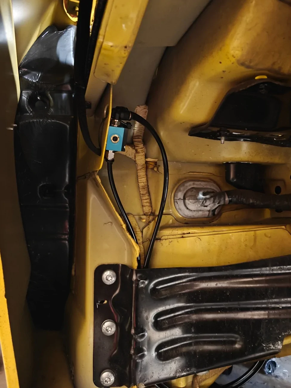

I’m running two.
IceMan706
Oct 18, 2024
27
Virginia
Jacari
2021 Ford Mustang GT

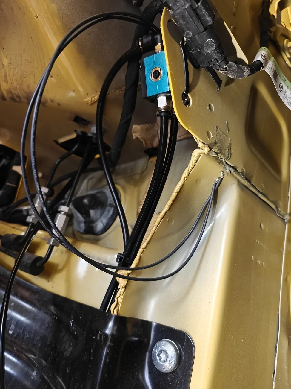

Here is the second one on the passenger side
One more question for I was trying to mount my 2 intercooler brackets that connect to the upper radiator support and I’m not seeing any bolts to remove it’s weird mines looks like it’s a Allen key socket
They go in place of the upper radiator support brackets. The brackets will no longer be used and they should be 13mm at least is was for me on my 2016. Not all mustangs have the brackets and you may just install them in the empty holes.
