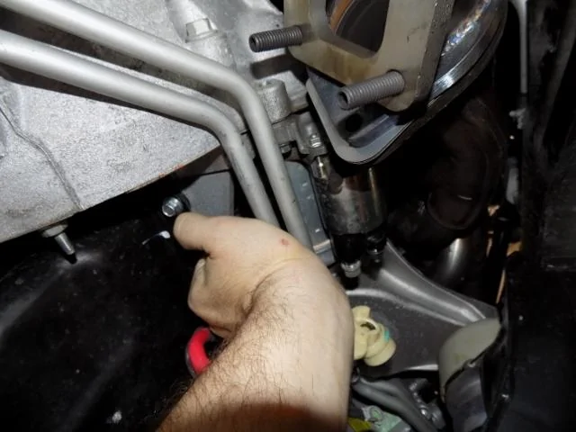

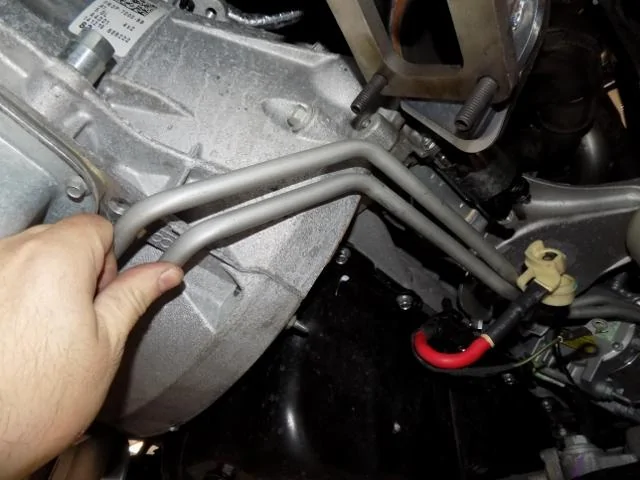

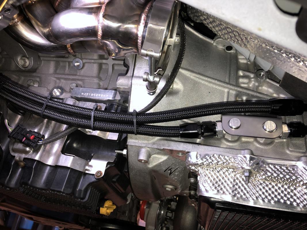

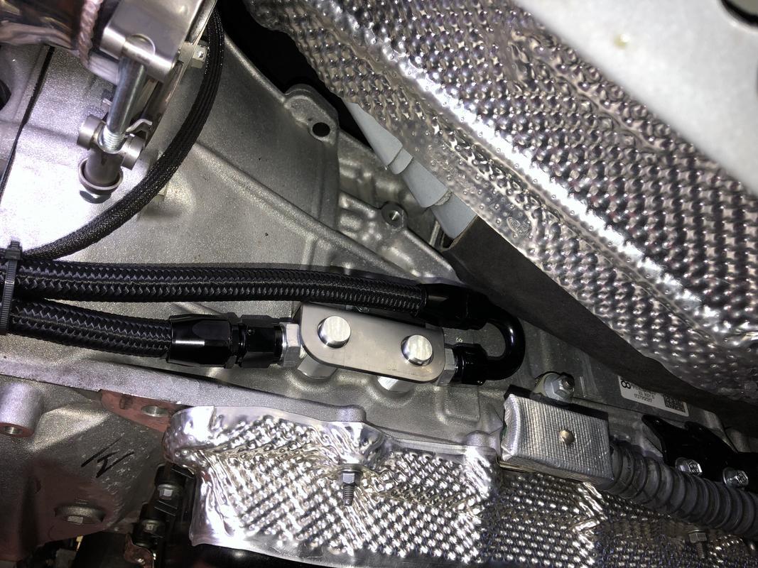

Hello.
We have a 2017 6r80 car here as we speak. There is definitely enough room once the line is moved. It may take some effort but it is definitely possible. Please see attached image of the line on our test vehicle once moved.
We are sorry it was difficult in your case, but it is a normal installation procedure.
We are here to help and assist if you need any future input.
Team Hellion
MisterNitro
Nov 12, 2018
46
St Petersburg, FL
2015 Mustang
Hello.
Team Hellion
Well, I see what you have there but ive pushed on them as hard as i physically could and couldnt make enough room. Next step is a 2x4 the BFH i guess..

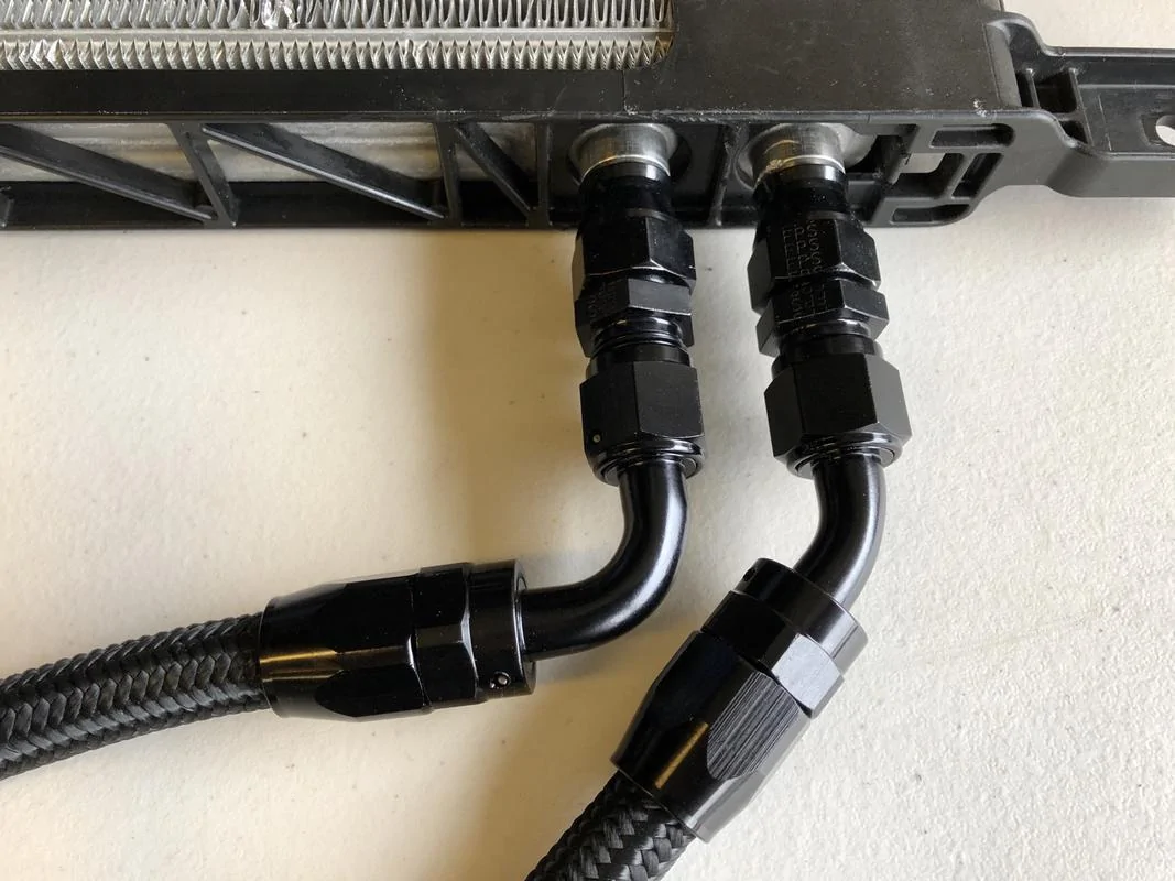

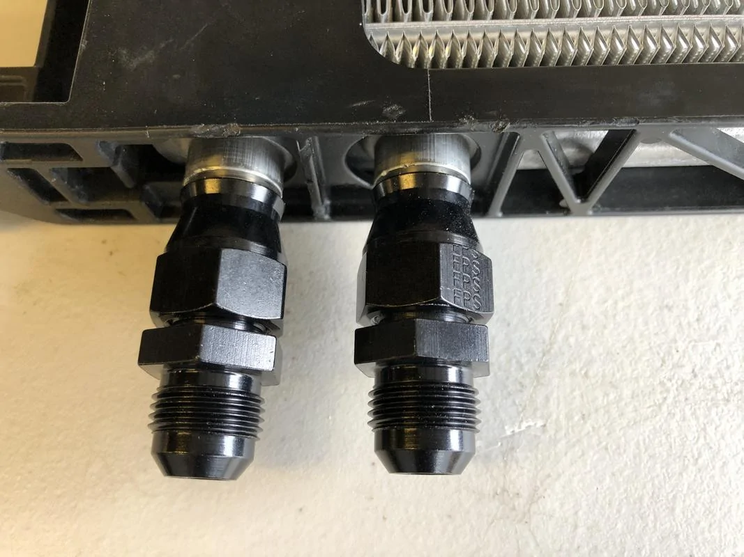

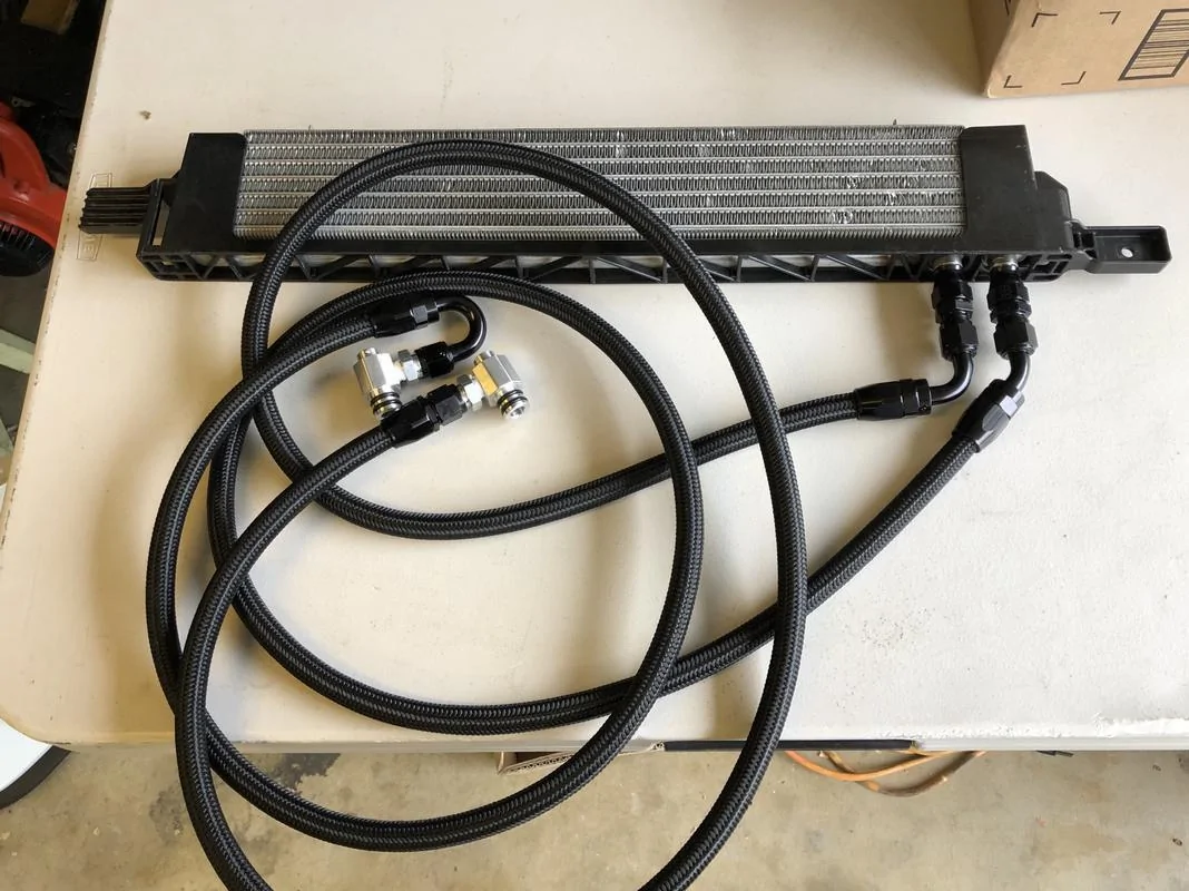

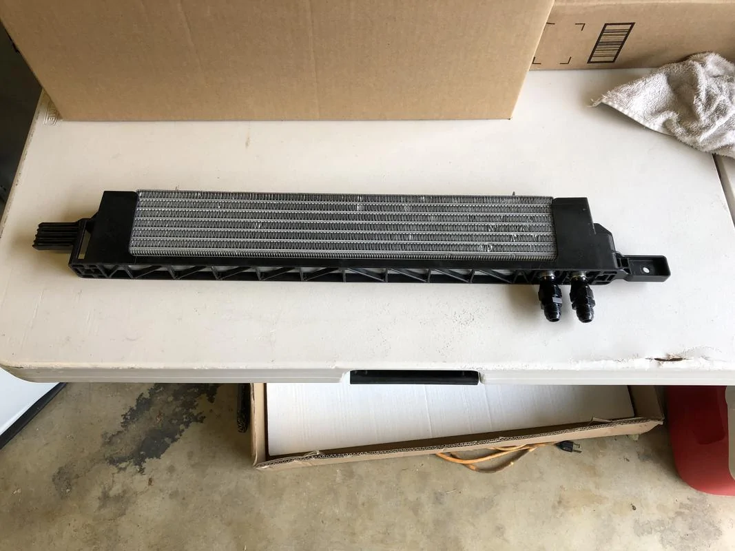

I ran steel braided lines. Used a bolt cutter to cut out the stockers. Power By The Hour sells a kit.
gimmie11s
Mar 2, 2018
1,847
1,483
SoCal
Murica!
Thanks for the headsup, this is likely what ill have to do for my sanity
No prob. The PBH kit is $500 which is absurd.
Just buy these PA fittings I have posted above along with a -8AN hose and fitting kit from Amazon and call it done.
Save yourself over $300 in the process.
