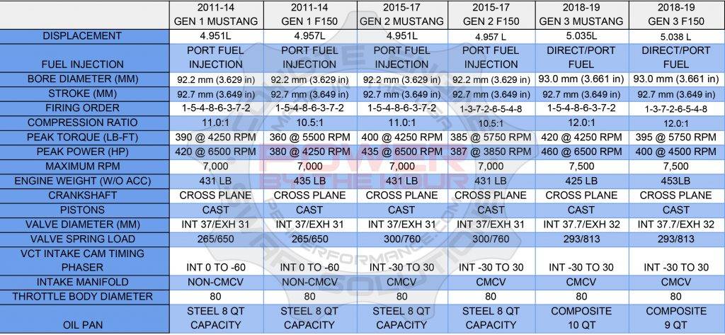

If you have not come across it, here's some reading materials regarding Coyote 5.0 cylinder head flow rates.
Some of it is repetitive based on who had the original source material and where it was distributed (or copied for other articles).
https://www.cjponyparts.com/media/images/install-pdf/install_bkfce-2.pdf
https://www.diyford.com/ford-coyote-engine-cylinder-head-performance-guide/
https://www.motortrend.com/how-to/mmfp-1209-ported-coyote-heads-dyno-test/
https://www.enginelabs.com/engine-t...esting-mpr-built-gen-3-coyote-cylinder-heads/
Also see this thread with quite a few Coyote reference PDFs in it which discuss the differences between the Gen1-Gen3 Coyotes.
https://www.mustang6g.com/forums/th...coyote-v8-engine-improvements-changes.138550/
This chart is courtesy of Power By The Hour and is on their website:
Are the gen 1 Mustang heads any different than the truck heads ? Do you know ?
