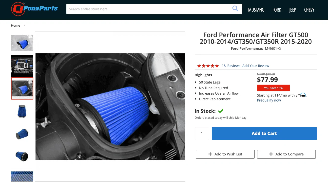

The stock air intake is a CAI, but the filter is small and more restrictive. Whether you go with JLT or the other guy, the filter and the increased airflow is what gives the car more HP. You could argue that the JLT is not a true enclosed CAI, but it has been dyno'd and verified the increase in HP.
Again, no tune required.

Are there no drop in filters available?

Thank you for the info. I understand the ā€œpay to playā€ when it comes to warranty. I’m not messing with my tune, just curious as to what is available. I don’t even have the car yet so I need to do a real world analysis of it but I’m guessing I’ll at least replace the resonators. First I need to see what the sound difference is between the H and X pipes. I had the Corsa Sport cat back with Stainless Works headers on my ā€˜16 GT and it sounded phenomenal.
Evolvd: The stock exhaust sounds fantastic as it is so once you get yours you will need to make that decision for your ears .
