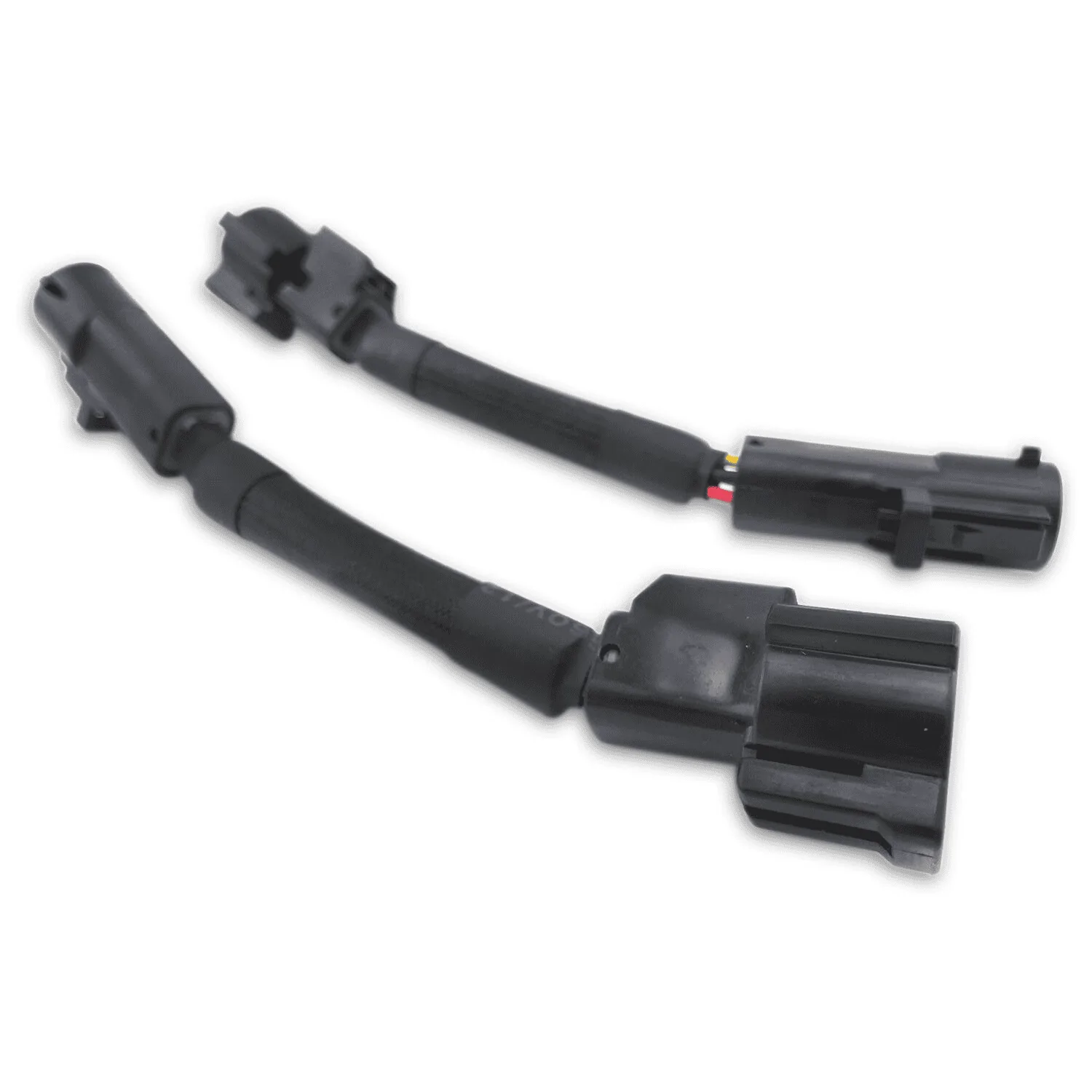

Is there anyway to eliminate the cats without a tune on these cars? I'm not 100% sure I want to risk voiding the powertrain warranty yet with a tune, but I'd love to make it scream (even more). I'm thinking about my 97 cobra that used a plug that went between the rear O2 sensors to keep the CEL off.

MIL eliminators do not work on modern cars because they all are wide band 02 sensors now. I was able to use bung adaptors that pull the 02 sensor out of the exhaust flow, and only allow a small amount of exhaust to reach the 02 sensor, therefore tricking it that the cats are still working correctly.
As far as I know this is the only fix, other than having them turned off in the tune (not emission legal), which still allows then car to pass emissions.
