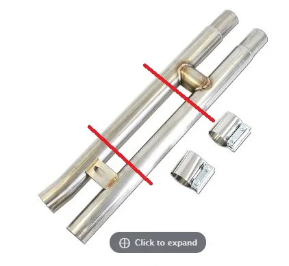

Just installed a Steeda H-Pipe on my 2020 GT Convertible with active exhaust.
I was expecting a slight increase in volume, keeping the deep tone, no rasp, and no drone. I've got the total opposite.
Volume: The start-up volume is extremely loud. Too loud for what I was looking for.
Rasp: I find that when getting above 2500k RPM the tone is much raspier than with the stock resonator.
Drone: The drone inside the car is ridiculous, especially in 9th/10th gear on the highway which I'm thinking may be because it's a convertible and not a coupe as the videos I watched said there's no drone at all. Even with the stock exhaust there was some drone in track mode in 9th/10th, so I'm thinking it's a convertible thing. But the drone at all speeds now is a lot.
My goal: To reduce overall volume a little, and get back to a deeper tone without the rasp.
Considering a few things and looking for input.
1) Cut the H-Pipe between the H and the Steeda bracket (shown in the picture) and Install 12" Vibrant Resonators?
2) Go back to stock resonator and do nothing
3) Go back to stock resonator and spend a ton on an axle-back active exhaust.
Thoughts?
