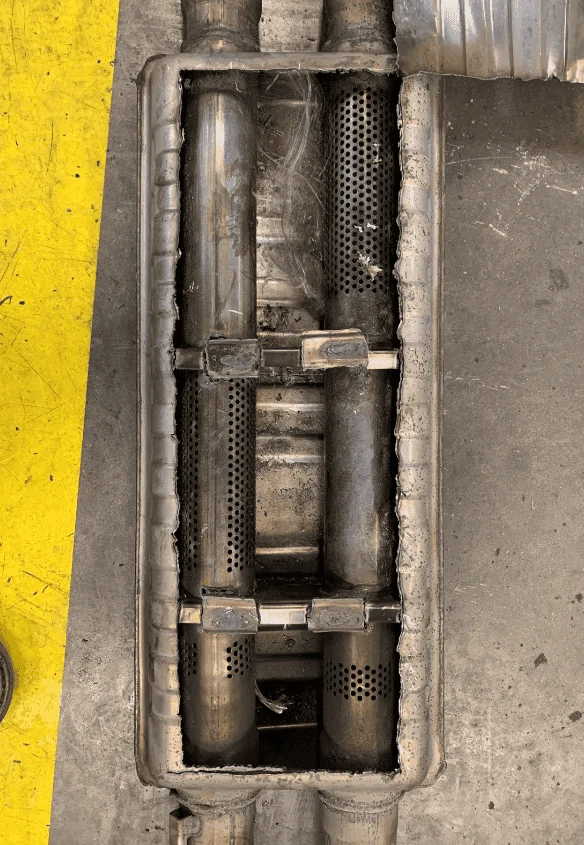

Actually the suitcase is just two straight pipes with perforations, not an X or an H. There’s no connection between the two sides in the suitcase.
My error. My memory isn't what it used to be. I distinctly remember looking right through one and it is actually as you stated. Good grief.

The first time I peeked inside I thought it was an H pipe too. It’s hard to tell that theres no crossover connection.
