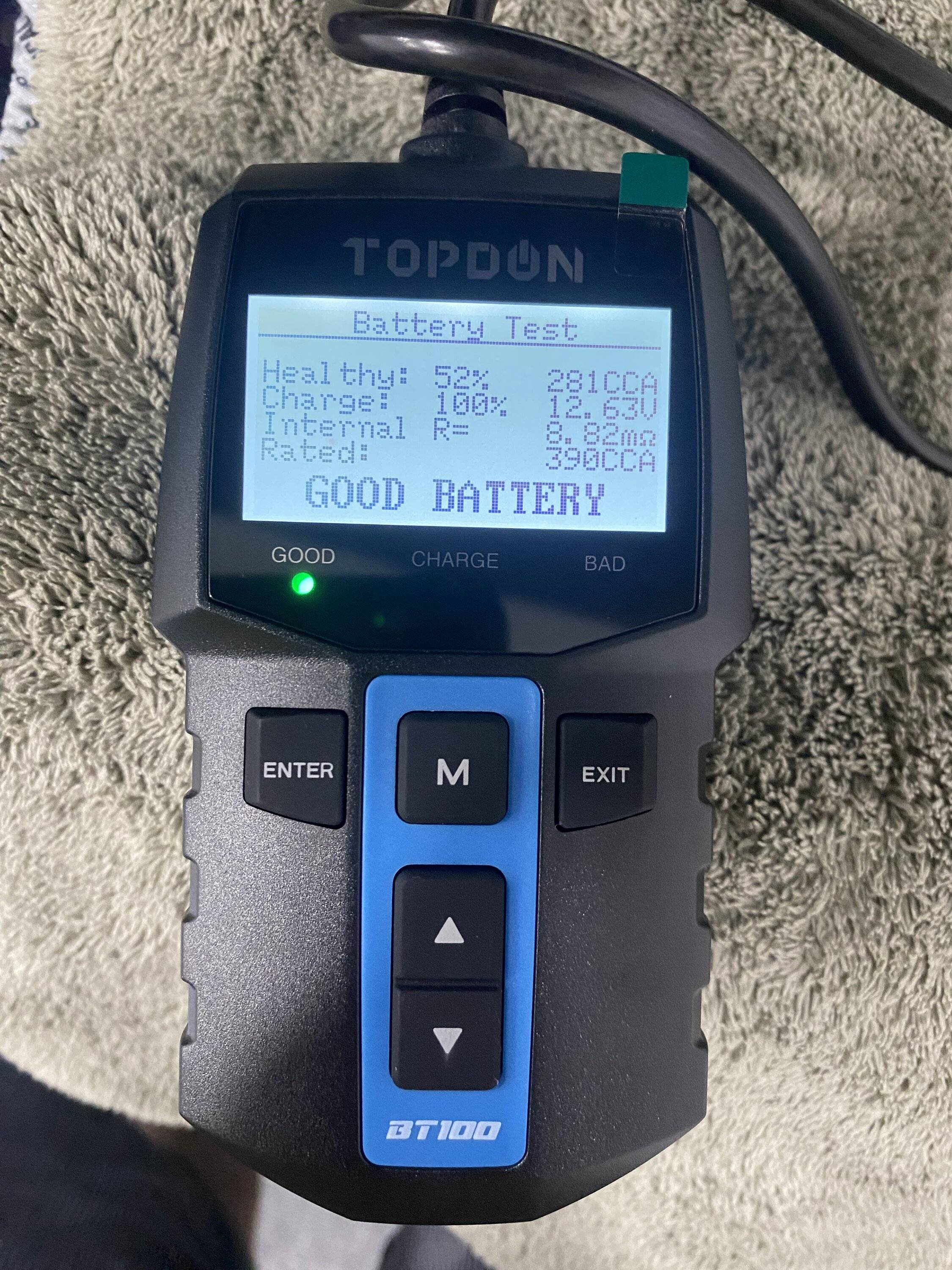

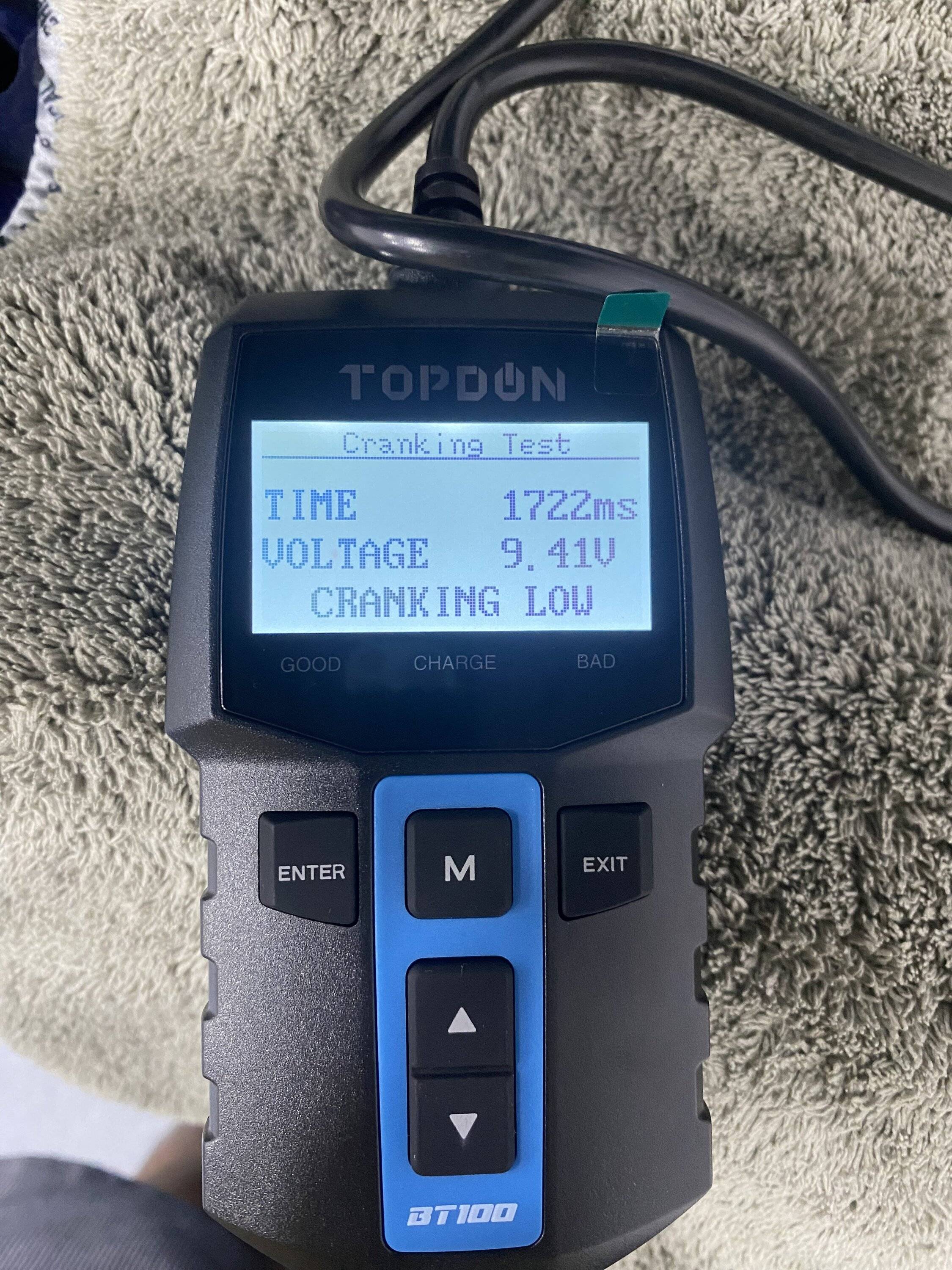

I have noticed since a time ago that when I start up my car it feels weak. Yesterday was really noticeable because it took 2 seconds to crank. Today I ran a test and the cranking test was low (9.41V). Does that mean the battery is not good enough and should I replace it (for the same battery or there is a better option)? Battery test was GOOD, health 52%, and Charhe 100%. Should I worry about that cranking low result? I repeated it, and both times was low. Sometimes I use a battery tender, but this last time not, and the car was stopped for about a week.

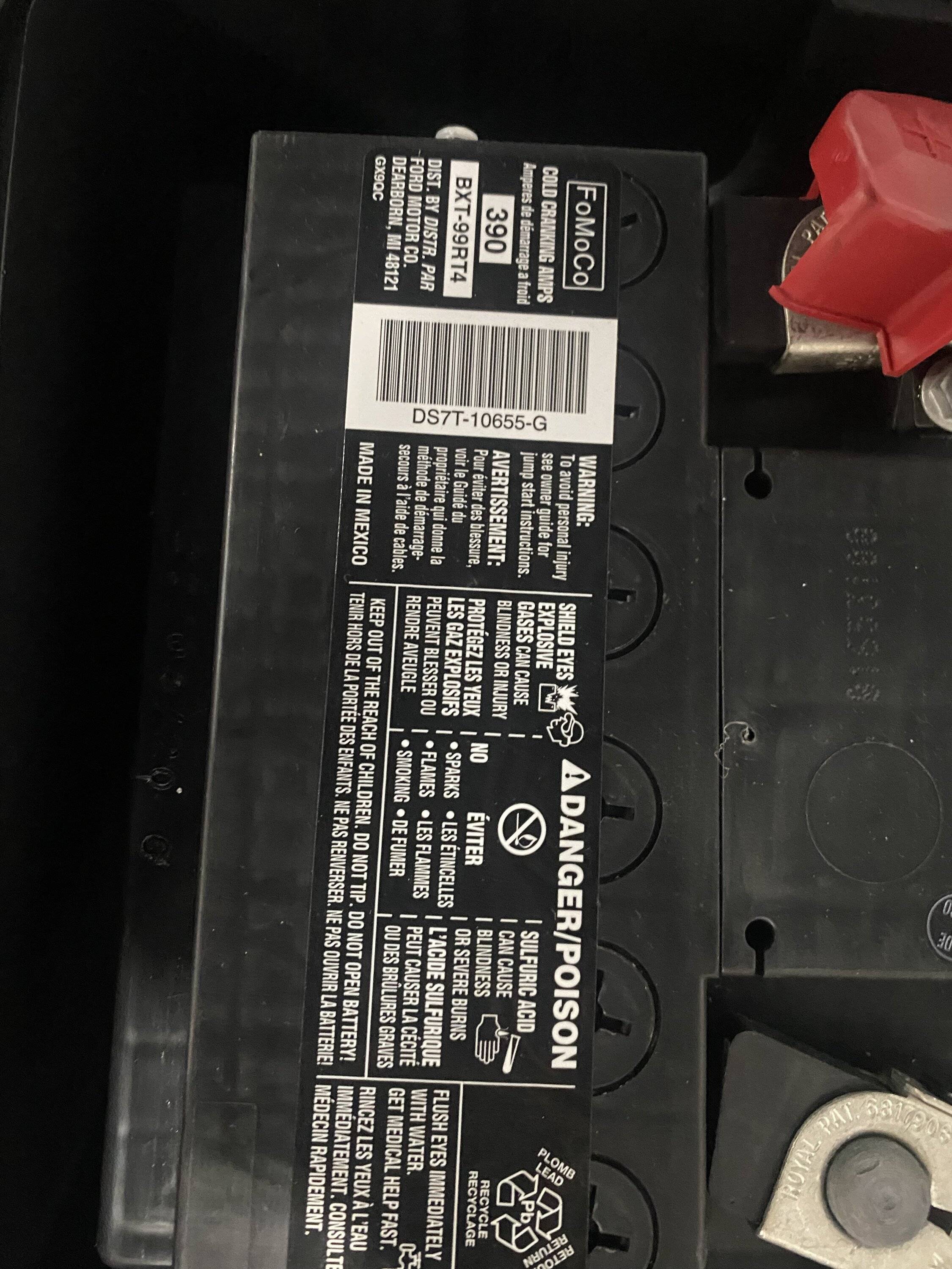

This is my OEM battery, it has 3 years on it but I barely use it, only 2900 miles in 3 years.

Sounds like it is time for a new battery. I replaced mine a bit over a year ago with an Interstate battery from Costco (for the Mustang GT) and have had zero issues/concerns. It is higher CCA, has a 3 year warranty, and is about $110. Unless you are racing and can't deal with any additional battery weight, I recommend it over OEM. The CCA amps on our OEM batteries are a bit low.

I have a tender and always the crank sound is strong, but if I leave the car without the tender, it will crank poorly. If you take the car out, there is a big chance that this battery could fail. I will replace it soon. Just need to confirm the GT battery with 570CCA is good enough for the 350R, and what should I be concerned about replacing a battery by myself? I don't like to go to dealers, always it is a nightmare (scratch, break, always something, miscommunication).

Agree, new battery, starting the car has the same effect a load test does when run on a battery.
The first reading shows a surface charge. The starter having a big amp draw, quickly pulls the battery down.
Yes. It's bigger than the GT350/R battery. It will be fine, just a bit heavier.
