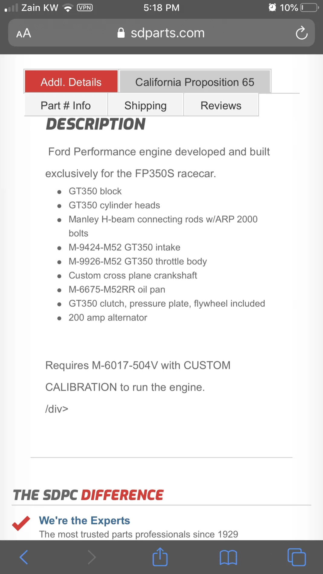

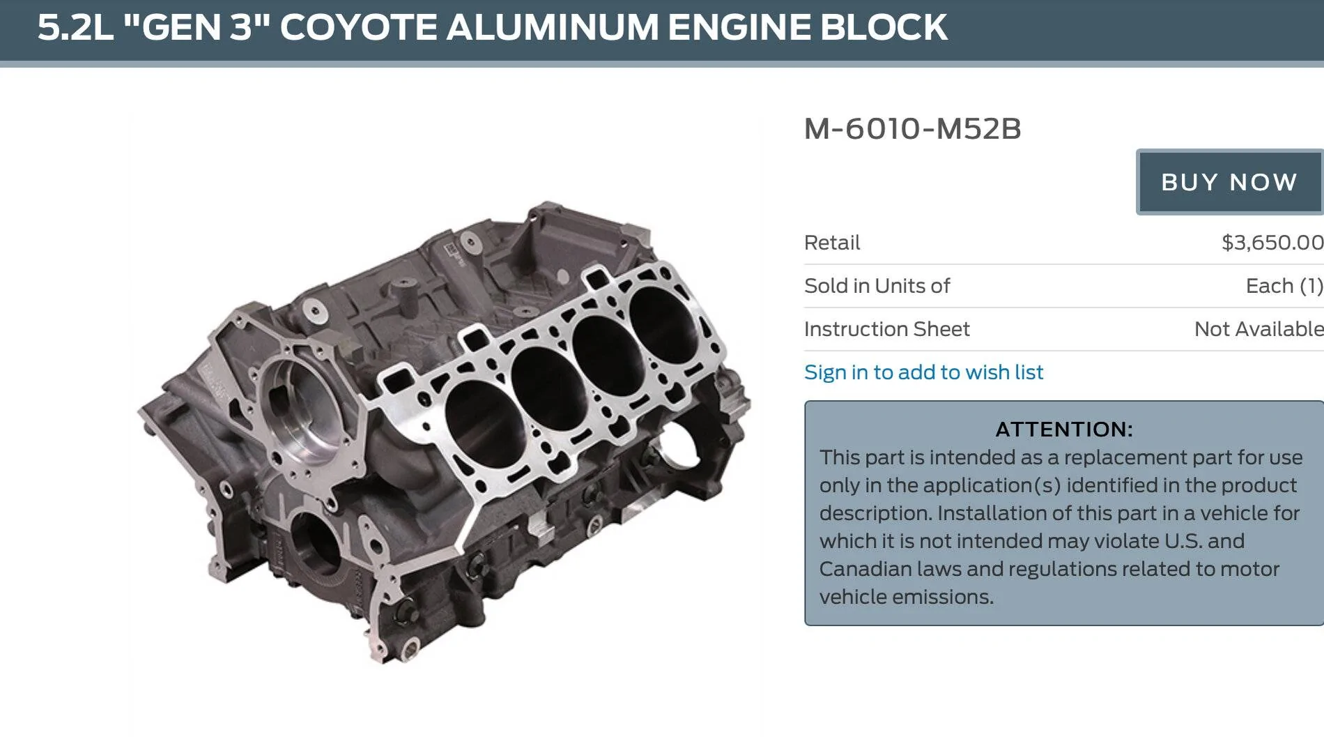

Thanks .
Do you know if it uses the updated GT350 bare block? -
Also curious about what you did with the Voodoo?
VoodooStang
May 30, 2017
101
107
Thanks .
Wanted a more track focused engine. The FP350s race engine has a forged rotating assembly and a light weight valve train enabling it to handle high revs for an extended period of time. It uses the Gen 3 block
