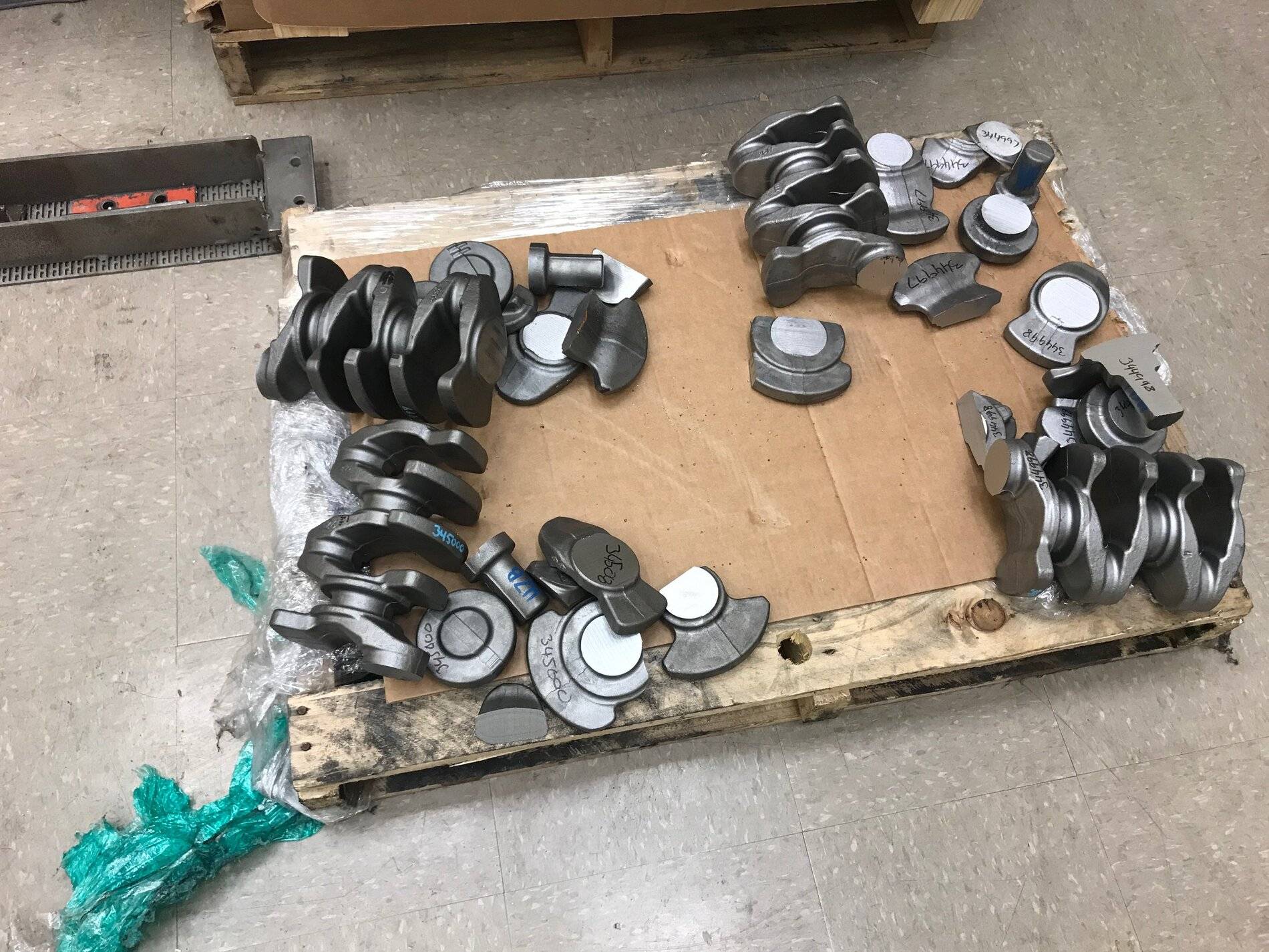

The Metallurgists who were performing this testing looked at me funny when I said, "Wow Flat-Planed Cranks." They actually did not know what a Flat Plane Crank was! They know what they are doing metallurgically, but not as it relates to Shelbys.
I saw 2 pallets of '03 Cobra Eaton Superchargers sliced to bits in '99... they did not know what they were testing...... I did...!!!

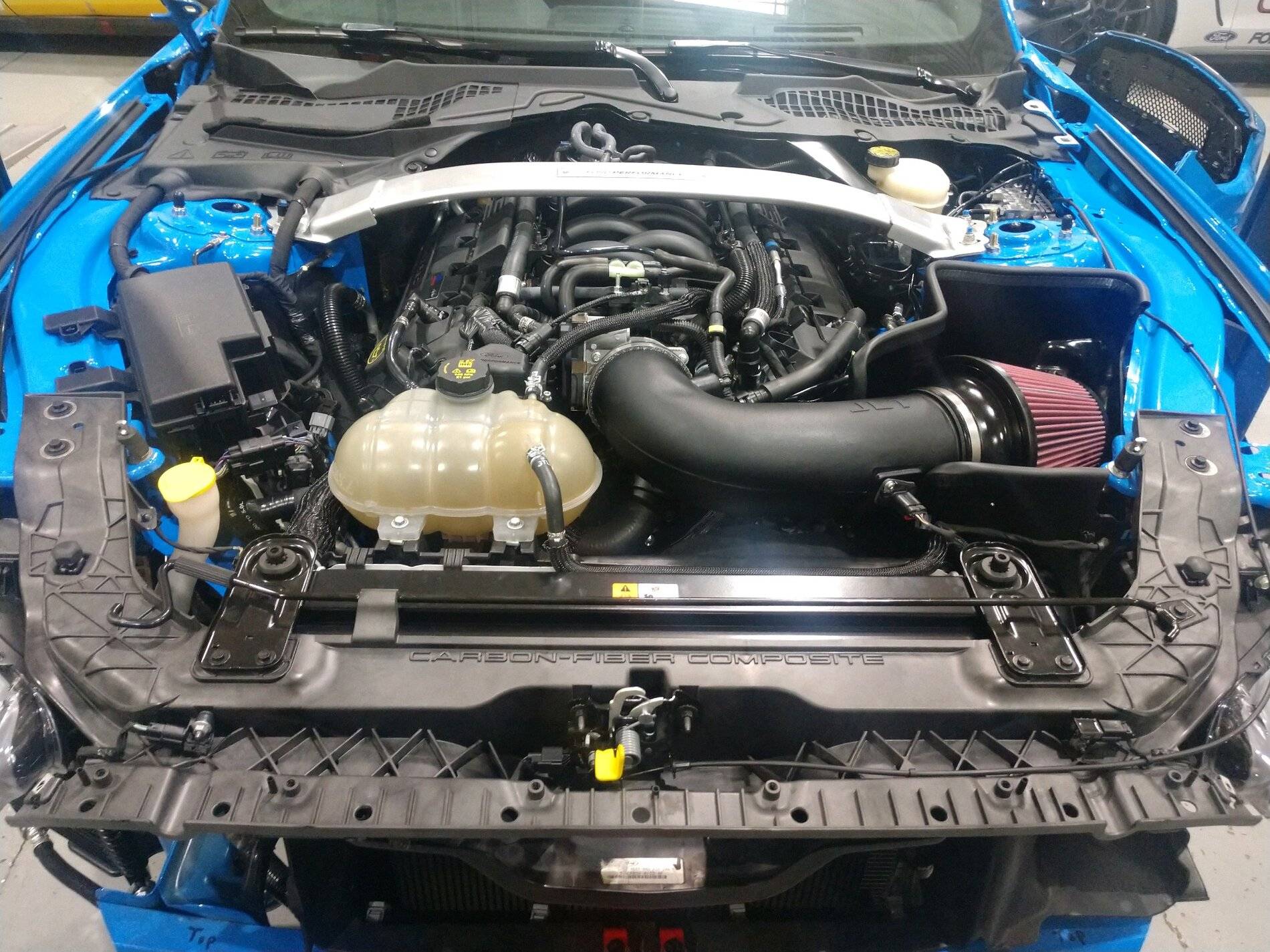

The OP talked a great deal about the things he did with the motor "JLT cold air intake & Tuned the engine" was on the list
Would that add power at least a little to the Voodoo as well?
VoodooStang
May 30, 2017
101
107
Yes, a JLT cold air intake with a 100 octane tune would add quite a few ponies

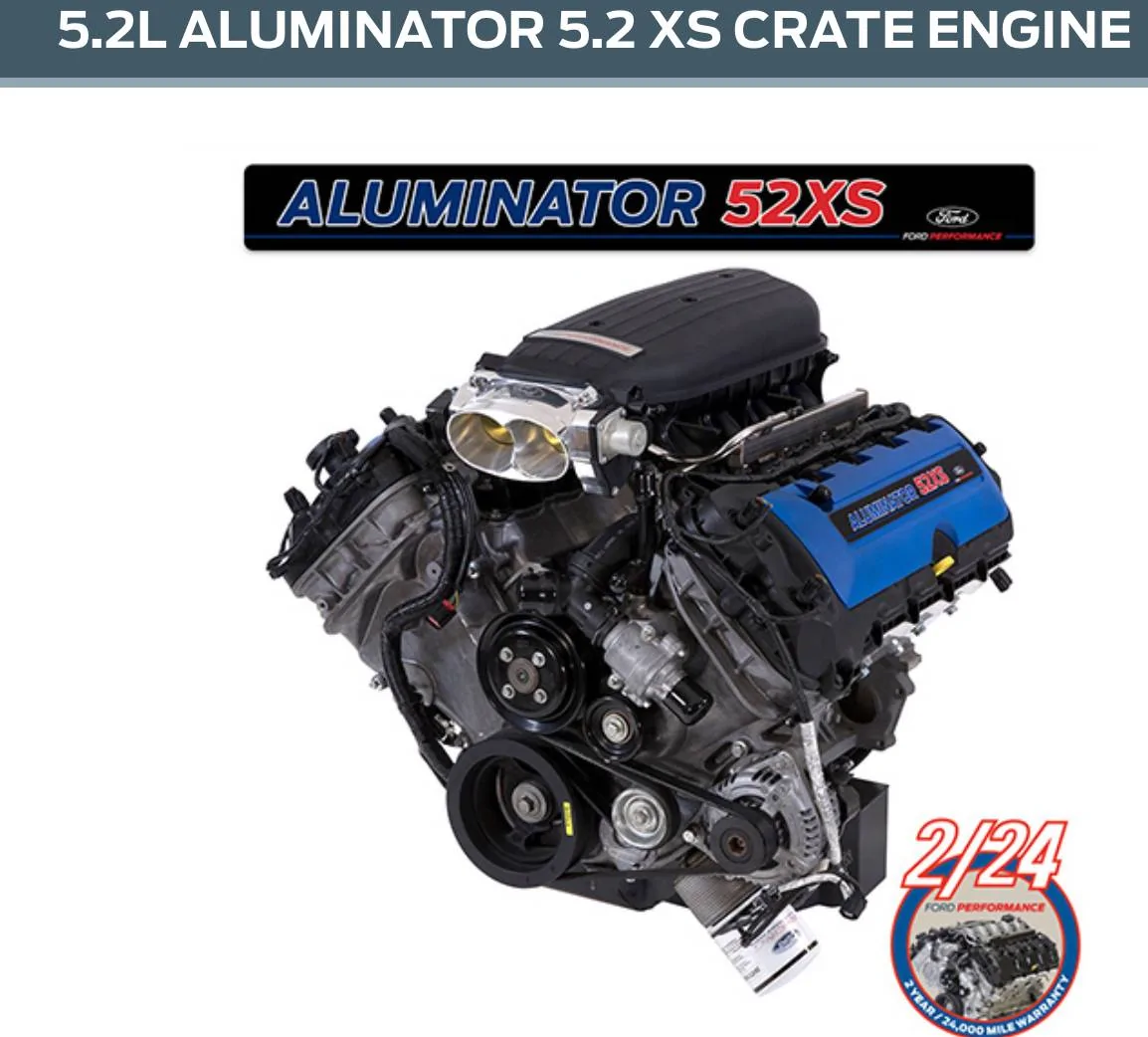

https://performanceparts.ford.com/part/M-6007-A52XS
  • Designed to work with 2015-2017 Mustang GT electronics-custom calibration required!
  • 580 Horsepower @ 7,800 rpm
  • 445 lb.-ft. Torque @ 4,500 rpm
  • 5.2L
  • 317 Cubic Inches
  • 12:1 Compression Ratio
  • Mahle® hard anodized forged pistons with low friction coating
  • Unique Manley® H-beam connecting rods with ARP2000® bolts
  • Unique Ford Performance M-6303-M52 Forged steel cross-plane crankshaft
  • Uses Ford Performance M-6010-M52B Shelby GT350 cylinder block
  • Ford Performance M-6675-M52 Shelby GT350 oil pan which features integrated windage and slosh baffles as well as an integrated oil pickup
  • Ford Performance M-6600-M50A billet steel gerotor oil pump gear set
  • Ford Performance M-9424-M50CJA Cobra Jet tuned intake (will not clear production 2015-2017 hood without modification). Please contact the Ford Performance Techline for more information
  • Ford Performance M-9926-CJ65 Cobra Jet dual bore 65mm bore throttle body
  • Four-valve-per-cylinder Shelby GT350 fully CNC ported aluminum heads with Roller-finger camshaft followers
  • Unique PAC® valve springs
  • Ford Performance M-6550-M52 camshafts
  • Camshaft specifications:
  • Intake camshaft - 14mm lift / 270 degrees duration
  • Exhaust camshaft - 14mm lift / 270 degrees duration
  • Robust primary timing chains as used on Shelby GT350R
  • Low-leak rate variable cam timing (VCT) phasers
  • Forged steel crankshaft sprocket
  • Ford Performance M-9593-LU47 47 lb. fuel injectors
  • Ford Performance M-12A227-CJ13 high RPM pulse ring
  • Unique Ford Performance blue coil covers with added unique badging. This coil cover set is not available anywhere other than the Aluminator 5.2XS!
  • Ford Performance M-12405-M50A zero (0) heat range spark plugs
  • Ford Performance M-6731-FL820 oil filter (quantity-1 included)
  • 200 amp alternator and Front Engine Accessory Drive (FEAD) kit as used on the Cobra Jet race car

This is the FP350s race engine
Okay kinda random but I just realized that the Mustang GT4 uses 5.2L V8.
Do you or anybody know what the difference is between the FP350 and the engine in the Mustang GT4?
Im guessing they based off the same engine meaning that its basically the Voodoo engine but is cross plane, but with some differences?
