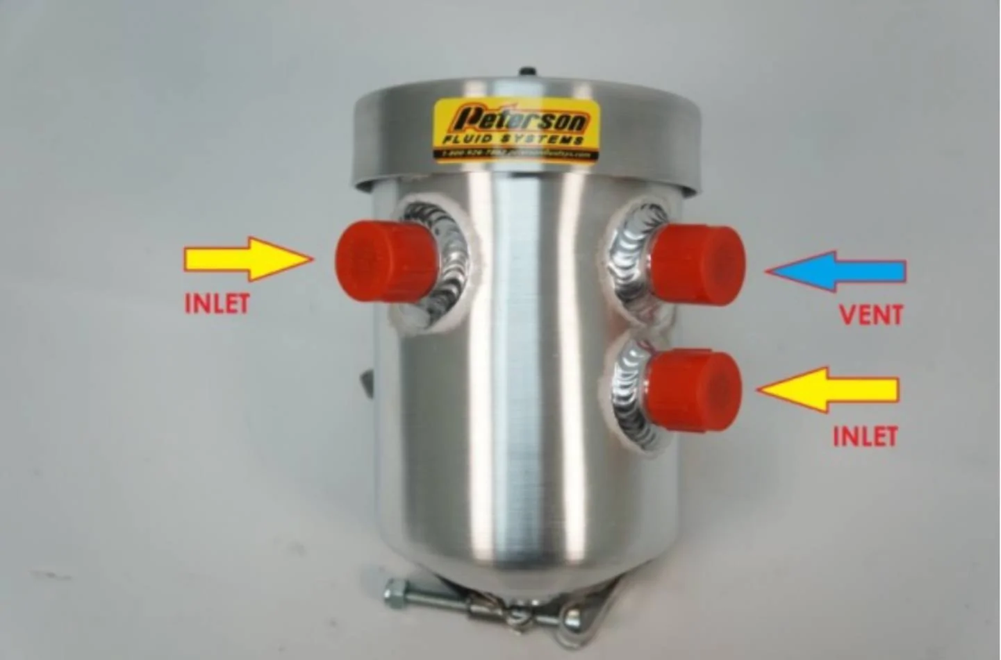

Fair enough. Keep in mind you'll be still allowing some oil vapor to get into the intake. I've been instructed by multiple folks a straight vent to atmosphere system is ideal. But I don't have data to back that up other than anecdotal evidence.
Hopefully with the frequency that I’m changing the oil, after every track weekend, this won‘t be a problem. My thoughts are that when you continue to run oil diluted with the by-products of combustion it looses it ability to lubricate. That’s when you start harming your engine.

Interestingly, had a conversation with MPR about catch cans. Never noticed it, but the reason it's primarily on the passenger side is the molded baffling that's on the driver's side (but not on the passenger side). If you put the two valve covers side by side, you go "ohhhhhh, no wonder." Not sure why Ford did it that way, it doesn't APPEAR there's any reason for the lack of baffling on the passenger side (to clearance anything). The passenger side allows much more "windage" and disruption to the flung oil whereas the driver's side immediately contacts the flung oil and it drains back into the valve train.
