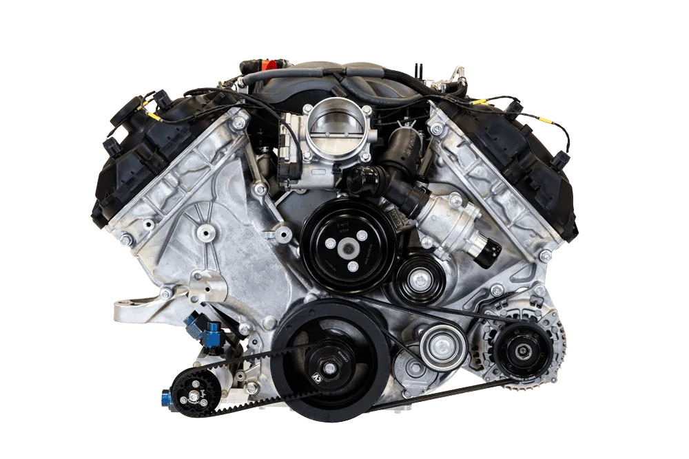

Okay kinda random but I just realized that the Mustang GT4 uses 5.2L V8.
Do you or anybody know what the difference is between the FP350 and the engine in the Mustang GT4?
Im guessing they based off the same engine meaning that its basically the Voodoo engine but is cross plane, but with some differences?

off hand i don’t but frpp used either a cross plane crank or FPC 5.2 depending on what race car it was. The gt500RC was FPC, They both will be within a few horse of each other so it really doesn’t matter lol
Okay but basically they are all the same engines just small different changes?

it’s largely the same as the Voodoo/FP350S/5.2 XS, but there are some differences due to both regulations and improvements.
For example, it uses the CPC to help get more torque in its de-tuned configuration. There are some changes to the valve train that aren’t widely reported, tho there is a secondary chain guide that was developed and released as a Ford performance part. It also uses a standard 5.0 intake.
but it’s not a Ford performance engine. They’re built by Roush Yates and from what I’ve heard they’re pretty tight-lipped about changes and tweaks.

Does the use of a CPC change the torque curve? Would it have more power down low and not need to rev out to hit the power, as is the case with the FPC?

Correct. CPC offers more torque lower in the RPM band and the FPC smooths out the high rpm stuff and gives you a bit more rpm.

FORD MUSTANG GT4 BY FORD PERFORMANCE
https://performanceparts.ford.com/GT4/
  • Roush-Yates Engines custom built dry-sumped 5.2L V8 GT4 race engine with four valves per cylinder and twin-independent variable cam timing

The Mustang 5.2L V8 race engine is the next generation, naturally aspirated race engine specifically tuned for the Grand Sport class competition.
SKILLFULLY CRAFTED AND BUILT
A DEDICATED TEAM OF ENGINEERS, TECHNICIANS AND FABRICATORS WORK TOGETHER TO BUILD WORLD-CLASS RACE ENGINES
FORD MUSTANG 5.2L V8
The Ford Mustang 5.2L V8 race engine was built to power the Ford Mustang GT4 race car. This race car was developed to compete in the IMSA Michelin Pilot Challenge Series – Grand Sport (GS) Class.
The Mustang 5.2L V8 engine is the next generation, naturally aspirated racing engine, specifically tuned for race competition. The race engine was engineered, validated and built by Ford Performance in partnership with Roush Yates Engines.
This engine will deliver the power and performance to win!
ENGINE BORE:
3.70" (94 MM)
ENGINE STROKE:
3.66" (93 MM)
INJECTION:
PORT FUEL
INDUCTION SYSTEM:
NATURALLY ASPIRATED
COMP. RATIO:
12.0:1
