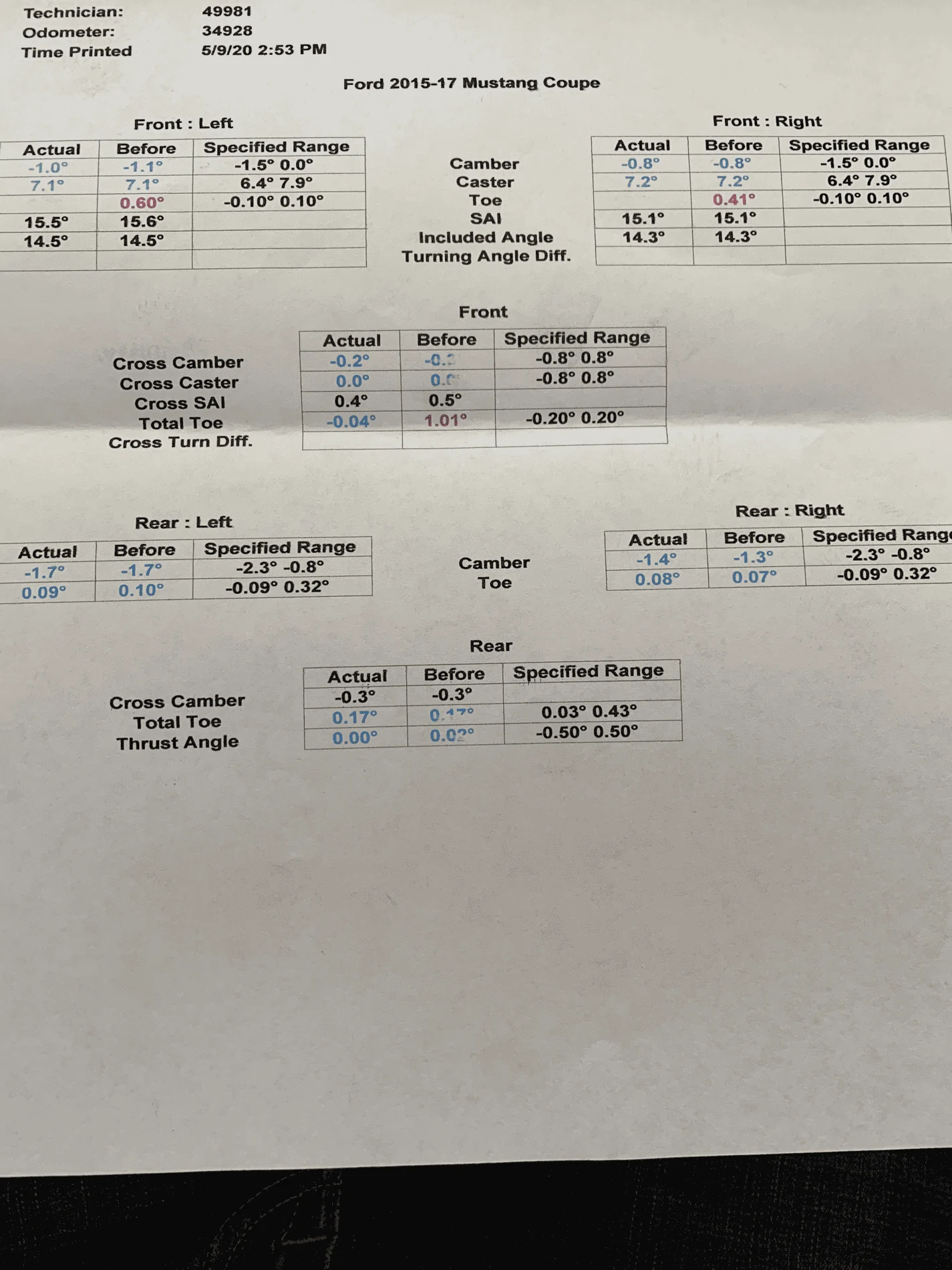

Just had an alignment done. rear toe was out of spec, but did not fix issue. Alignment tech could also feel it even at just 30-40mph. It's really bad at 80+. I have new Pilot Sport AS3+ tires and the pressures are all good. 2017 about 35K miles.
I'm going to schedule a dealer appt but they always blow me off. What could this be?
