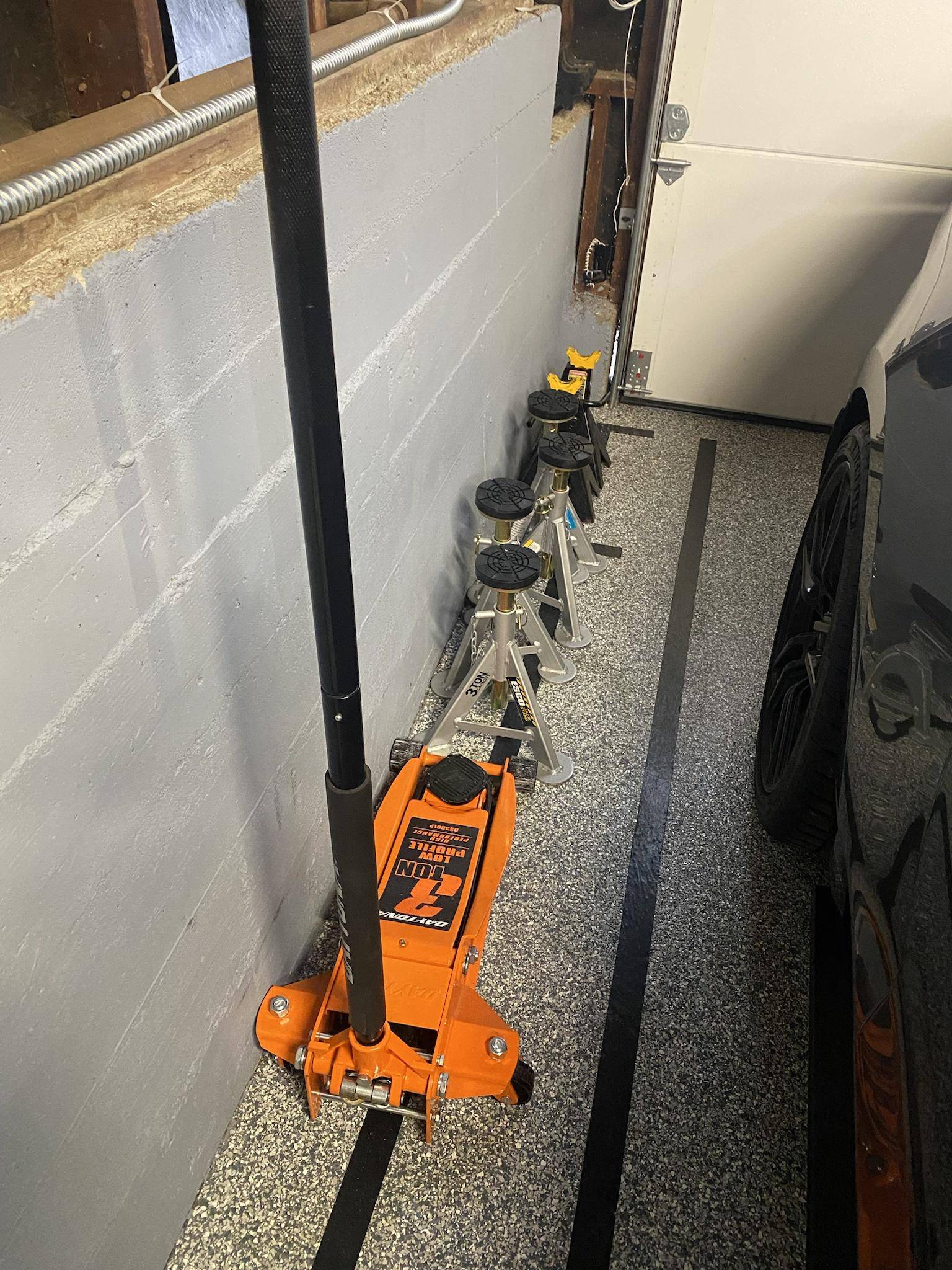

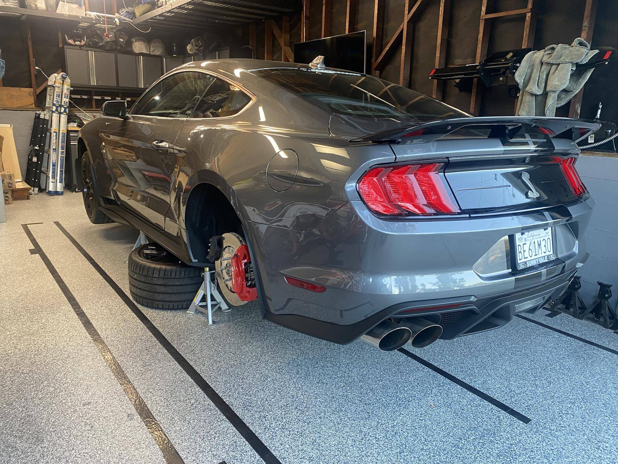

Happy to see QJ owners that like them, but I tried them out and could not see the benefit over 4 good jackstands and a low profile floor jack. I ended up returning the QJ (thank you Costco return policy).
They are heavy AF and take up floor space. Yeah you can just leave them under the car and drive over but it's not ideal. The wall hook storage is pretty funny, I'm not exactly a small guy and the idea of lifting those overhead to hang on a wall hook every time you want to use them is just asking for a back injury. They are not light.
I could never get them to consistently lift both sides, even after multiple rounds of bleeding them. And there's the basic design of the QJ locking mechanism; I'm skeptical about crawling under a 4200lb car with a small piece of spot-welded steel to keep the ramps locked in position. The one small bolt that holds the locking arm to the ramp is also something I didn't like. My first attempt at lifting the 500 was scary at best, the ramps shifted and lifted the car unevenly. Every time you use them is a constant back and forth on each side to see that they are lined up *just* right on the pinch welds. I tried both the pinch weld blocks and normal blocks on jacking rails, it's still a PITA to get lined up perfectly parallel on both sides.
Contrast to this, which is 100% solid and takes about 5 min to get the car up:
Anyhow, that's just my experience trying to give the Quickjack an honest try. I found they were not what I was looking for. As of now I've got a Bendpak hd-7w on order, and one of their (too expensive) low profile bridge jacks as a compromise for wheel/suspension work.

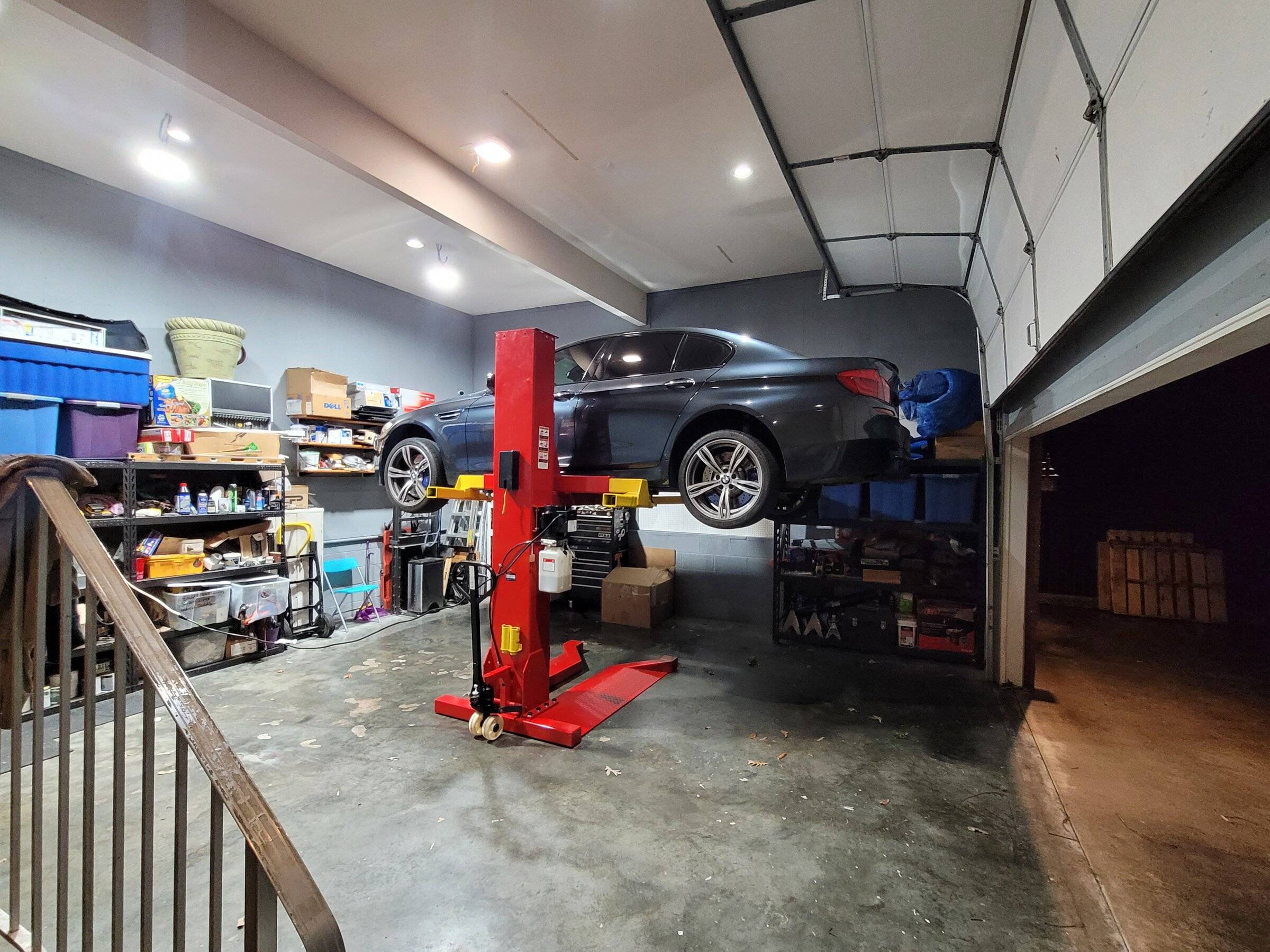

I'm sorry to say, but by your accounts you played yourself
Just offering my experience with this particular tool. I found that, for my needs, it was lacking at best, for the reasons I stated. I get it, you like your Quickjack, it works for you, thats great!
For me, I found it heavy, took up too much space when not in use, clumsy to setup, frustrating to bleed 3-4 times (all following the steps carefully as spelled out in the setup manual) and still have it lift unevenly, and once the car was up, kind of sketch to crawl under with a heavy ass GT500 overhead and have to rely on some spot welds and 2 bolts. Then there's the ongoing maintenance checks: does it have enough air, are any of the hoses/seals leaking, is it topped up with fluid, does it need to be bled again.
It's the internet, YMMV with any of this stuff. Anyone that uses one happily thats great for them.
This setup does the same thing and (for me) is easier to use:

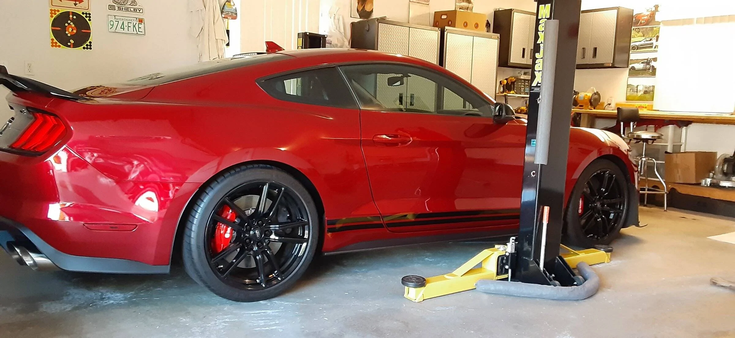

I looked at the Quick Jack but decided I wanted something that would lift the car a little higher. I did not want a permanently installed lift, so I went with this.
oh wow, details please! That thing looks rad. How stable is it without being bolted down?
It's extremely stable, is rated at 6000 pounds, and I keep it against the wall with the base sticking out so that I have to drive over the base with one tire when I park in the garage. I use two underhoist jack stands on the outboard side to minimize the slight sway that I get when I am wrenching on the car. It eliminates it altogether, though it's not necessary. My wife parks her car in the garage and did not want any posts, so this was a compromise.

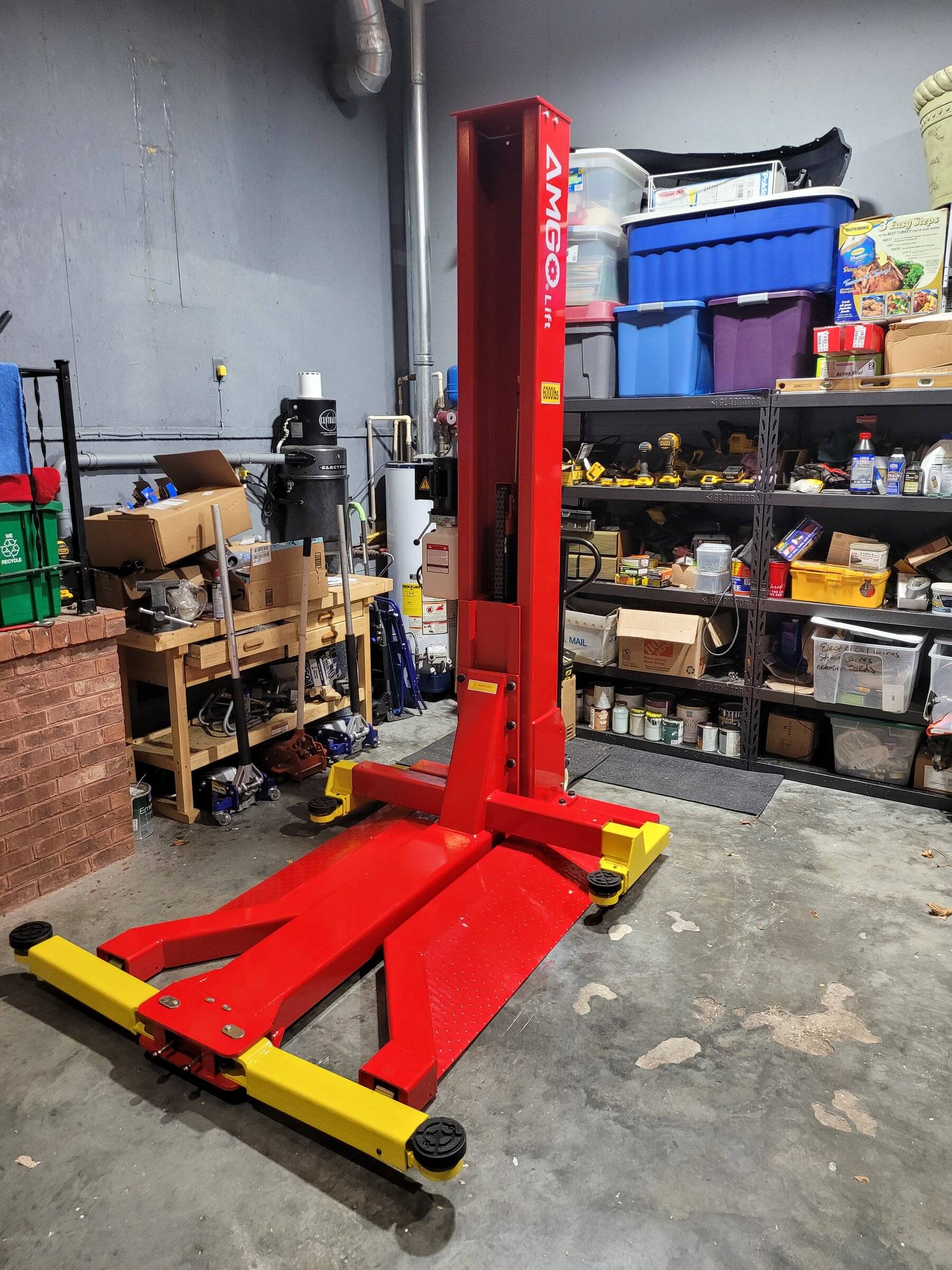

The one post is awesome. But how high does is sit off the ground? I’m not sure my car would fit over that
I'll measure the height of the pads when it's lowered all the way when I get home. I think it's about 4".
It's just under 4.5" when it's lowered all the way down.
