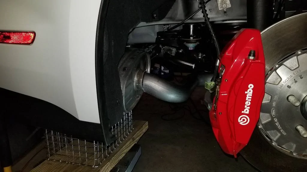

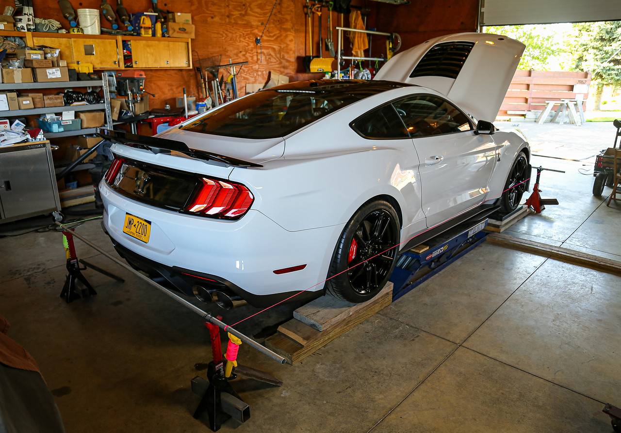

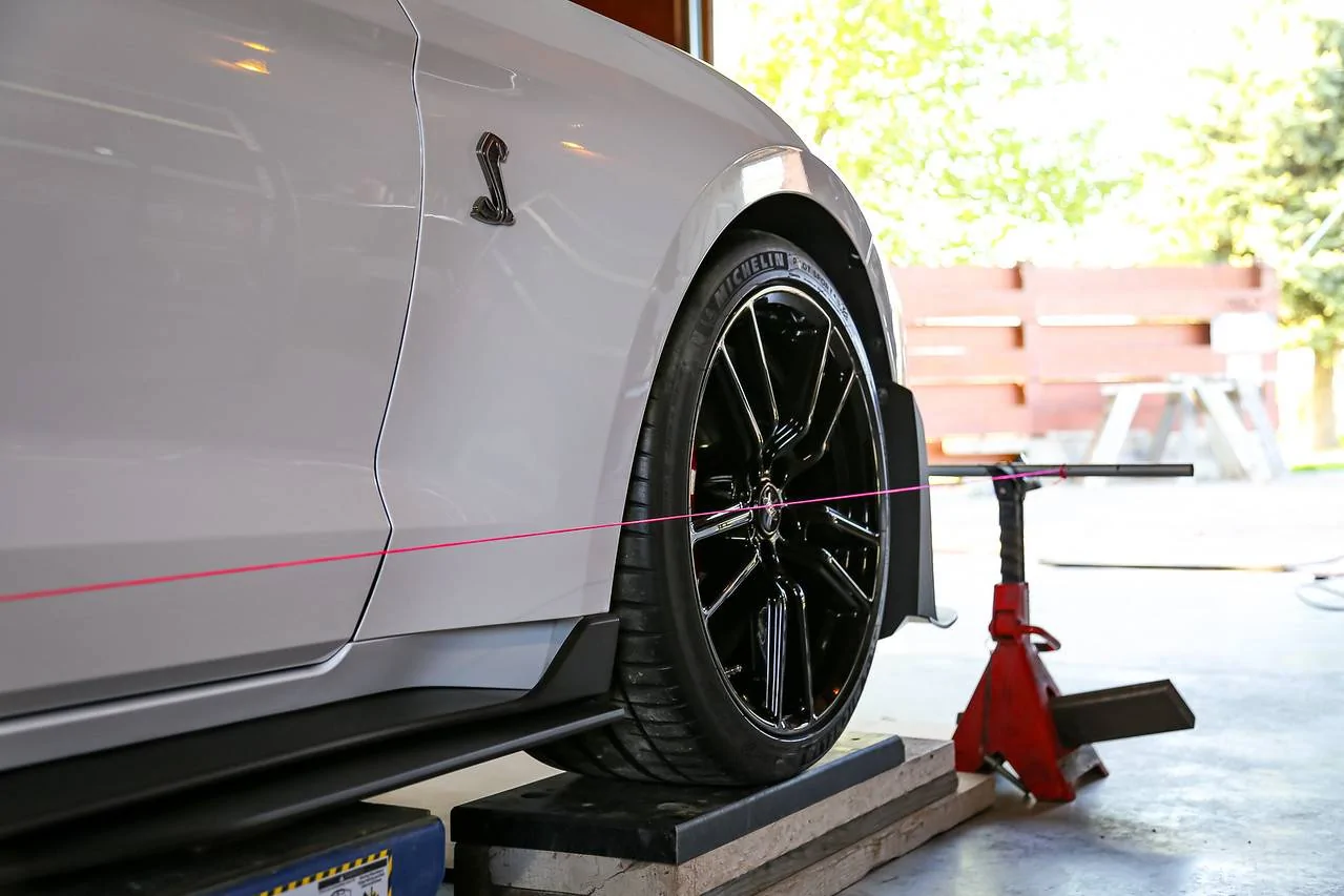

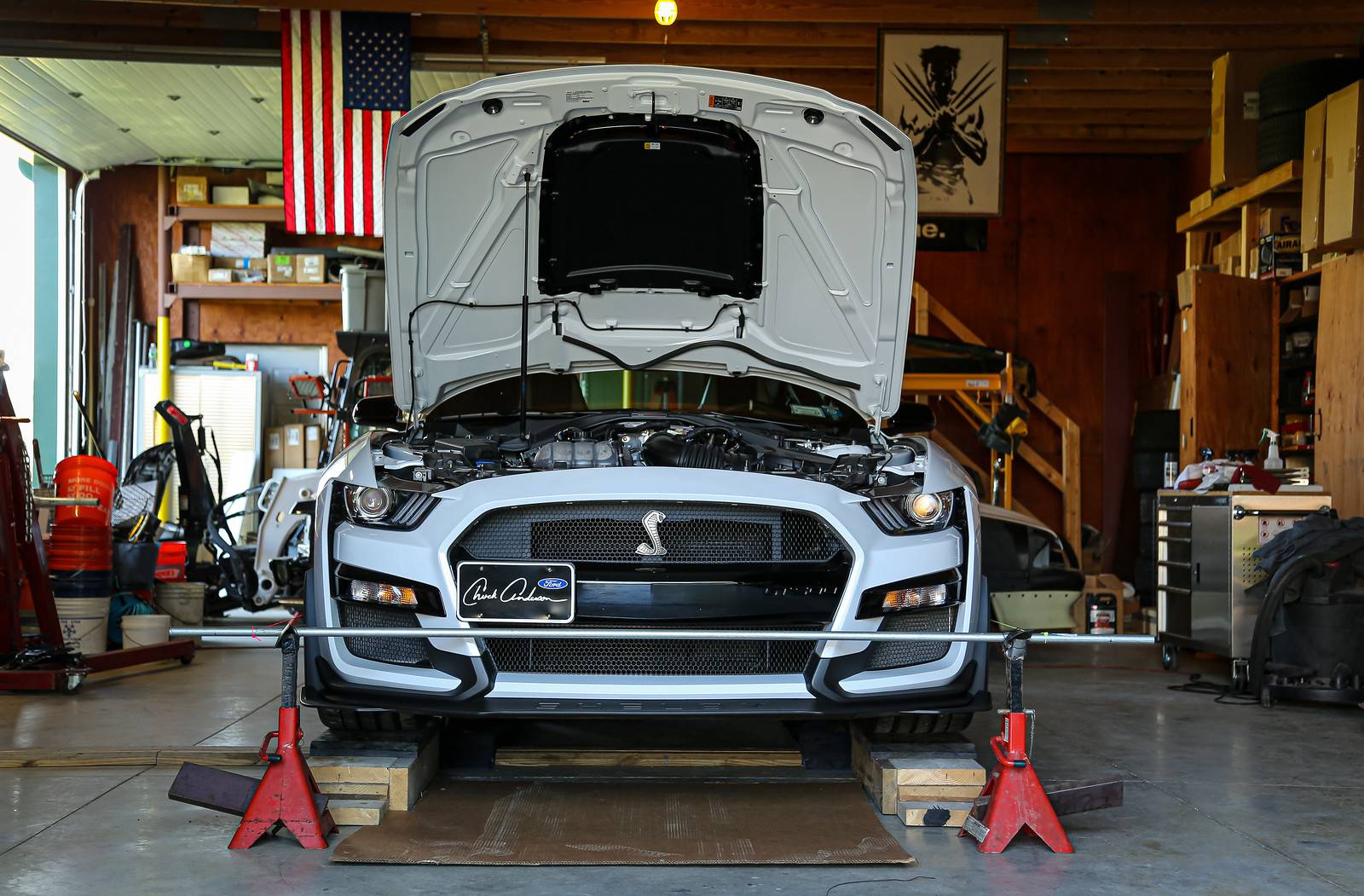

I had driven the car one time - the 1,000 mile trip home in January from Missouri to NY. Since then all I've done (when it wasn't below freezing in my unheated shop) is a few mods here and there. The sun made an appearance and motivated me to get the car ready to drive again. I wasn't interested in driving the car until I knew it was aligned properly after the CFTP spring install. So yesterday I strung the car for toe and made a camber adjustment. I made a quick video just before I put everything away as the sun was going to start its downward arc soon and I wanted to get the hell on the road.
To recap, I ended up with:
Front - 1/16" toe in, -1.25* camber
Rear - 1/8" toe in, -1.75* camber

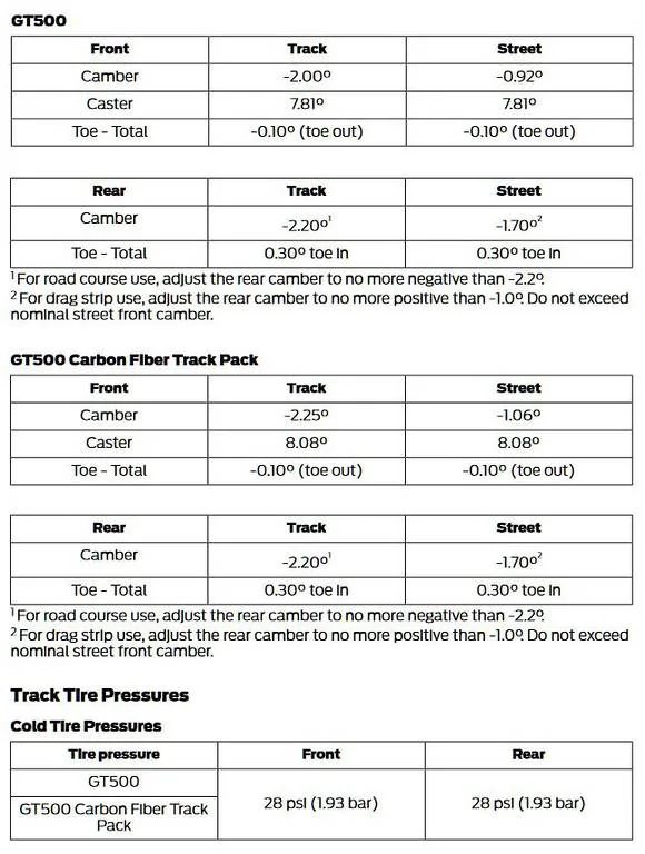

Specs from the 2020 GT500 Supplemental Manual
